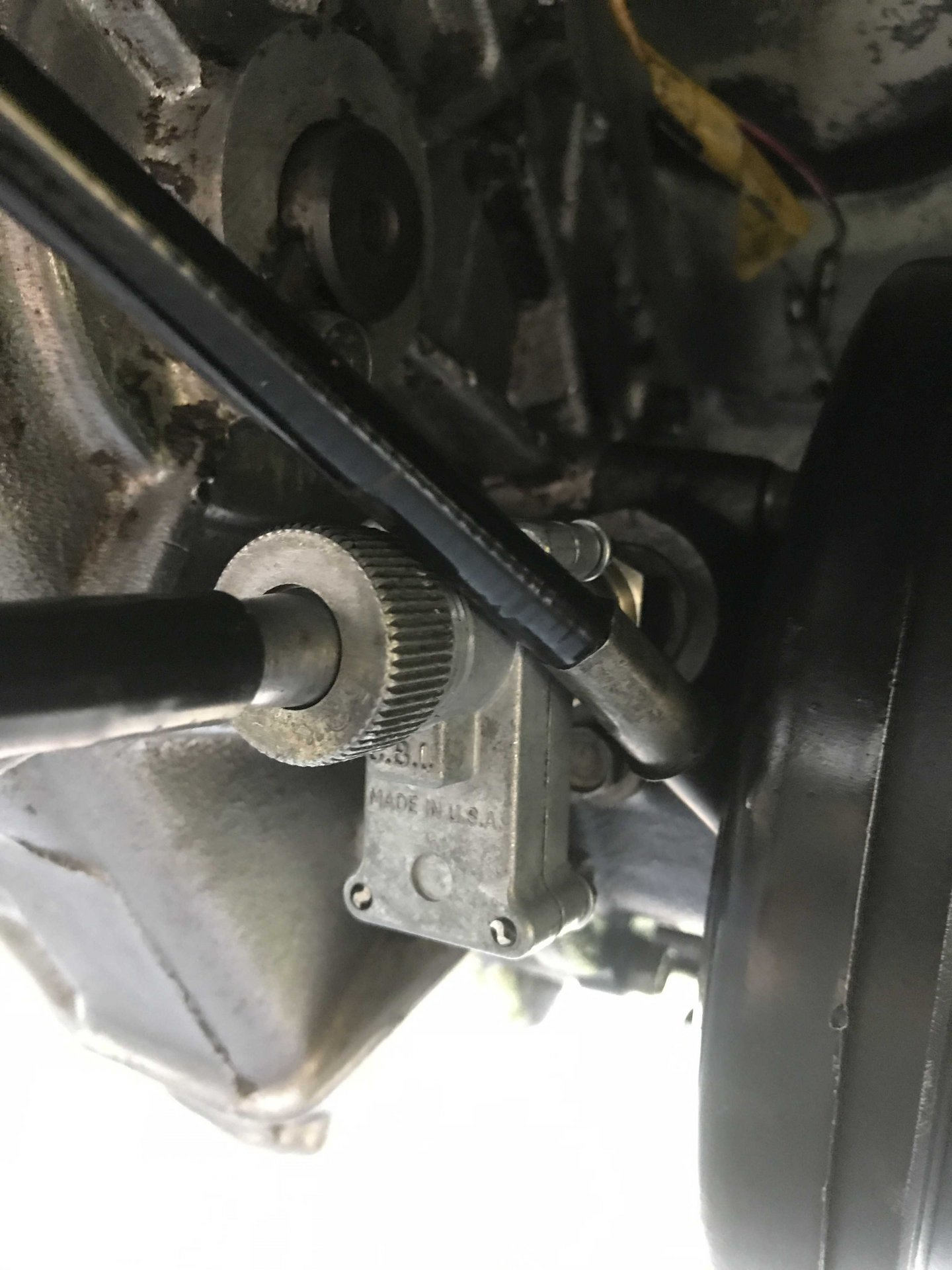

For my FJ40, I installed the below Commercial Speedometer correction unit in 2017, and it still going strong...albeit it is installed on a fresh January 2025 @orangefj45 Valley Hybrid T/T-Case rebuild now. :)

Well there you go, if it's good enough for GA Architect it's certainly good enough for me. Now I'm wonder if the same unit will work on a split case?
Thanks for the confirmation that these are the guys to go to @GA Architect !
Well there you go, if it's good enough for GA Architect it's certainly good enough for me. Wonder if the same unit will work on a split case?
Yes the threads on the split case are identical.
