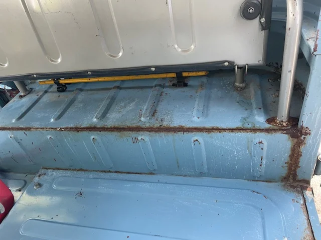

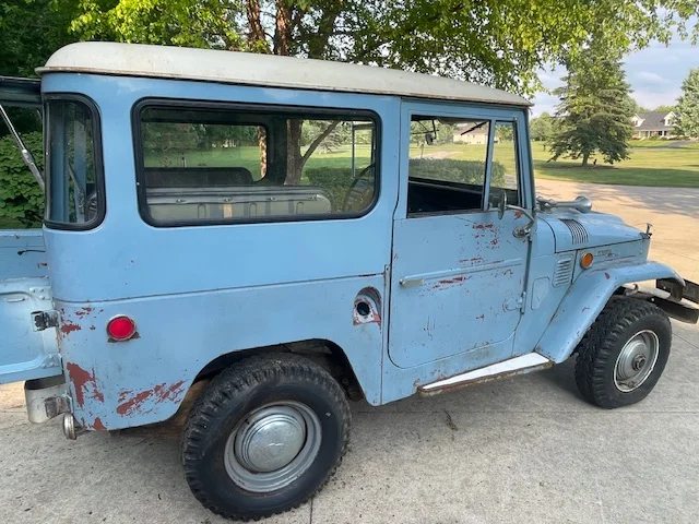

On the outside I was just going to clear coat it and keep it as it is. Not sure what to do on the inside I was thinking to POR-15 in clear to seal it or I can completely repaint it. What do you think?
Clear coating, or just putting paint over rust is not really "body work" as you aren't really doing anything to fix it.
Either fix it for structural or aesthetic reasons (cut out all rust, weld in new and properly refinish)
Or

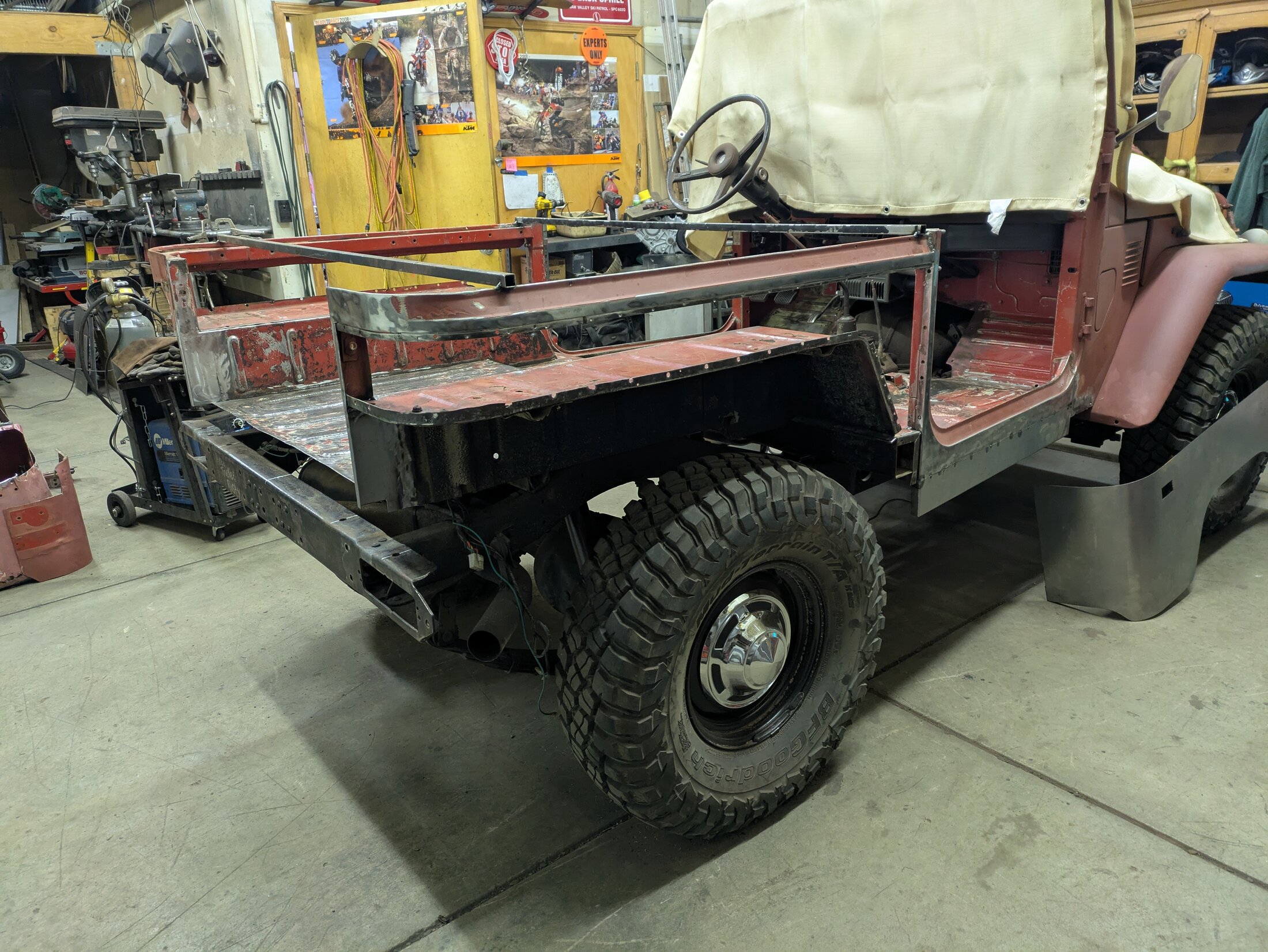

I recently completed a rear sill replacement on an FJ40 model similar to yours, which had comparable issues and goals. I’ll attach the link below for reference.

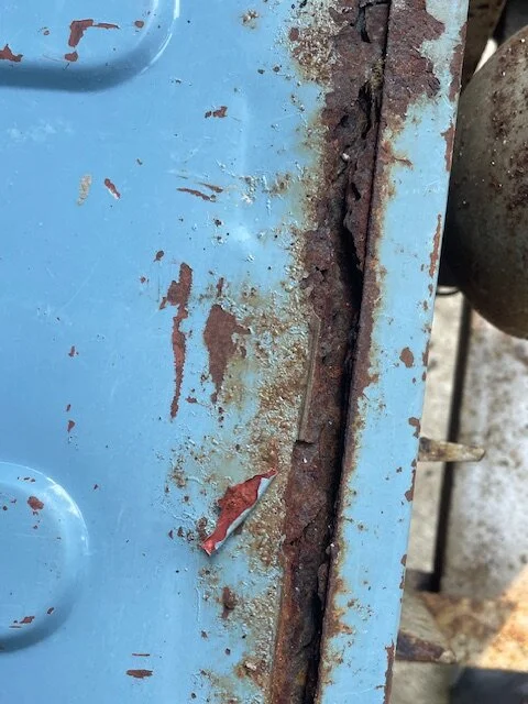

I appreciate the appeal of patina; it has a unique, aged look that many find attractive. However, the downside of patina is that there’s no effective way to completely stop rust from developing. While you can slow it down, the only way to truly halt it is to remove the rust and restore the metal to a clean state.
It seems that you also have some structural issues that need to be addressed. If left unaddressed, these could lead to bigger problems, such as water entering the vehicle during rain or water crossings.
I see three options for you:
1. If you're not overly concerned about the growing rust issues, you could apply a clear coat or boiled linseed oil and then leave it as is for a few years. Just keep in mind that rust will continue to grow, and you'll eventually need to do more work.
2. You could fix the structural issues and any holes and then try to match the patina. This should give you a few more years before further maintenance is needed.
3. You could strip everything back to clean metal, seal it, and paint it. This approach would allow you to avoid worrying about it for another fifty years.

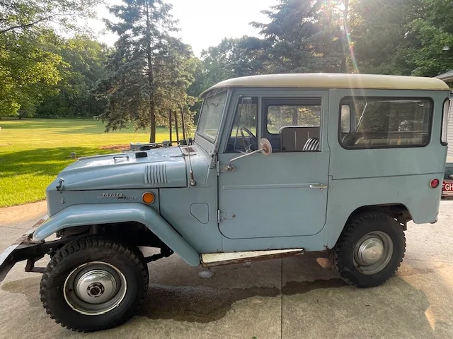

Your 40 looks like the twin to my '69. I'm starting to cut out rusted areas and replacing with new metal: rear sill, lower rear quarters and 2 small patches on outer rockers. Only way to really keep it from getting worse. I'm not planning on a full repaint, just blending in areas where there's new metal.

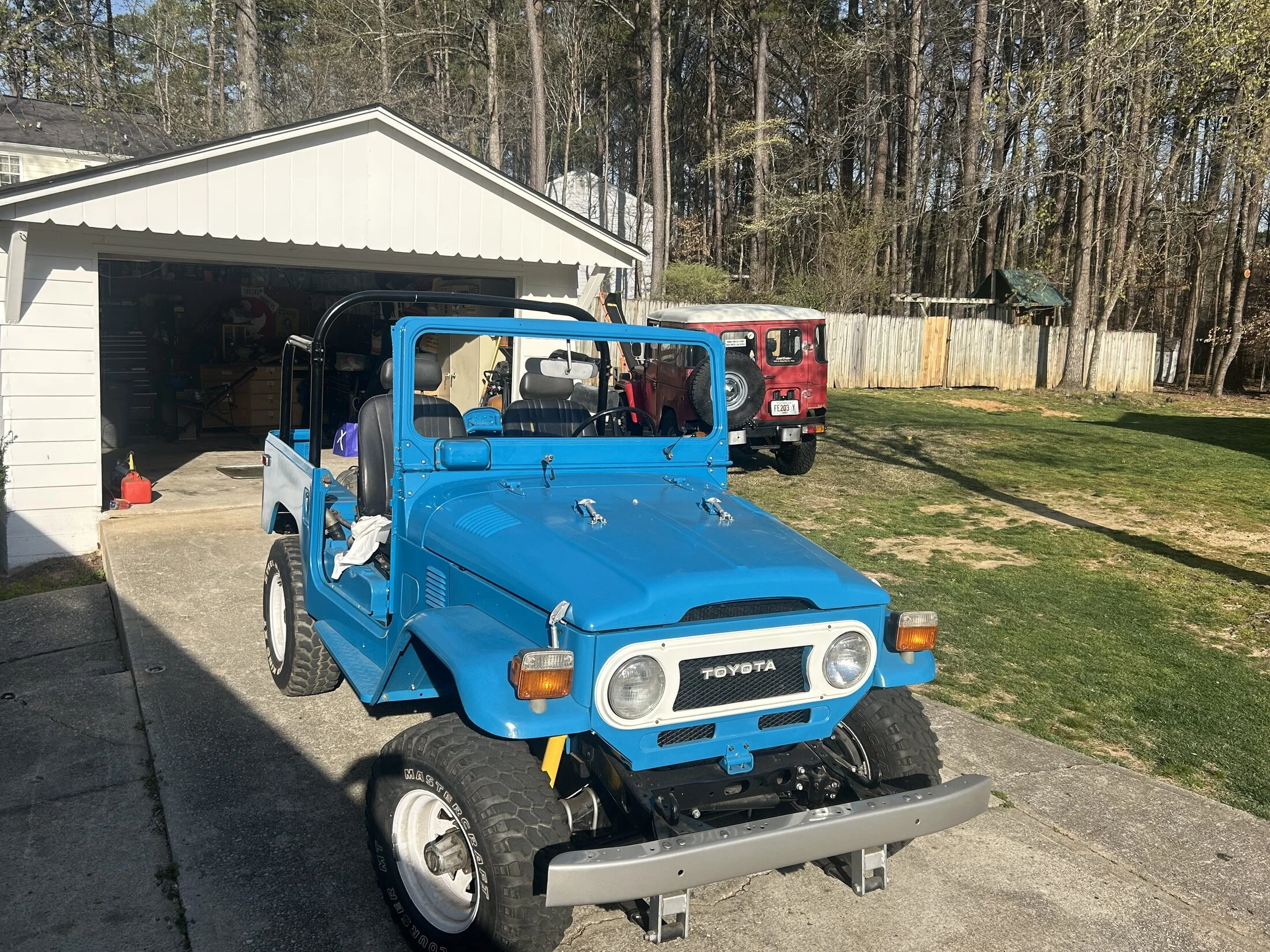

I agree, but that looks GREAT!!! ...and you will be able to sleep at night knowing you did it RIGHT!!!

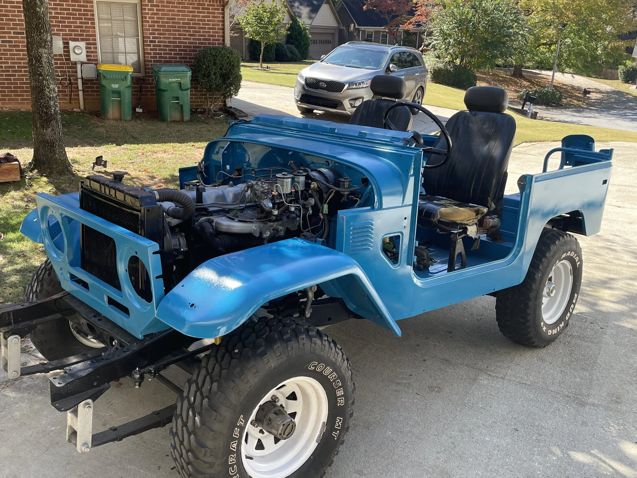

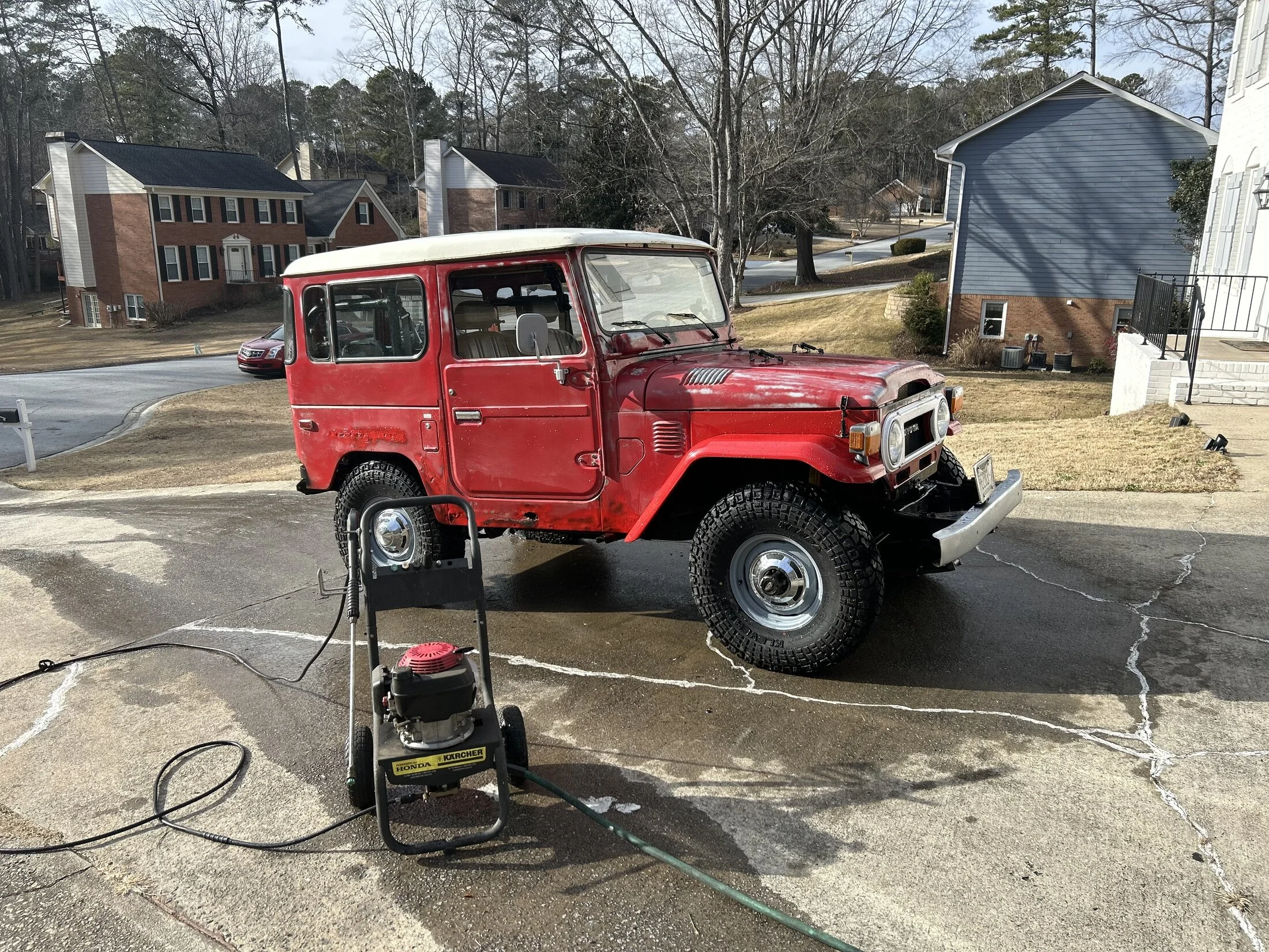

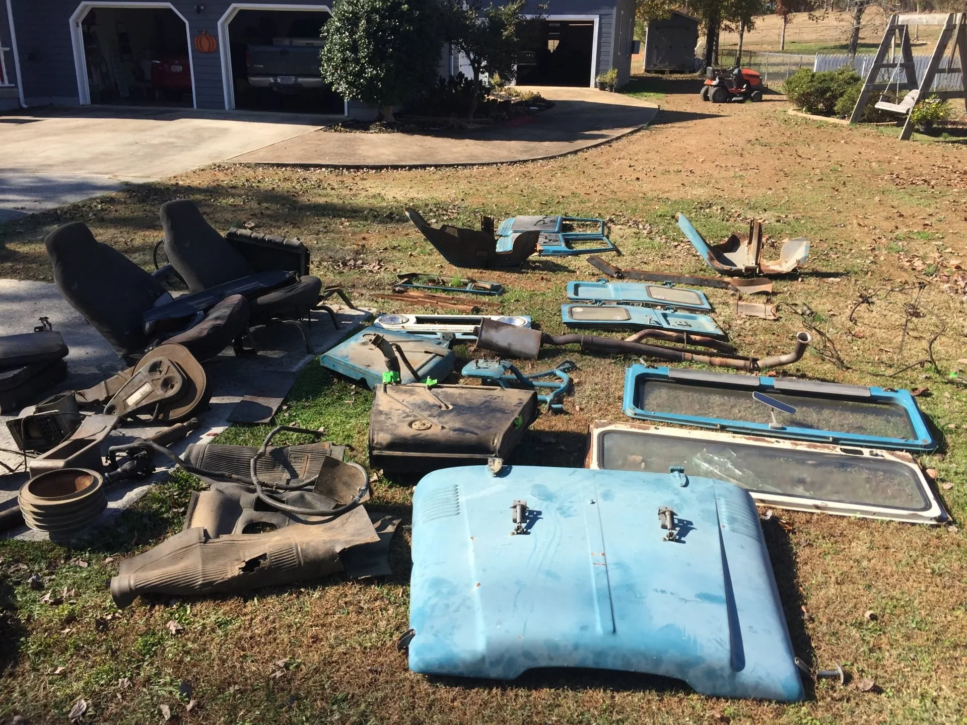

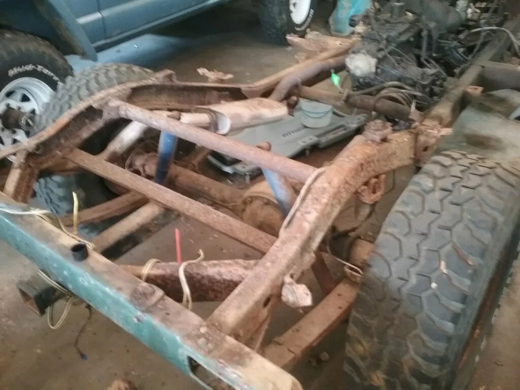

I did this on my blue 77 and am about to do the same on my red 78... although, I am not taking the red one completly off the frame like I did with the blue one.
@BSLK let us know if you need any help. Let's keep these things on the road!!!
If you're not planning on cutting rust out I would water blast, wire wheel what you can then get absolutely dry before painting/spraying fishoil on both sides of rust and over all seams. Leave a week or so then put a light coat of enamel - aerosols are fine - over the underside, that will set the fishoil. This will hold things at bay. I've had no luck with Por15 and I've used gallons - a very well marketed product.
