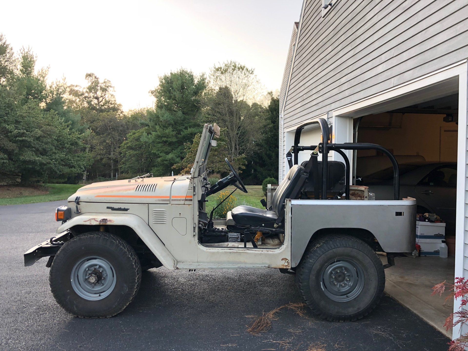

Take measurements of your side stippes ... any vinyl shop can recreate them ... unless your thinking of painting them on
Great cruiser !!!
Post up your stripes on these threads .... your not alone :)
Great cruiser !!!
Way ahead of you, I was planning on new vinyl pinstripes but painted stripes would have their advantages as well.

I did today! threw the fuel tank in her, put in the driver seat, and cruised around my yard and the backroads for a while! it was definitely pure bliss after all the hard work I put into it.

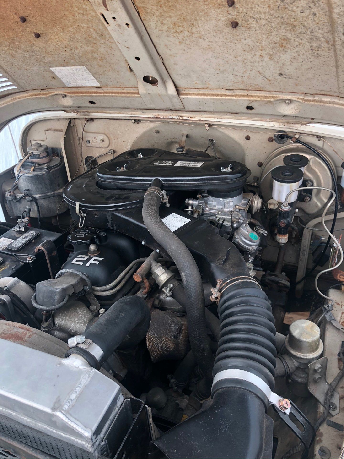

Also, a question for any experienced 40 owners, i recently replaced my aftermarket troll hole carb with the rebuilt original Aisin and it has a pretty fast idle, I've tried adjusting it but can only get the idle to increase, any suggestions to troubleshooting/tuning?
Watch this little video, it was a huge help for me to iron out my carb tuning.
First find the idle SPEED and the idle mixture screws. The idle speed one is almost impossible to see on the rear of the carb. That basically sets the stop on the throttle linkage. That‘s the one that you want to find. Also make sure that the choke is not engaged.
