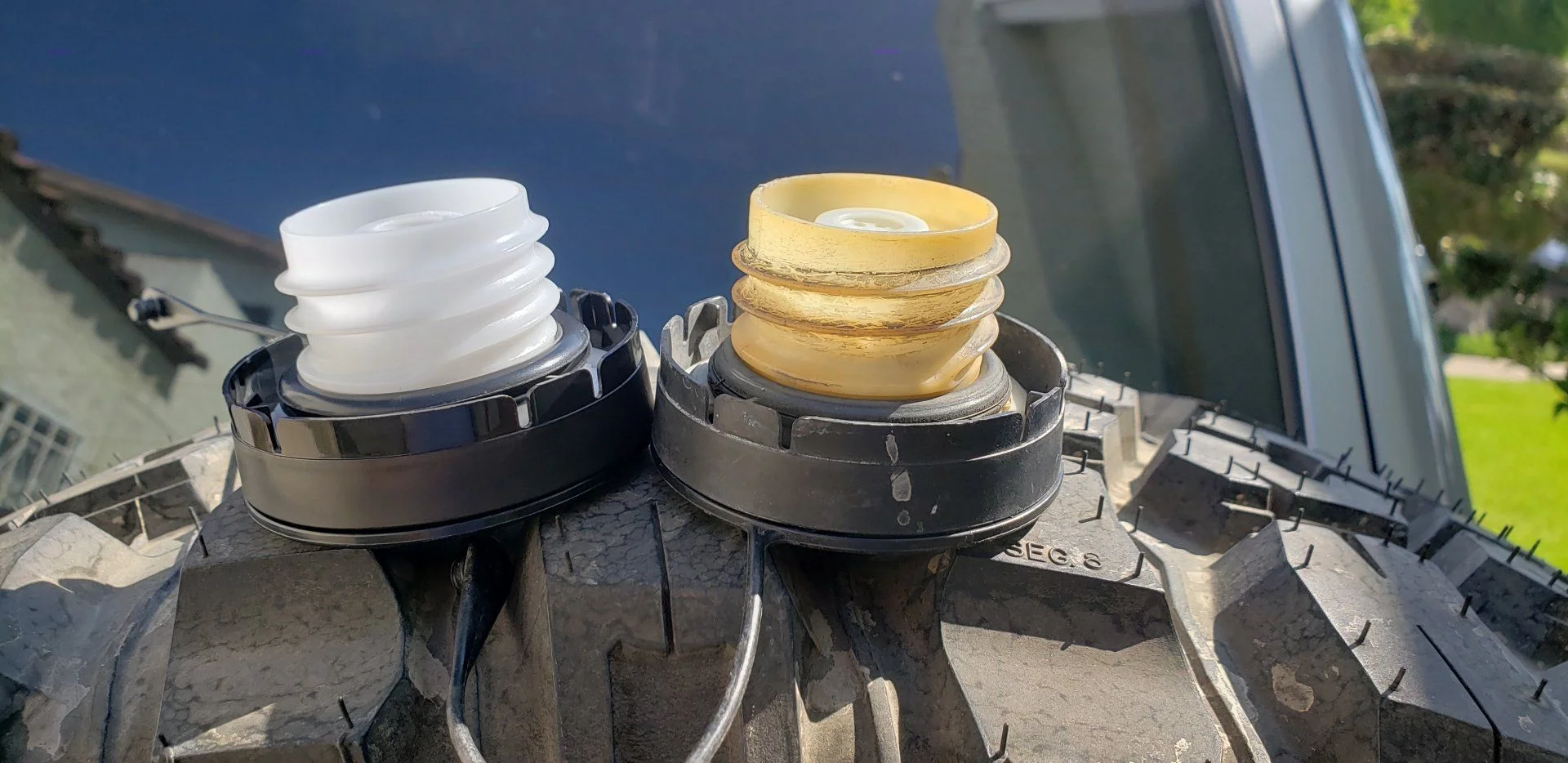

Over time I’ve replaced all the vacuum lines, the gas cap, and the purge valve on the manifold (25860-50100) but the light keep coming back. Not immediately but eventually.
I replaced VSV (90910-12268) on top of the charcoal canister on Thursday. Left for a road trip the next day and put it through conditions that had been triggering it. Prolonged high temps, idling in a parking lot for extended periods to keep the pets cool. So far so good #fingerscrossed

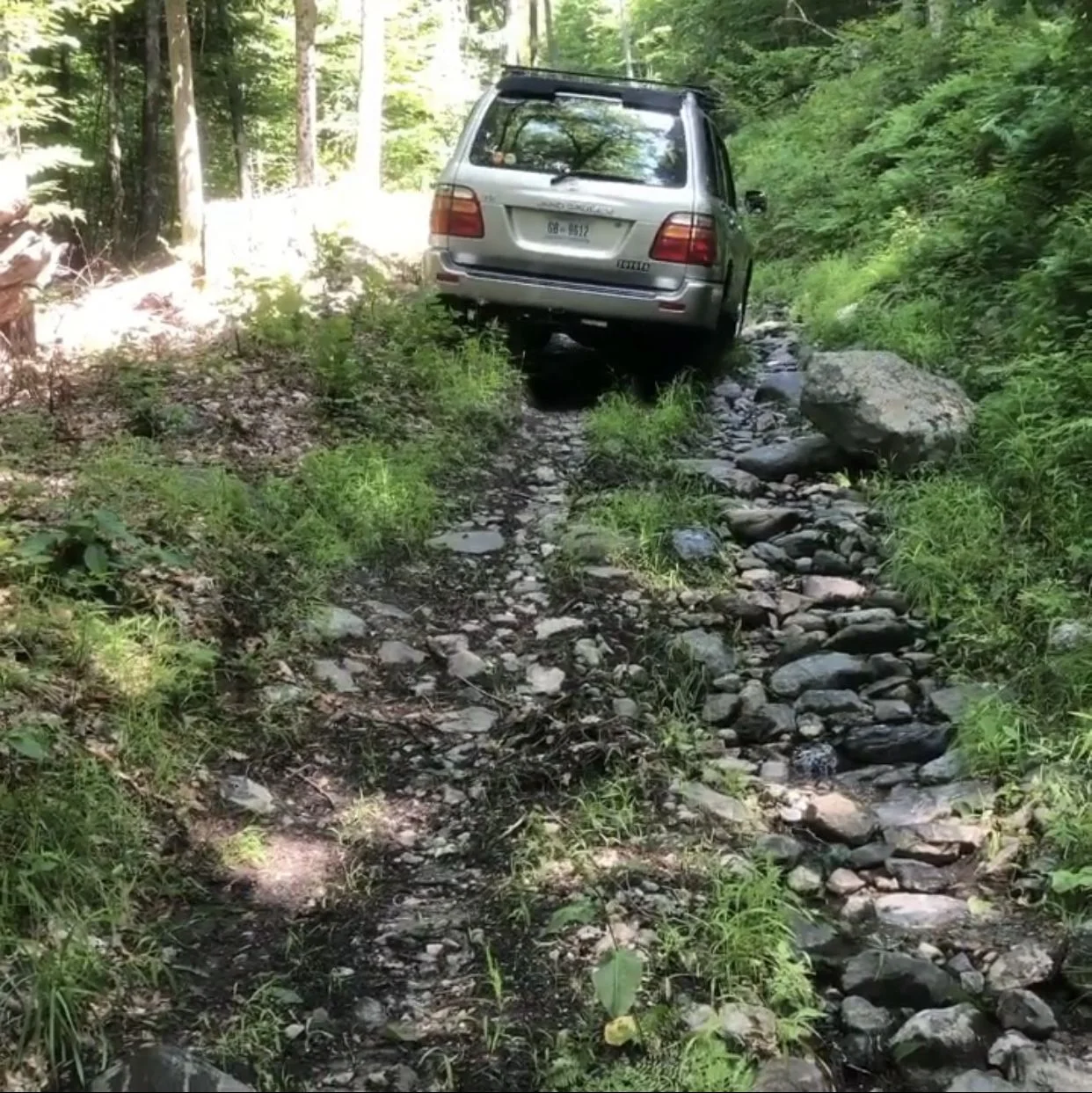

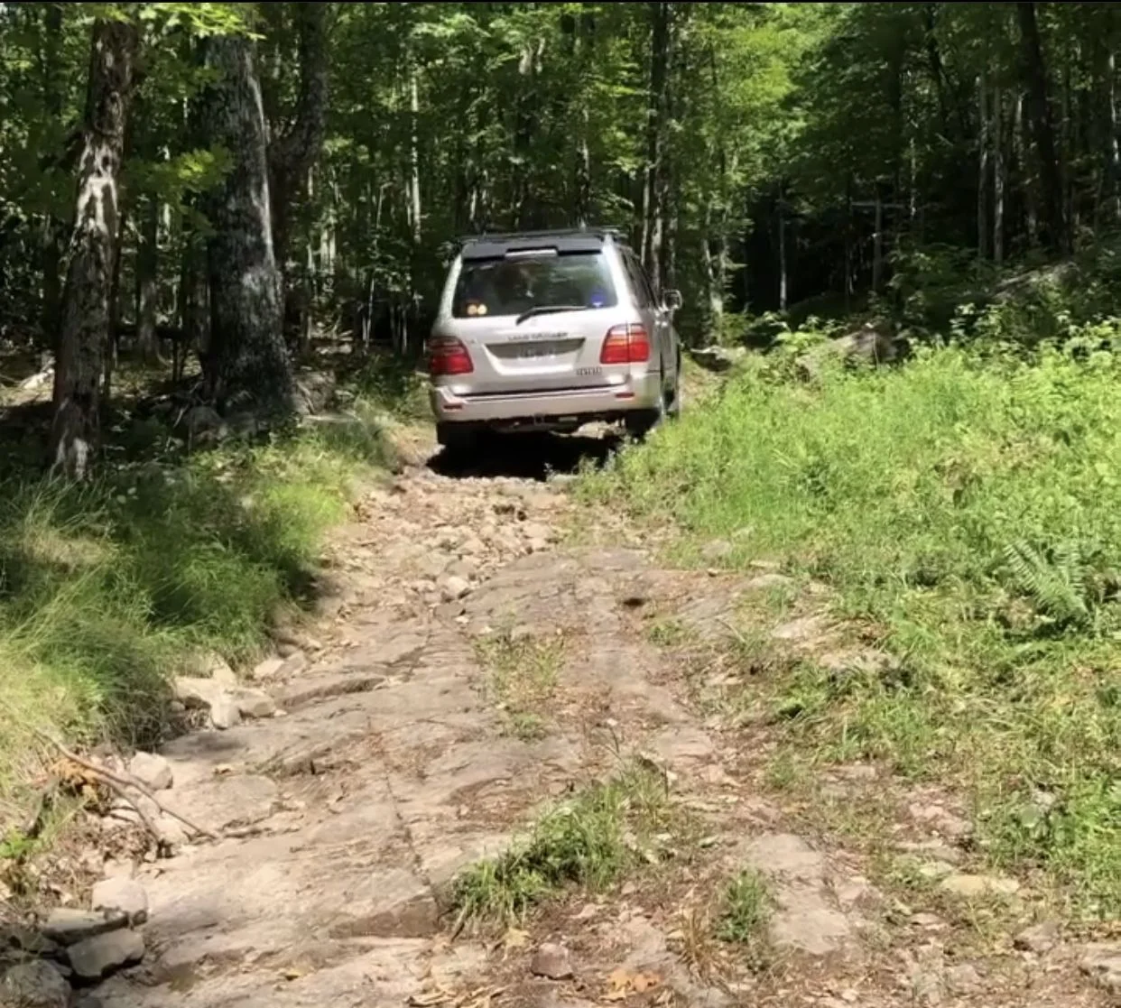

Also, I don’t live and haven’t traveled to high altitude with the truck (yet) but we have traversed a mountain road 5 times with near empty and near full tanks since Thursday. It’s 5 miles with a quick up and down in the Adirondacks. It will make your ears pop a few times. That had set off the CEL once before.
I’ve only had a bit of tank pressure and no fuel smell except for a little bit when first opening the cap. After changing the last item and running through 3 tanks there seemed to be almost zero pressure. It was significantly cooler out though.

I was surprised an hour long trail that I did recently didn’t set off the CEL. Nothing too extreme but definitely lots of fuel slosh. This was before replacing the purge vent and VSV. Temperature was around 90.

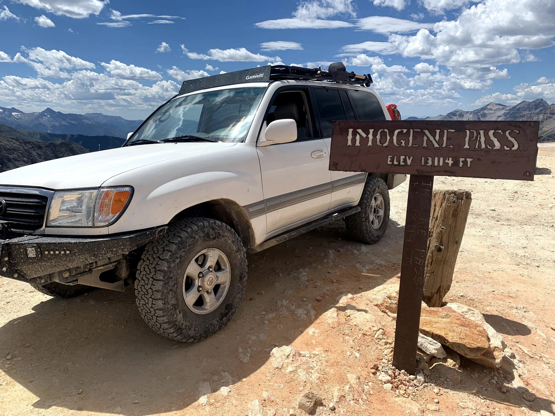

UPDATE: Today we ran Mineral Creek (slow rocky uphill that seemed a lot rougher that last year, lots of spotting) to Engineer Pass (12,800ft) then later to California Pass (12,960ft) all with normal ethanol gas. Zero issues. Engine temp never got above 190. I kept the engine on at all passes. Zero gas smell. Night and day difference from last year! Last year in colder weather I had boiling fuel on half dollar which is nothing. Tomorrow is Ophir and Imogene and I’ll keep everyone posted. At this point I’m not even going to try non ethanol fuel.
UPDATE 2: Back from the mountains... The next day we ran Ophir and Imogene. Zero issues on Ophir (ECT was 190 or under) and when we got to Imogene I kept it in 4H a little too long and in the climb up I got to 199 for a few moments. Engine was just working too hard in the thin air. Put it in 4L and in 2 or 3rd gear and let the gears do the work on that climb. I quickly went down before 190. Zero gas smell, zero boiling, nothing. Even with normal 91 Ethanol gas! I never used non-ethanol gas. I can't tell you how nice it is to finish that climb and be sitting at the pass (13,111ft) and have not even a smell of gas. The entire trip I had no issues! Last year in colder weather I was leaking gas out of my fuel door and had fuel smell all 3 days of trails. I brought all the EVAP system parts ( both VCVs, hoses and CC) and didn't touch them.
My average ECT on all the trails was 188. I don't have any data on the pavement because I towed it out and back.

@gungriffin, @bassguyry, and I did Black Bear and Imogene over the weekend. All our ECTs were pretty much the same. 180-190s most of the time and then up to 200F on the final climb of Imogene. Ry and I topped up our fuel immediately before doing Imogene and he had it boil over and come spewing out once we crossed about 13k feet leaving puddles on the ground. Mine didn't boil at all. Gungriffin didn't fuel up at the start because he has the 40gal LRA tank and was already sitting fat and happy. I put my hand on his tank and then on my own and I would estimate his tank was maybe 5-10 degrees cooler to the touch than my own fuel tank. My fuel temperature gauge read 113F at the top. I didn't dare go near Ry's truck but judging by the geyser it had to have been HOT.
Also, @suprarx7nut, for the first time in my ownership of this vehicle and after having refurbished most of my EVAP system, I finally have pressure in my tank! Several times over the weekend I was able to release a hiss out of my cap which I had never been able to do before. Not only that but as soon as the pressure is released you can hear the fuel start to boil up!
I did notice a steady stream of vapors bypassing the cap coming through the plastic ring on my filler neck.
In conclusion, I'm stoked and it looks like my problem with boiling is basically fixed. Just one last leak to figure out at the filler neck. The LRA 40 gallon tank by itself likely mitigates this issues by virtue of being a huge aluminum heatsink exposed to the air and also holding more fuel to begin with increasing the thermal mass. Adding it to my wishlist.
