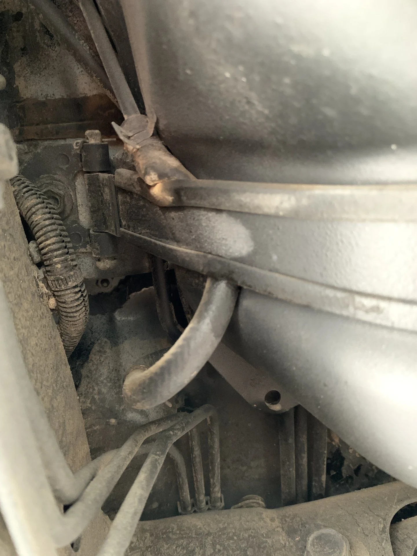

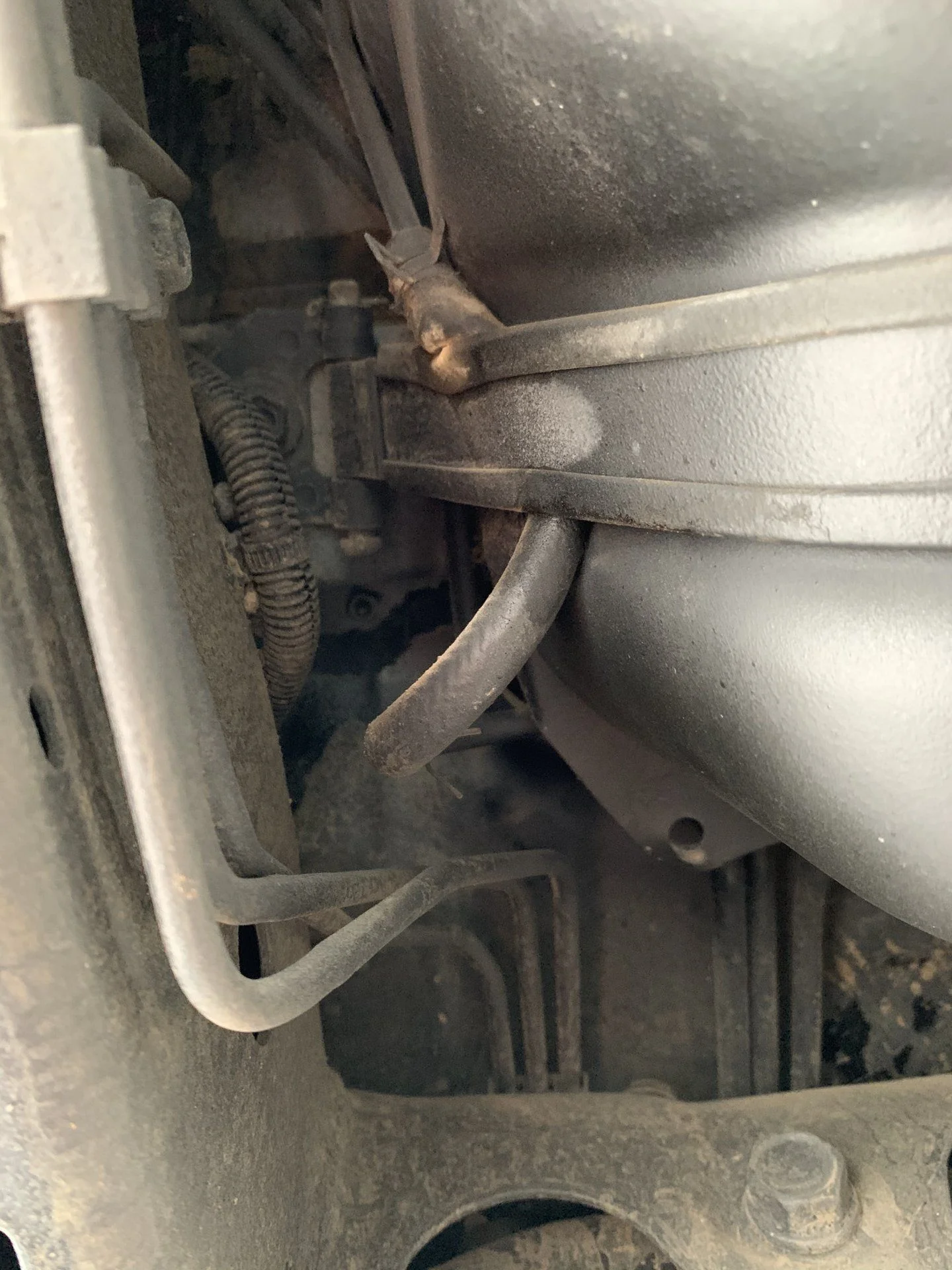

Wow one more dangerous thing I found under the truck today while crawling around... when I had the tank replaced it seems they pinched one of my fuel lines. Dangerous for sure and very audible hiss coming from the line.. I can’t believe I’ve been driving like this for 8 months. Another thing to replace.

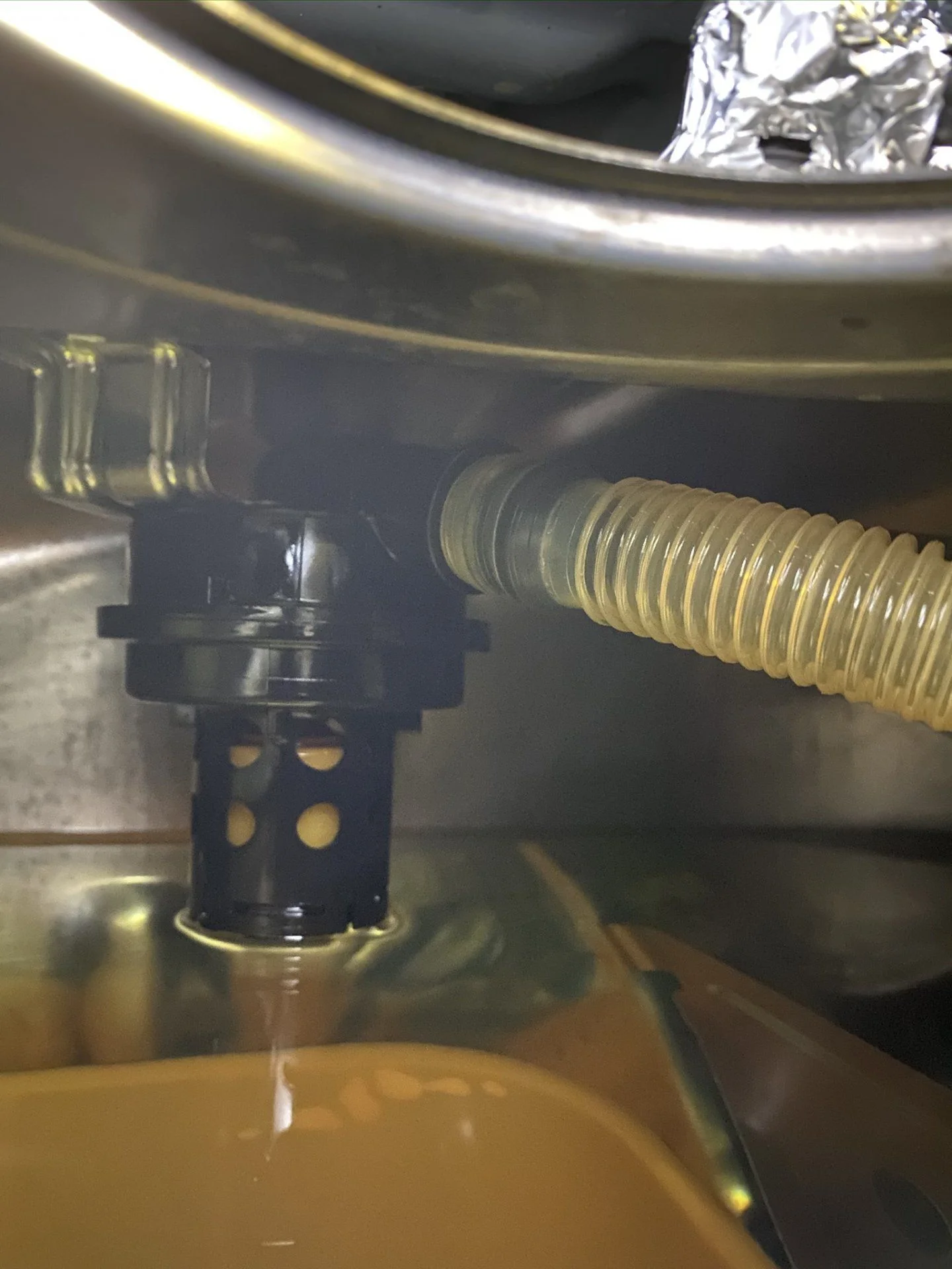

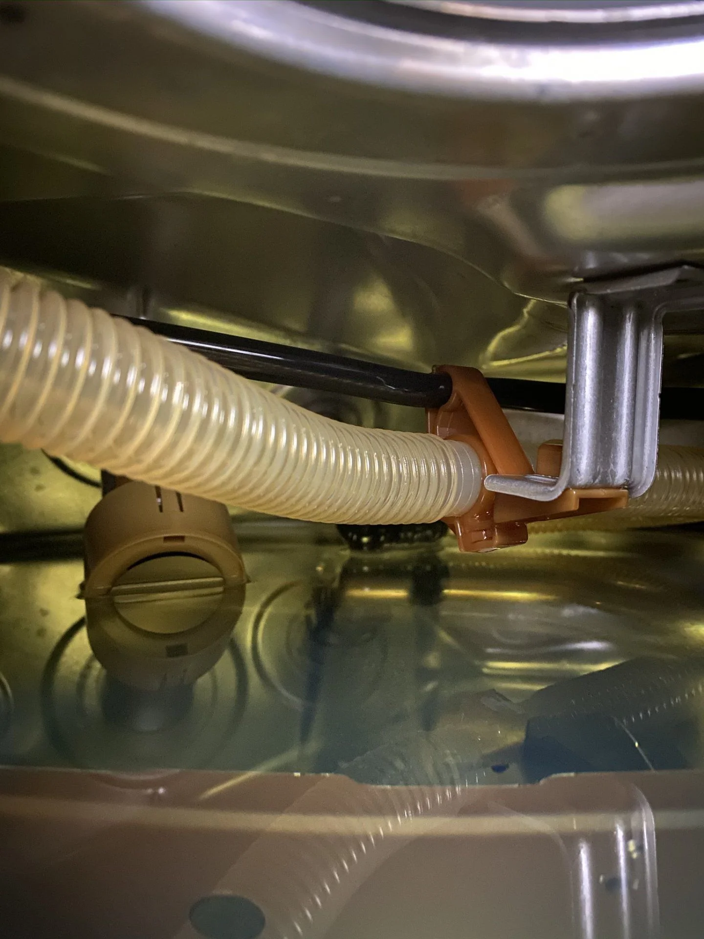

Here's pictures of your fuel tanks' valves Dan.

Paul- Look how clean all the fittings/brackets/components are at the top of your tank- I don't think the valve has build up or sticking based on what I see there.

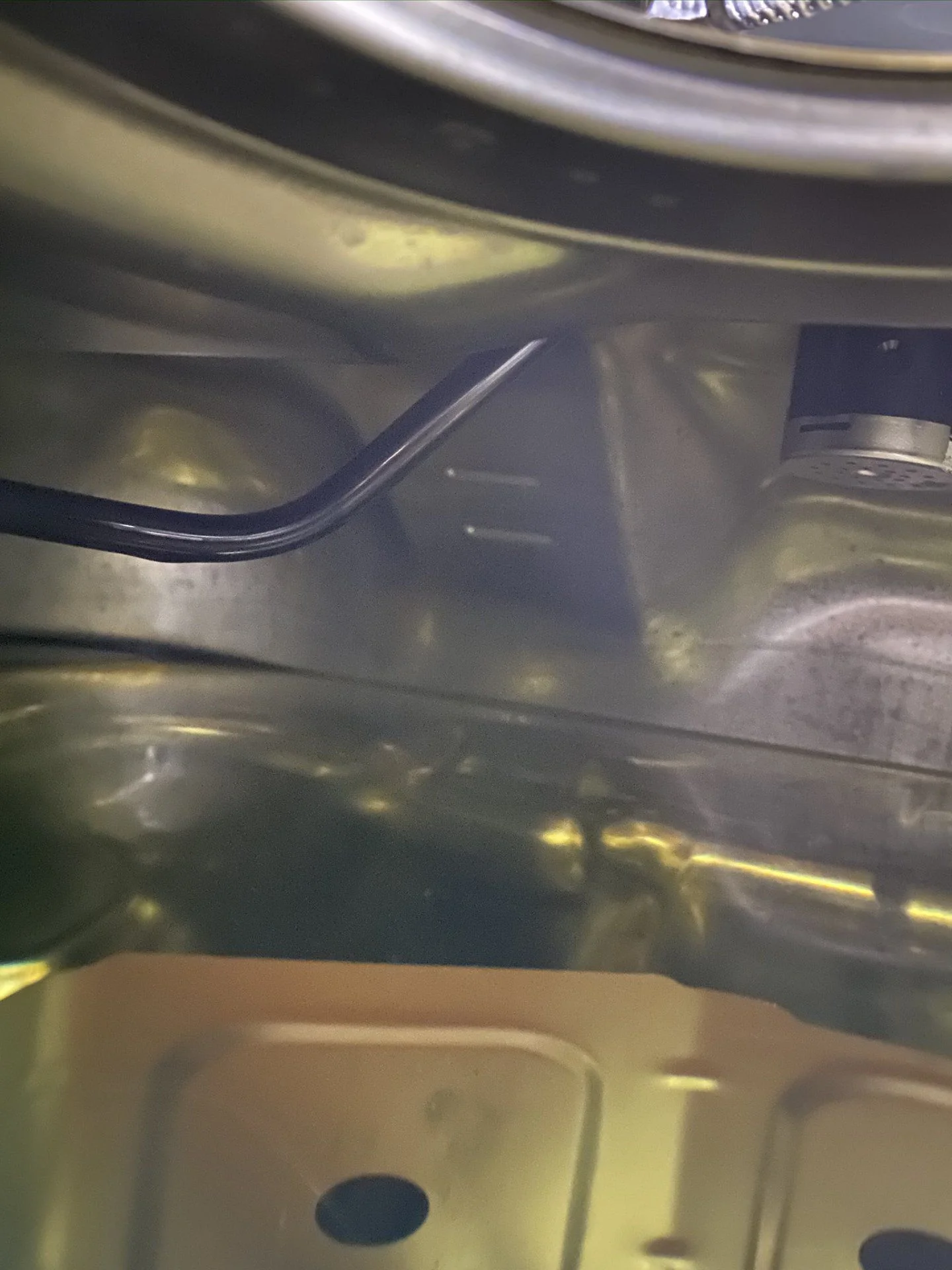

Yeah I saw that first picture of a valve look fairly clean. I took pictures in the blind, and viewed later zooming in on picture (s) on my PC. I can't see very clearly, as isn't great res picture.
I suppose it would be self cleaning, as fuel enters and slushes around. But can't say it looks as clean as new, and seems to have a little residue on it. Nor would I expect gunk like seem on fuel door with dust attached to it. I now wished I'd pushed in up, too see if it stuck. I think that one is on fill tube, and a 3rd connected via hard line.
The second valve pictures above, seems to be separate from frist & 3rd. There is a 3rd valve or sensor. It appears connected via a hard tube to the first (shut off valve) fill tube
I've looked at parts diagram for this 2007. I do not see the first valve pictured above, as being sold separate from fuel tank. But it looks like a rollover shut off valve.
Here's the another (3rd) sensor, valve or breather of some sort in the tank the 07.

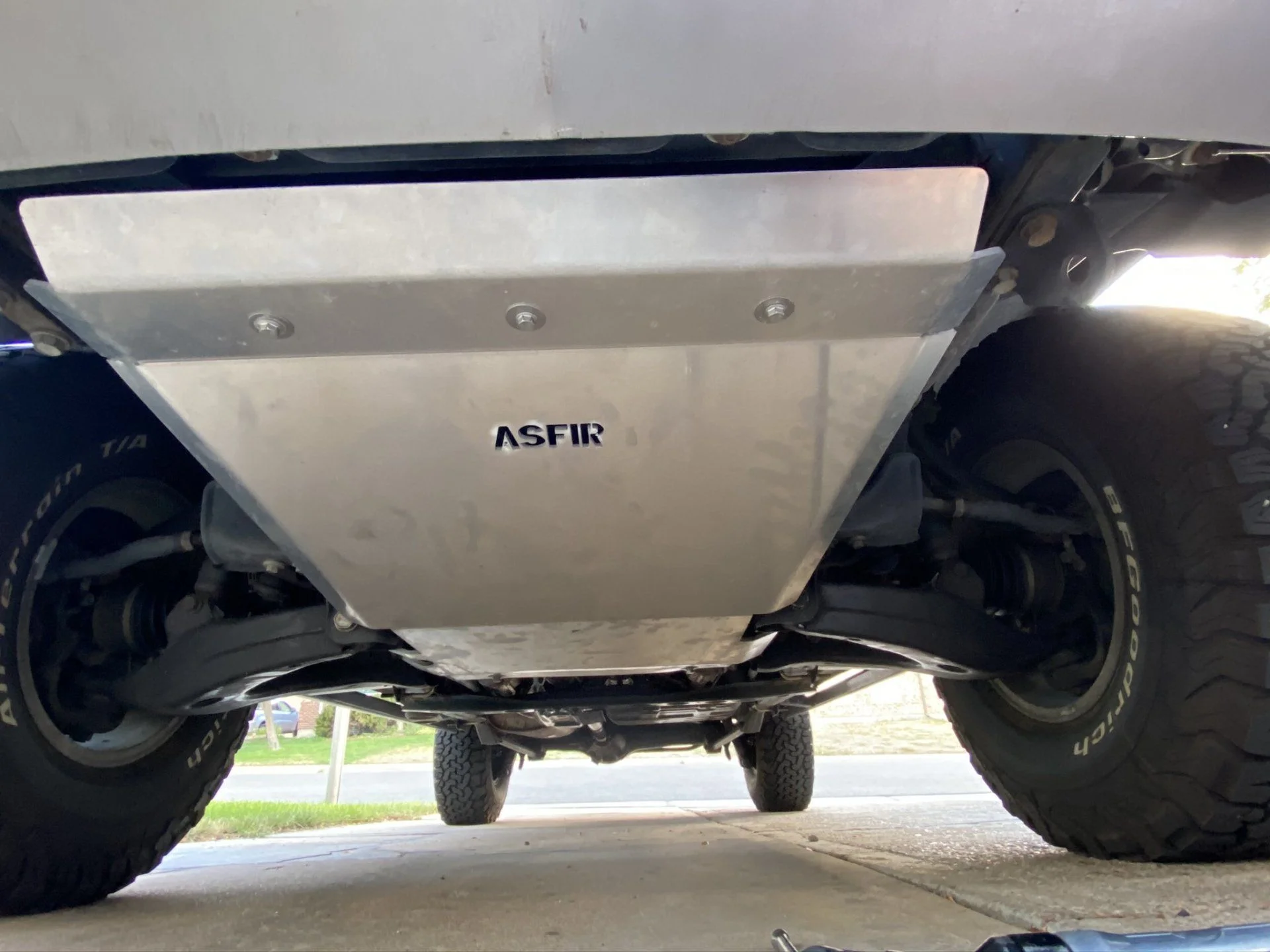

3) That Belly Pans apparently trap heat from CAT. I've some logs before and after a belly pan & skids install. They clearly show a rise in ECT after belly pan and full skids installed.
Additionally as Dan has stated, and as pictures I posted shows. His wire housing, is damage by what looks like heat damage. Only in area or tunnel created by belly pan near the CAT.
4) Placing heat shield(s) between CATs and fuel lines is reducing if not eliminating fuel boiling issue.

Aluminum #1 skid extends extra ~12" to No.3 crossmember, with less air catching & venting ability. But very cool looking ;) :hmm:
