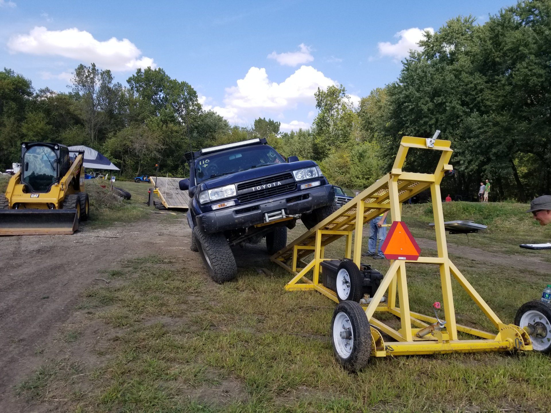

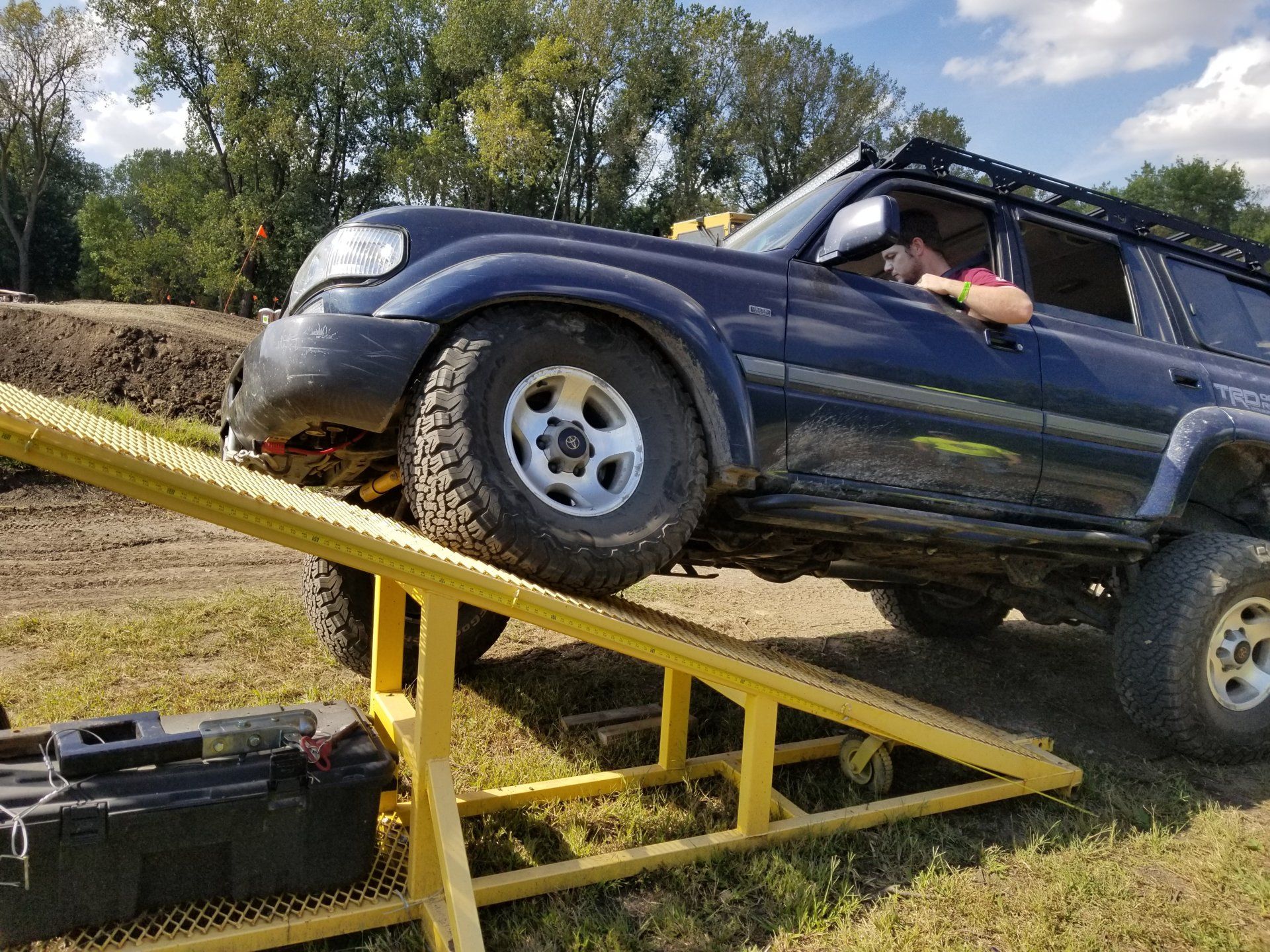

Didn't think to do it connected and disconnected, but I got a 709 on the ramp with 4 adults and 2 little kids riding along :). Next time I'll get a comparison done. I'm definitely happy with it, easy install and easy to use and it does what it's supposed to!
