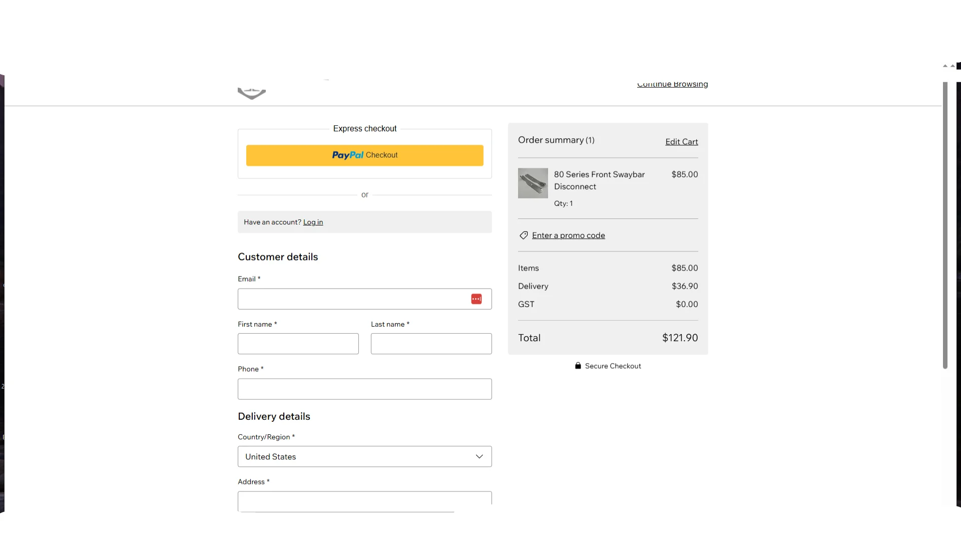

Did you put them in your cart and go to check out ?
I did and Paypal wanted $123. American. Shipped

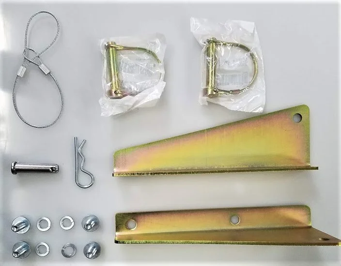

@LandCruiserPhil are $140. Shipped And including hardware, tethers & linch pines.
Making them the same price or less 🤷‍♂️
I took mine off 10 years ago and never looked back 😂
I just checked with Brad at Ironclad, all prices are in AUS dollar so 75 US.
Go for it 😎
Let us know how much it was landed in the US
Yeah let's see an install thread. I have the LC Phil ones. They're great.
