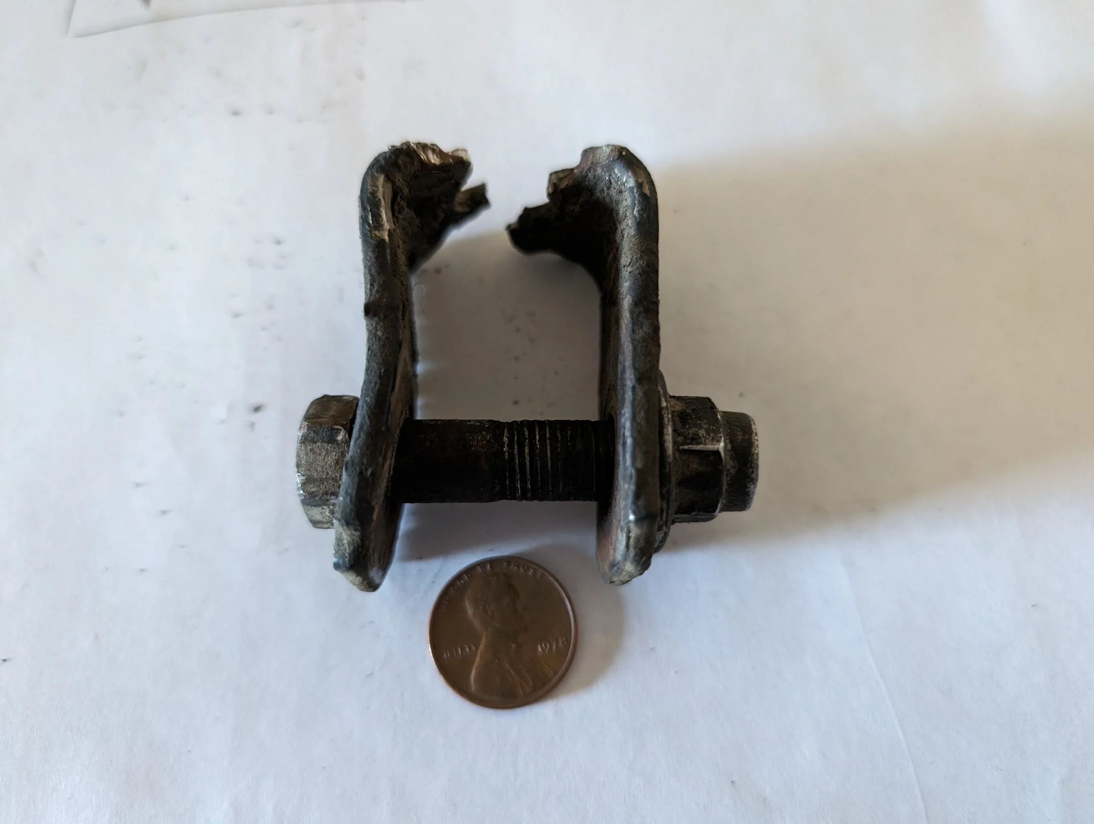

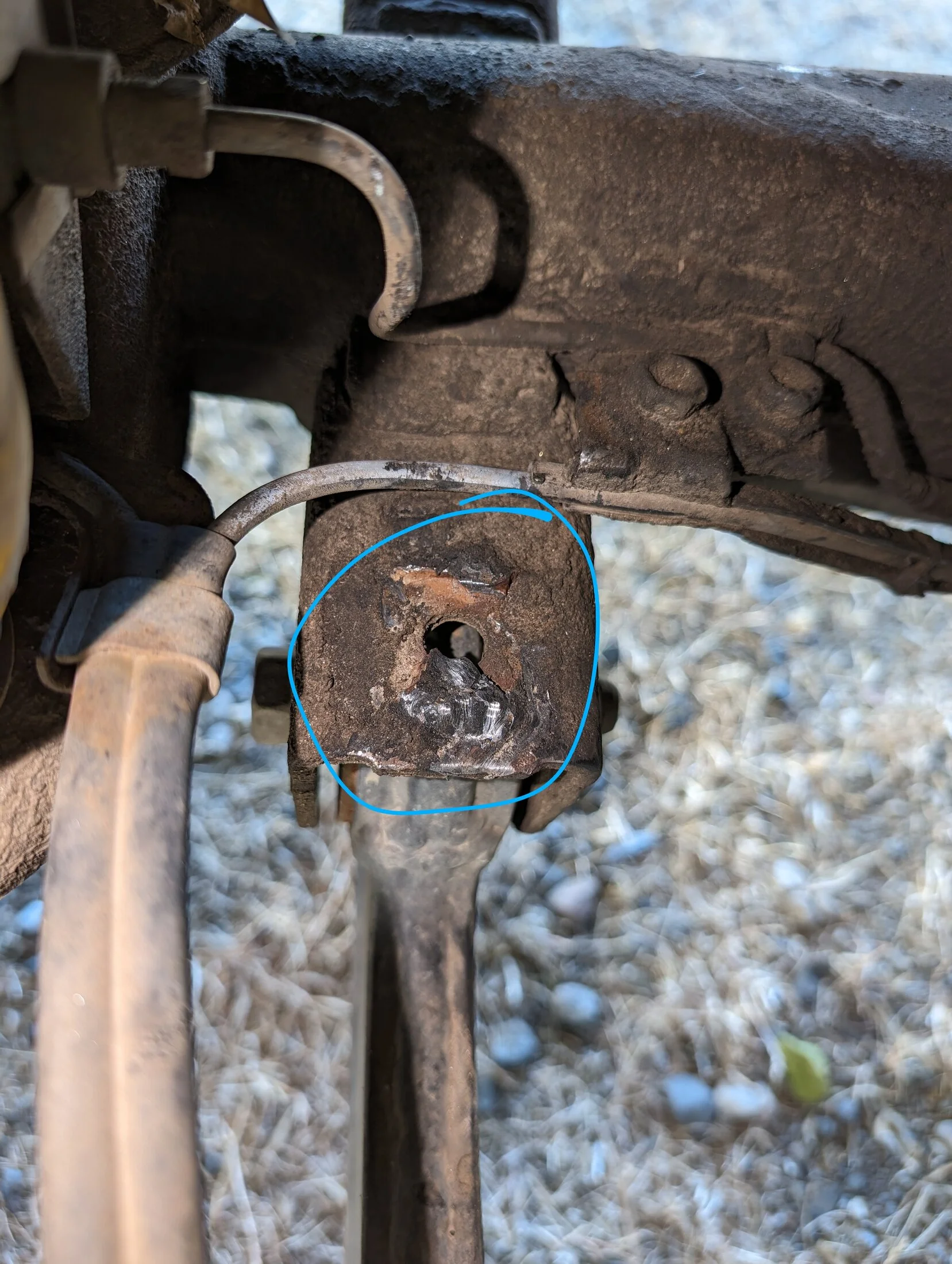

Apologies if the answer is buried somewhere in this thread, but today I broke the bracket at the end of the sway bar, on the driver's side... does this kit replace that bracket, or do I need to replace the bracket first?
We have sexy Extreme Duty Brackets coming soon.

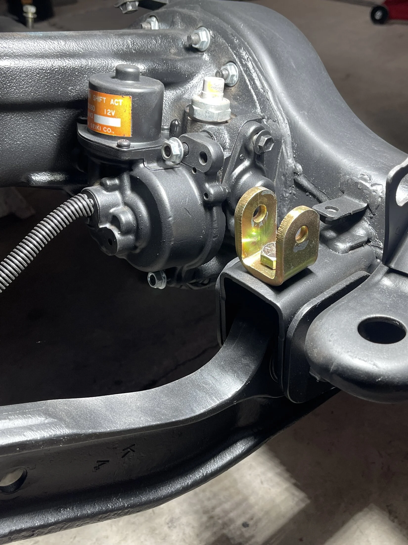

Severe Front Swaybar Axle brackets Coming to Land Cruiser Products later this week. View attachment 3657921View attachment 3657920
FANTASTIC! Looking forward to receiving my set!
I really like the bolt it the middle to center up the swaybar mount and tack in place, I was trying to imagine how I was going to get a set of vice grips on there correctly to tack it in place and weld it.
That bolt in the middle is brilliant. Tighten it down weld away.
