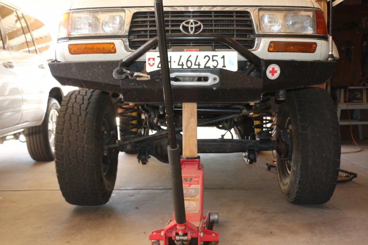

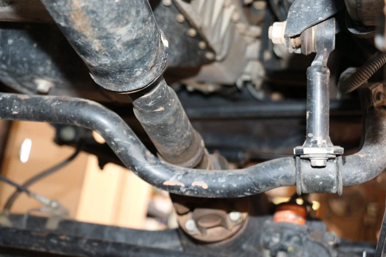

Pictured is the way to find out if you have clearance. First disconnect your swaybars:doh: and jack the vehicle up like pictured. Jacking one side at a time will not yield as much as pictured. My swaybar spacer (pictured) are custom welded extensions where most use blocks, both are fine. As you can see from the pictures my clearance is tight. Some may say too tight but I would never say its too tight;) So far after 10's of thousand dirt miles I have been golden.
Some have said just extend your brackets but it will not work. Back when I was in the design phase (yep contrary to what others have alluded to there was design) I removed the springs and set the 80 on the factory bump stops to make sure there was not conflict not matter on compression. Full extension is your end of the responsibility to ensure your have the needed clearance.

I'm not sure why OME doesnt automatically include these sway bar spacers in their lifts. Whenever we put an OME equipped 80 on a lift In the shop w/o front sway bar spacers, when the front tires go full droop, the front sway bar smacks into the front driveline . Nothing you want on the trail, that's for sure.
You can get these spacers from ome, manafre, Slee, etc. Do the rear sway bar while your at it, simple and not that expensive.
