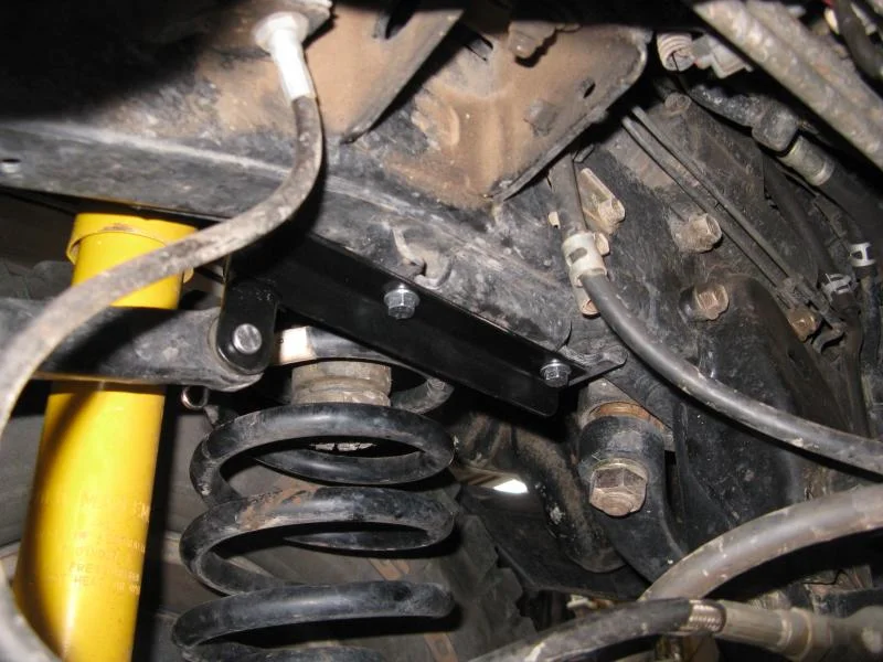

Back in 04’ I fab up some front swaybar quick disconnects and ran them on my 80 for a few years with no issues.
https://forum.ih8mud.com/80-series-tech/22921-front-sway-bar-disconnect.html
Recently I have seen more interest so I did a slight redesign and put them to the test to get some real numbers.
The swaybar disconnect take about 5 mins to install with basic hand tools. To connect and reconnect the swaybar takes ~1-2 minimums tops.

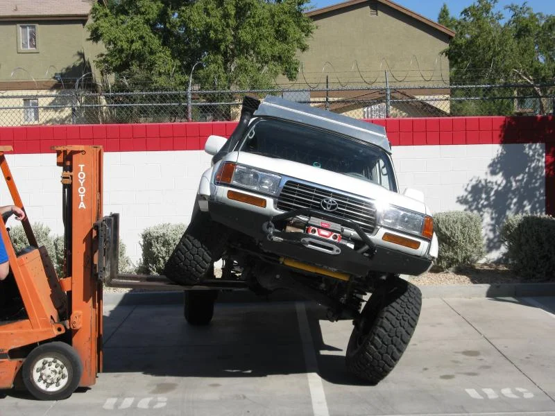

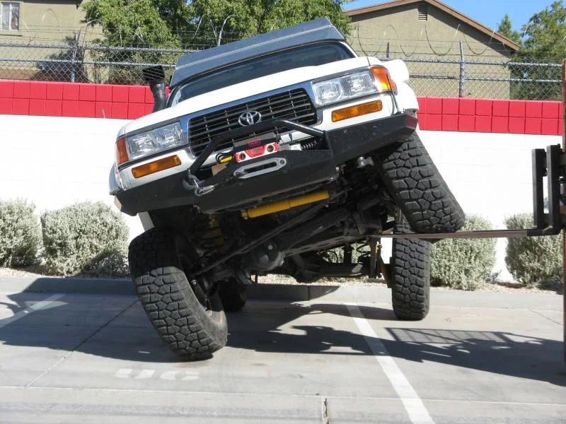

With the bar connected in the stock position I was able to lift a front tire 26” above the ground before another tire saw light. With the front swaybar disconnected the measurement increased to slightly over 30”. An increase of ~15%.:clap:

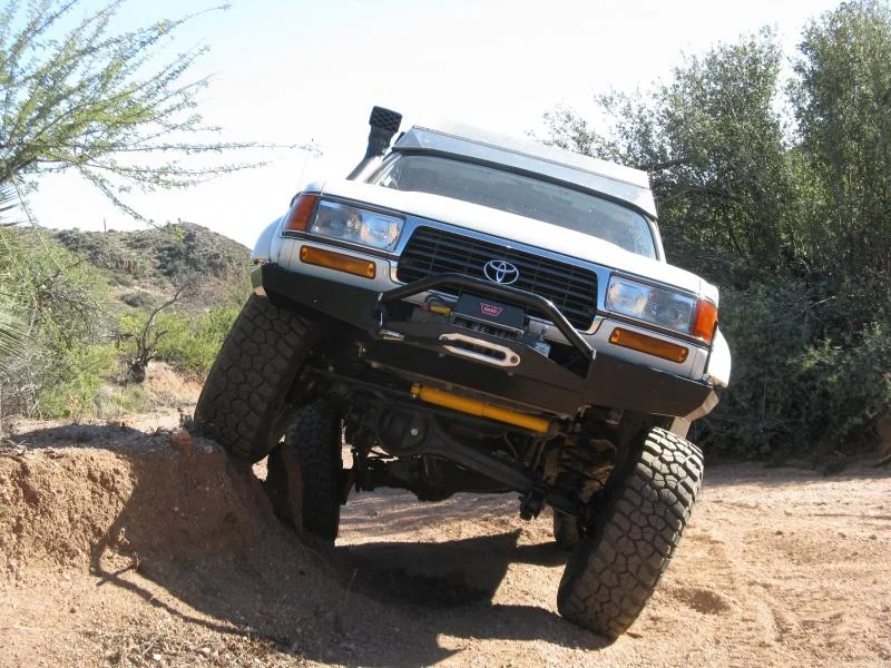

On the trail I noticed the front end articulating easier and smoother, another plus.

Flex is not a problem, full droop is where the concern will be. With that said definitely something needs to be checked by lifting the LC from the center until both tires see air.

My rear swaybar drop mount is ~2 inches on an 850J/863 lift.

Are you still using the stock mounting brackets on the axle end or are you using beefed up one or lengthened ones. I ask because you know they are prone to ripping off and the stock ones make it difficult to remove the pin and to replace the pin.

I known several have but I have been very lucky owning 5 80's and never ripped a bracket. Being able to disconnect the sway bar does eliminates the chance all together.;)

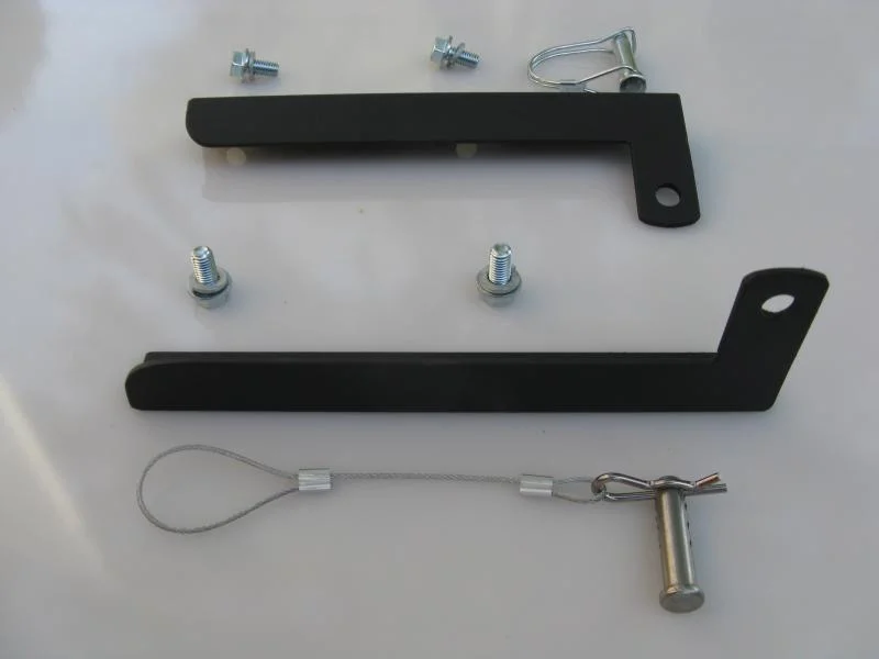

Yes you are correct a flat area is needed. Normally done when airing up/down. I always do the passengers side first due to the tight access and use the clevis pin to make installation much easier. The cable attached (one loop goes over the swaybar) to the hitch clip makes the removal again very easy with less chance of loosing the hitch clip. Then the drivers side can be moved up or down to line up the the pin with the wire snap. I use two different style pins (see photo) to make the operation as easy as possible.

I have spent a lot of time looking at options over the last 9 years to achieve the easiest method for connect and disconnect. You do not have enough room to use the pins pictured above on the passengers side. The pins pictured above requires support on both sides to work. In addition a pocket for the swaybar to fit into would make the procedure more difficult.
