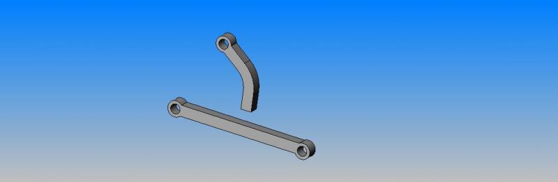

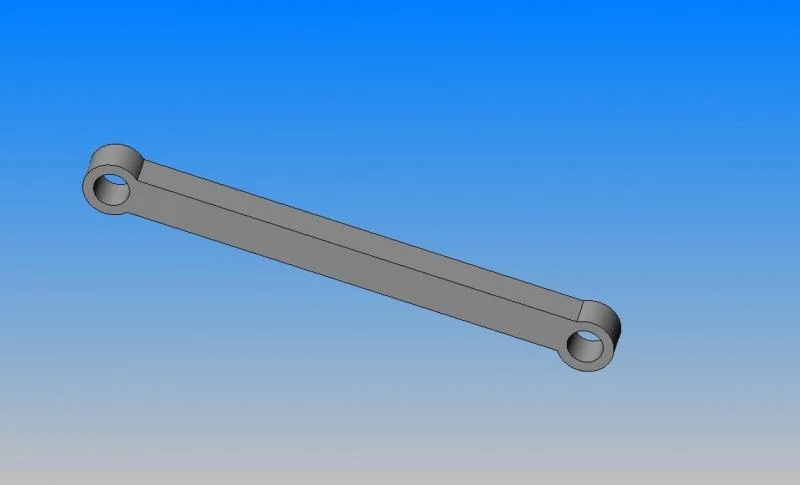

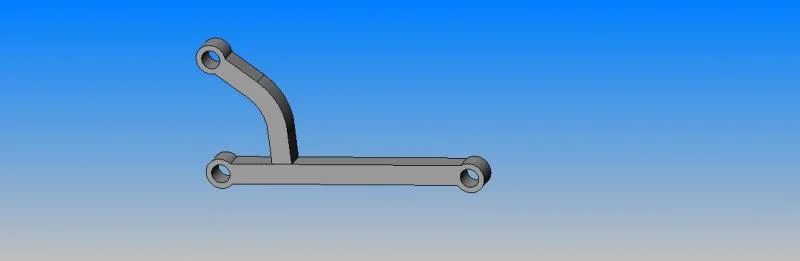

so, since you (akarilo), have a second set of arms - so do I actually, and this is intreging enough I might have to consider doing this with them - here's an idea for you if you don't want to pay shipping on arms from austrailia
(these dwgs are not to scale at all, just representative)
Step 1 Take your normal arm cut it off after the first mount.
Step 2 Fip it and rotate it to the top of what's left of the arm
Step 3 Weld it to the top of the arm
Step 4 Brace it
Step 5 - make two L-shaped plates to mount to two axle mounts and the new mount you've just welded on top of yout arm
Step 6 - Ramp it w/ this arm and stock arm to get an empirical improvement, then run it a bit and see what real world improvement you got.
rest of the models...
I actually wonder if this isn't how they made their first prototype. It's interesting cause really as far as I can tell it's just a Y-link raidus arm, and the inovative part is using the two plates to use current mounts to get the top mounting for the Y. I thought it might have soemthing to do with the plates going through the one remaining stock bushing, but it isn't through it in such a way that it would effect that bushing.
I'd say it's worth one scraped arm, two plates, and a little welding time to give it a try.

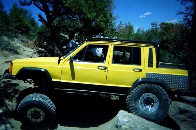

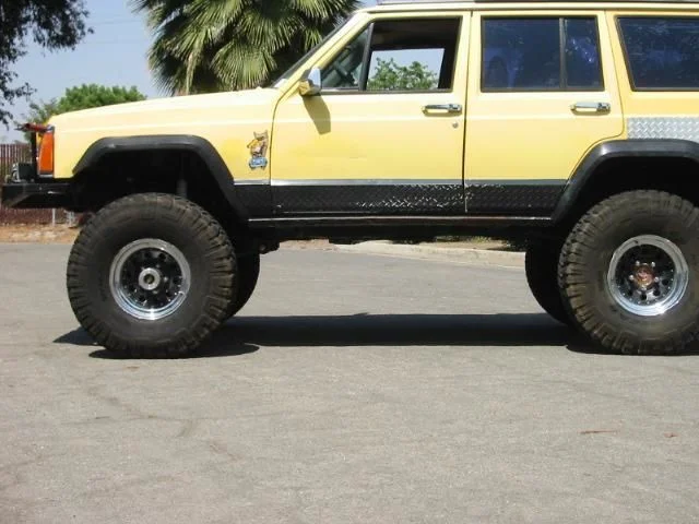

This is what an XJ on this exact setup (7: lift) looks like on a 12" travel shock on 37's. This rig has run the Hammers and other BOTW trails and it is not a trailer queen. Notice in the road shot the mount position of the lower arms - when the tire clears so does the arm, but because it is mounted flush to the axle (LCA) the angles are still good from a geometry perspective despite not running a typical 30+ arm length in suspension conversions.
