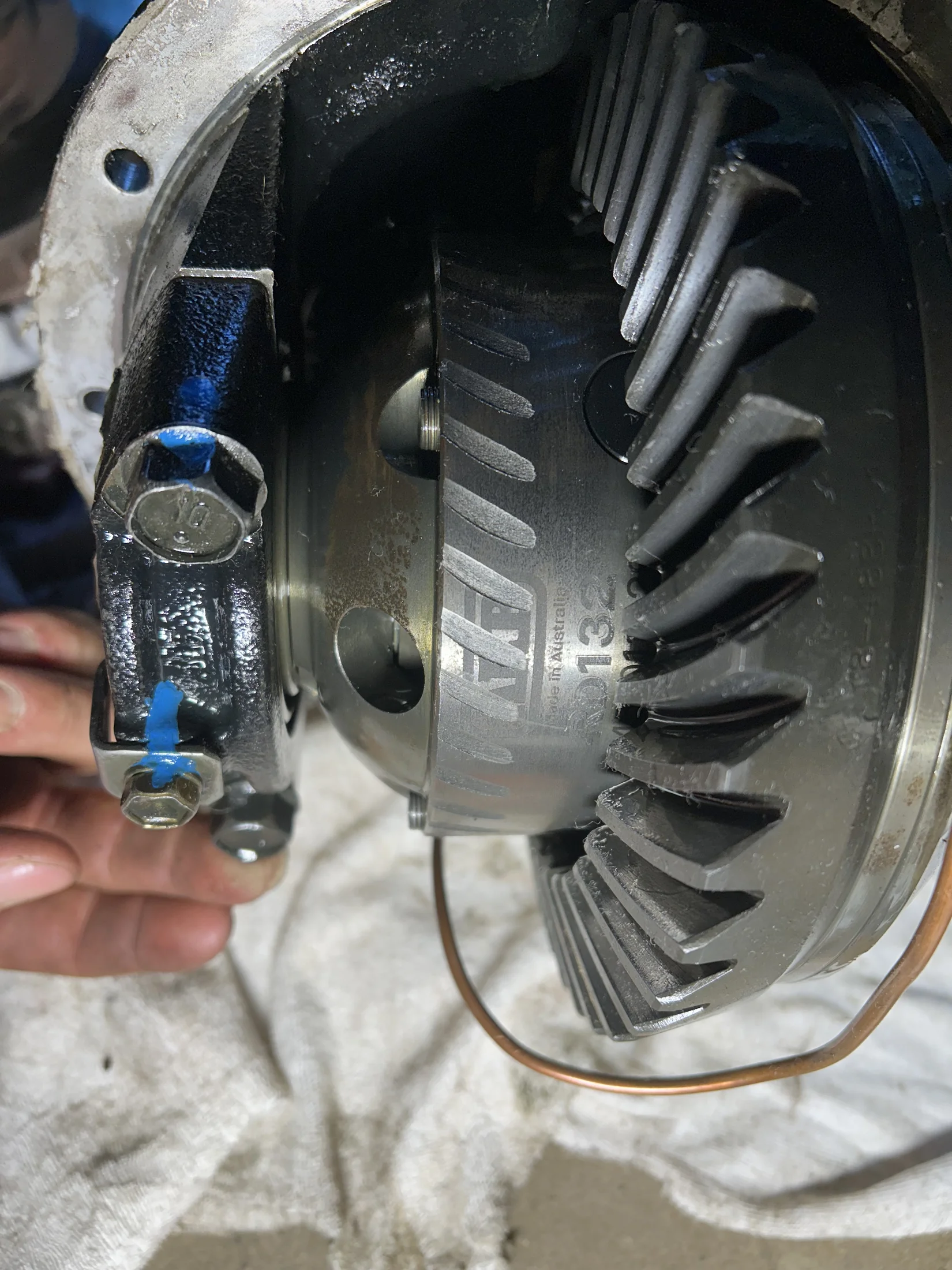

Vibrations have been solved. Took cruiser to the shop they put it on the lift and drove it, they said nothing sounded alarming. Pull front end tonight and this is what I found. Shop hasn’t seen it yet but I’m demanding all new parts and labor cost back. Will probably ship them to a Yota shop somewhere. Haven’t pulled rear yet but I’ll post a grease pattern and seen what you guys think. Thanks for all the input.

Ouch. That's not good. Looks like a botched job of re gearing.
I think that's off a little bit :oops:
@BuckeyeFZJ : You could send that photo to ZUK (gear installs dot com) for his opinion.

zuk no longer works on ARBs. I get it. I've had my share of messing around with air leaks on these too.
The ARB case is a little bigger then stock on some applications and they even say that the pinion needs to be ground on some installs. Putting older 4cyl pinon gears installed with a v6 carrier also requires the pinion to be ground a bit (talking about low pinion 8" here) But that looks extreme need to do all the usual checks to see whats going on with it. I can't imagine not test driving after a gear install.
I have ARBs on my 80 but they're quite old, circa 2004. At that time no weirdness took place during the install, no pinion grounding required so I'm curious if the ARB case got larger since those days.
On the above pic, pls explain to me what exactly went down for my edification. Did the pinion make contact with the ARB case? If that was the case, the paint pattern should show a terrible contact pattern, no?

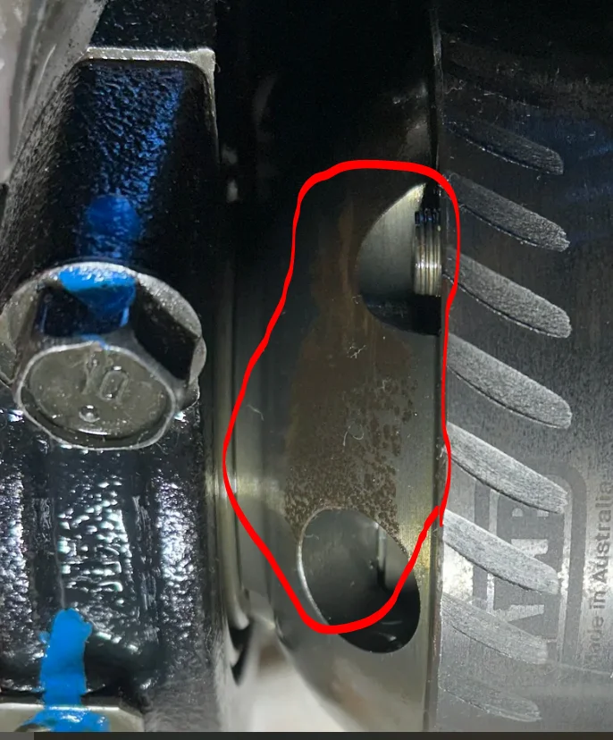

Great find by the OP. I'm also curious about the red circled area, is that corrosion or leftover gear oil?
