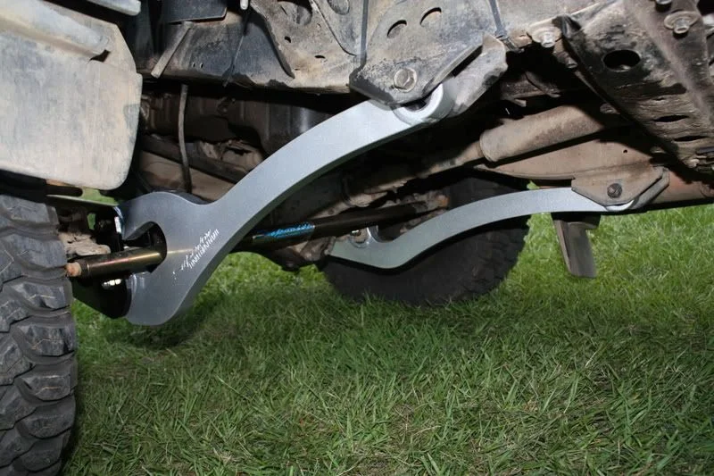

What the SE arms are in effect doing is creating a 3 link function in the "lower" mount of the arms with a single upper mount to retain four mounts to the axle for safety and stability under torque.
This is halfway to a y-link radius arm setup that maybe has the stability advantage of the stock setup with the flex advantage of the y-link.

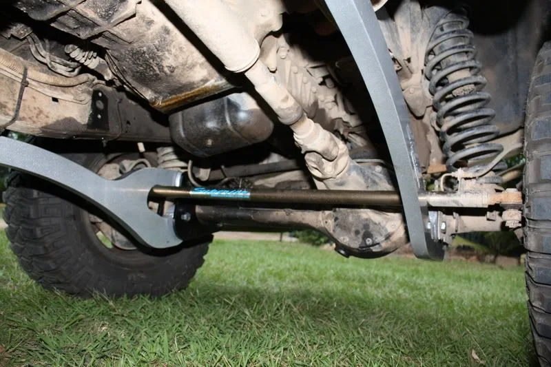

Ok, this is interesting. These two pics of the modified arm at full flex on a ramp appear to show that the arm can hit the tierod on both ends of stuff/droop. Not good to have that has the limiting factor.
It would seem that this is a potential significant compromise for anybody looking for a long travel suspension given the 80 in the pics is only on a 3" lift with "OME 3" shocks".
i was just thinking about that. looks like the tie rod would easily come into contact with the arms.

I think that the top part of the left arm needs to be modified and mounted higher on the axle to give better clearance of the tie rod.

Funny thing is I was just looking at it (I started my front end rebuild two hours ago and just came in for a slice and a breath) - and my biggest concern looking at it is the tie rod. The second biggest is the sway bar. They photos you're showing don't have a swaybar so I guess that's how they got around that issue, though might be able to get around it on my taller lift and flatter arms (remember, I'm the odd duck w/ dropped arm mounts) by not dropping the swaybar and putting links on the end. but, my hands were full of grease, and my priority was still on getting everything apart, now clean, paint, grease, reassemble, and while I'm running to the part store for brake pads, I'll charge the camera and take some reference shots

I don't think this can work with stock arms because the tierod is close to contact due to caster correction at static height, and the SE arms are angled below it to accomodate the extra flex.
But it would clearly be a hell of a leap of faith to buy those arms and hope that they both correct properly for caster for a DC shaft and have clearance for the new flex.

This link posted earlier has a pic of the stock setup, a pic with one bolt removed (the hitch pin mod) and then pics of the modified arm setup, so you can see the differences.
There should not be more flex in any material way than just pulling one bolt, because you are accomplishing the same thing. What the SE arm gives you is the benefit of moving a front mount while retaining four links.

The SE arms allow the axle to rotate around the axle center. There are two forces that stop the axle from flexing. There is the fore and aft movement that Nay is talking about, but also a twist/ rotate around the axle center. If you take three pencils and you glue them together like the two arms with the axle 90 degree to that. Now try to move the one arm down, and the other up. The rotational bind around the center is more than the fore and aft. Essentially the arms is trying to twist the axle like a candy cane. Just not going to happen. Only moves as much as the bushings allow.
That is why the tierod in the SW arm pictures moves up and down. The axle is essentially held in place for the rotational movement in just one place (the two bushings of the stock looking arm).
