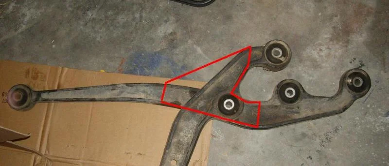

dang, it's amazing how was seems perfect when you're 10 miles away from your truck, doesn't seem to line up right when you grab the parts.
could still do it with stock parts, just would have to use 2 arms to make one, cause I think the cut point you would have to use to get the top part long enough is just about at the edge or the middle of the 2nd bushing hole.
Maybe grab a radius arm from a dodge FSP to sacrifice?
or another LC arm I guess

the ram arm might be longer though in that area - maybe I can get out and scrounge a yard next weekend...
Take a look at the potential interference of welding on the upper mount in the area of the spring perch. SE's design does not require this as it brings the upper mount out of the bolted on replacement brackets.
This is why most 3-links have the upper mount angled in from the lower so the mount is inside the spring perch - not sure of that compromises the design as you can certainly angle the upper arm bracket off the lower arm to point it in, but something to look at before scouring the boneyard as angling in the upper arm would be a differentiated design from what SE has done without in my mind a clean idea of the potential impacts.

Do you think one could achieve a solid enough weld to make it reliable?
yep. I'd weld all the way around, then, I'd put those triangle plates on either side, do a full weld on each of those, and possibly even do a third piece on top of the triangles, if for no other reason to cap it all. Look at the red plate - shape would have to be tweaked to allow proper clearance, could tell better after cutting the front off one arm. Maybe I'll look closer at it tomorrow when the wheel and knuckle are out of the way. Ready to donate some arms? ;)
You have totally missed the boat Nay. I'm talking doing plates like SE for the upper mount, and then just making my own arms out of two stock arms, for no other reason than I know I have two and so does the guy starting this thread - well, that and I think you'll find the shipping from Oz to be more than most want to pay. Since I already have the arms, or could pick up another for $20-$30, and have 20' of 10" wide 3/16 plate in the garage, and 5' of 1/4" x 12", I pretty much can do it all with stuff I already have just as a proof of concept.
Yes, I missed that phantom assumptions boat on you making up a set of plates :flipoff2:
Give it a shot with the stock arms and post up the result. It's been discussed before and nobody has actually tried it.
