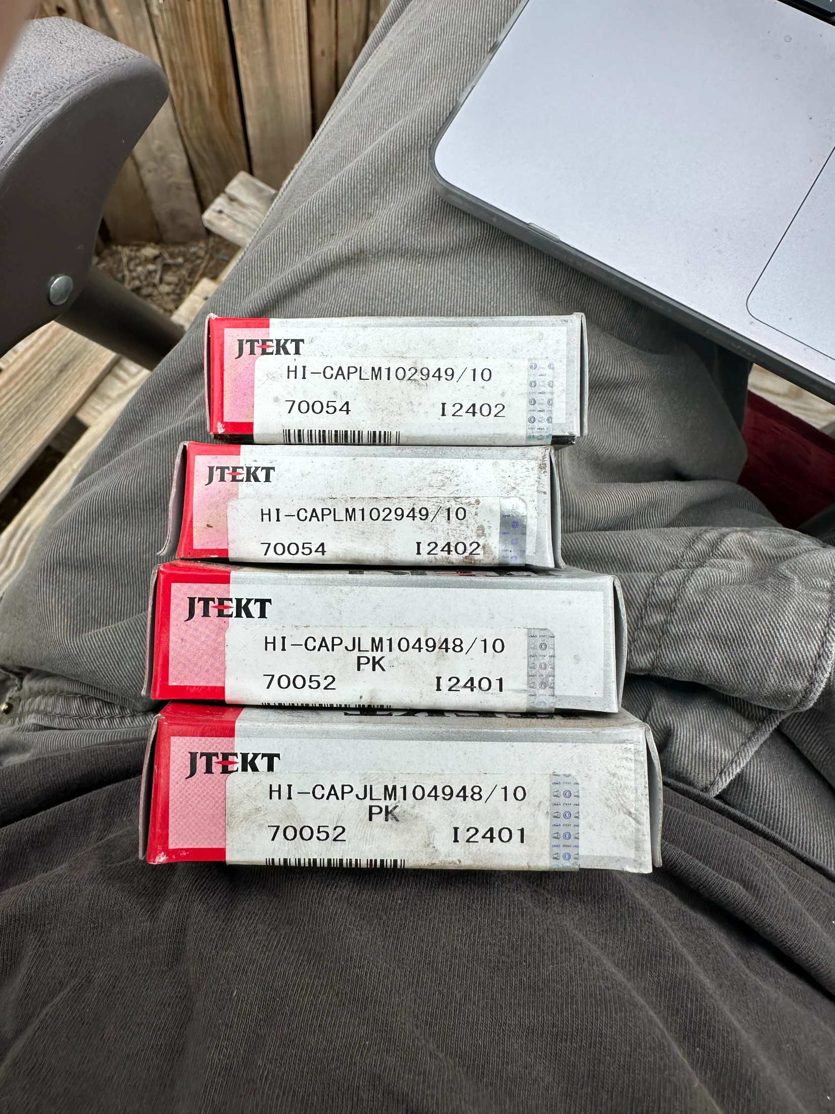

Hi @lumbee1 there was plenty of grease. I lifted the front this am and spun the wheels in all positions. There was no sudden binding or grinding. I have a set of front bearings (i think). Maybe I'll take the others out and check them. I would think that any binding would occur consistently, but maybe truck has to be under load and under way for it to happen. I still have to check the rear, but am 99% sure it's coming from the front. It also seemed to be both sides yesterday before I removed the front driveshaft. I wonder if I damaged my front t-case. 🧐 It has plenty of gear oil in it.
