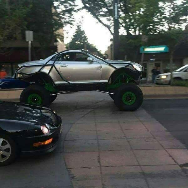

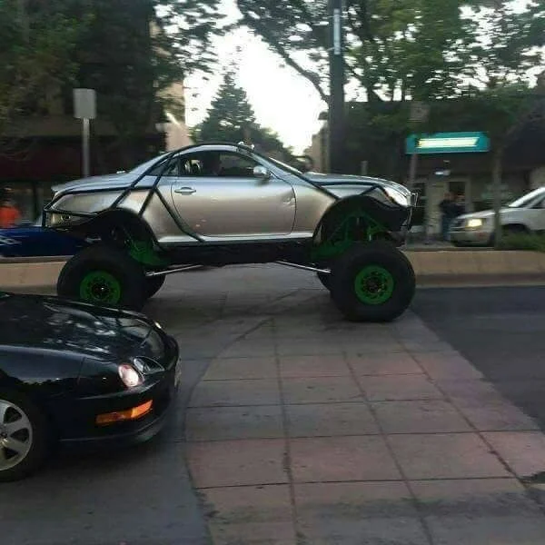

If you are going lexus, SC430 is the way to go. Like a FJ40, you can go topless
Sawzall the fenders and quarters, hammer out the rear wheel well, chop and weld as needed. I hear general grabber at2's are pretty good for a budget gravel tire, and have seen them in smaller sizes (on CRV's, Subarus and whatnot).
