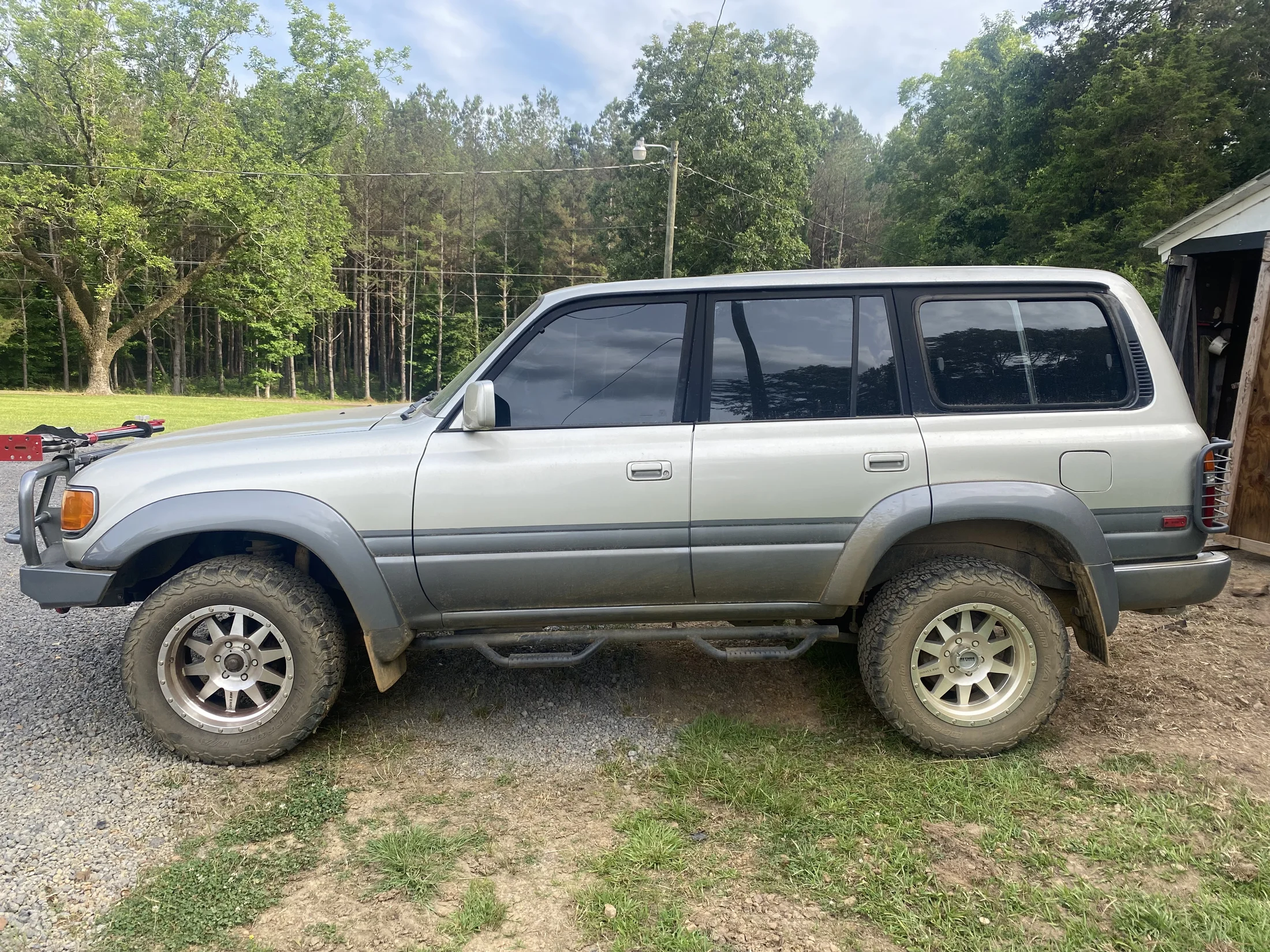

I’m looking forwarded to chatting.
Recently purchased an fJ80 and the 3FE motor has been completely rebuilt.
Unfortunately, the alignment cup on the motor side of the torque converter was broken off inside. I’m new to this therefore my part description is possibly incorrect.
Having a hard time finding a replacement.
Has anyone ever heard of this issue and what’s the best way to repair or replace?
