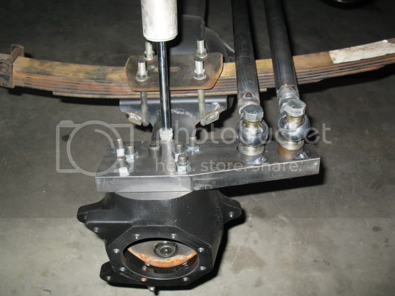

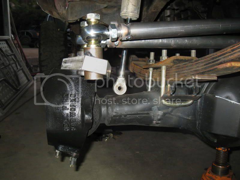

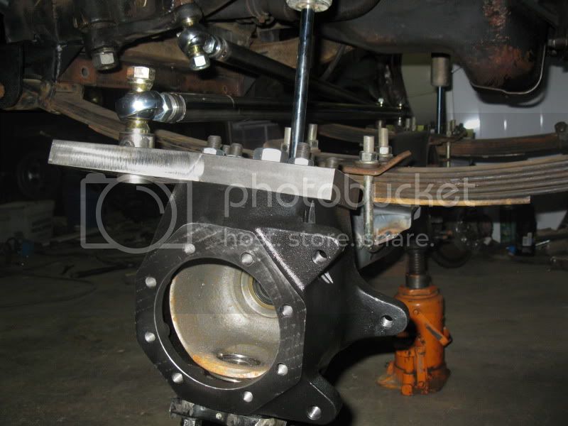

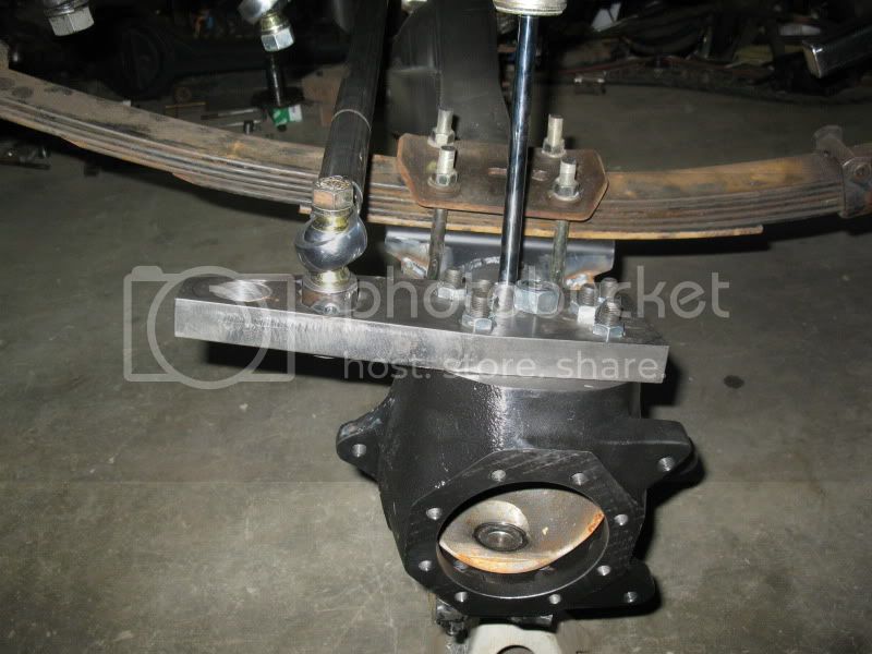

fj80 high steer anyone?
these arms are just for testing, they dont have the finishing machine work that the production arms will have, which will look a lot nicer.
Those things are huge! I like it :D.
So that is an 80 series front housing with your knuckles/arms on it? I would think the minitruck crowd will be happy to see this.
Looks good. Cant wait to see the finished product

Lookin' great! Are you going to make arms to suit RHD and can they be made to accept standard TREs? How much and how far away are you from wanting a list of buyers?
thanks, and yes, these arms will have 2 holes per arm, so you get your drag link hole on the left arm.:D if there's enough demand i will do a run of standard TRE arms, but i know that they wont work with leaf springs. they also wont allow you to run them under the arm. i like the adjustability of the heim joint style arms, but like i said, if there's a demand i will make it happen.

If I'm looking at the photos correctly it looks like the tie-rod sits forward of the housing. I can't tell by the photos but am wondering if the ackerman angles have been worked out/included in the design.
How could they be? ackerman steering takes into account the rear (fixed) axle distance from the front axle as well... doesn't it? Therefore his will be different than a cruiser.

My question was based on the assumption that whatever vehicle this would be used on would have a rear axle of some sort (wheelbase unknown) and as a result benefit from some ackerman angle being worked into the design. Just looking at the pics it appears to me that no ackerman angle exists. Just my observation and question based on a picture that was taken from an angle that does not provide much opportunity to really see what is going on.
I hope that my question was not misinterpreted as bashing of any sort. Just asking...

no worries, i never took you as bashing my design. yes, ackerman angle was designed into it, and yes it is a universal design. if you have a really short rig the ackerman angle might not be enough, and if you have a really long rig it might be too much. when you buy a longbed crew cab fullsize truck it has the same ackerman angle as a shortbed single cab. just wanted to put that out there before i get called out again.:lol:
