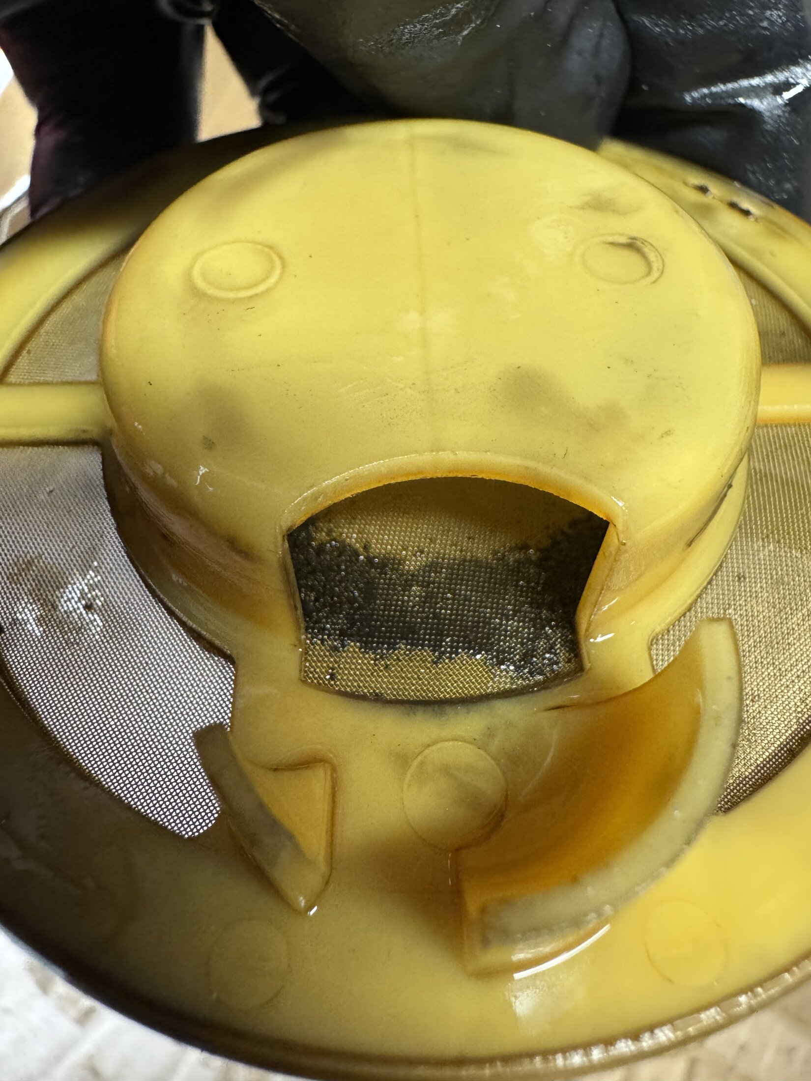

Pulled the reservoir apart. Great call man. Here is what I saw…
- Lots of old sludge in the bottom of the reservoir
- “Outer” screens had blockage for sure
- “inner” screen and the “horn” had lots and most of the blockage (see pic after 2 cleanings… it’s spotless now)
- that Lucas is way thicker than regular atf (going with mobile 1 …. Tell me if I am wrong… I’m oil dumb)
Plan is to use the low pressure return to cycle out all the Lucas crap for the new stuff
Cheers 🍻 and thanks

Reporting back….
- Reassembled the reservoir
- I did the lazy man’s fluid swap through the low pressure line - worked great - swapped out 2 quarts
- Bled everything with ignition in ACC position
- Started truck and did the same bleeding procedure (with the cap off and the fluid was NOT shooting out of the reservoir like it was before I cleaned it)
- Testing - everything was way smoother, faster and that “stutter”/lockup I had when turning left is GONE!
- Overall, the power steering seems waaaay happier and has zero noise or groan
If just the cleaning of this reservoir and inner baffle/screen/filter fixed the issue @baldilocks …. I might you a lot of beers (I was about to start throwing money at this issue!).

All the crap caught in the screens… my truck has 350k on it. The high pressure hoses were breaking down super bad. My guess is that this crap in there is from the interior of those hoses (total guess but may make sense).

Glad you got that squared away. I would agree that much of that debri was from deteriorated hose.
