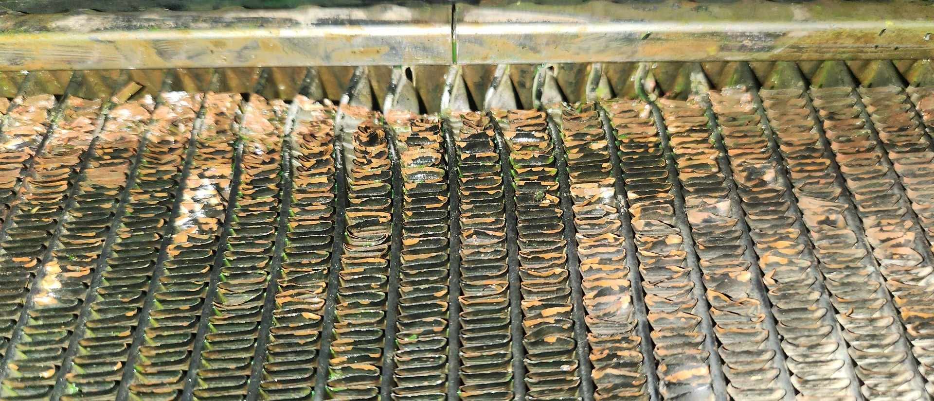

I'll attach a photo of the old radiator, ive now done the following.
New fan and fan clutch
New motor mounts
Water pump is also relatively new.
New radiator
All now coolant hoses
At around 4k rpm the fan still starts to warp which I'm guessing caused the original issue.
Only thing I can see is some of the studs going into the water pump are in further than others.
Let me know what you think!
