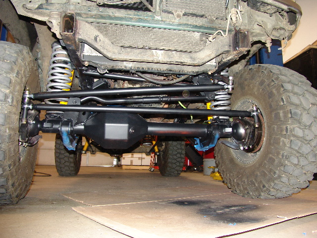

On the Blueberry, we ran hi-steer with both tie-rod and drag link up front. Panhard was parallel to the the drag link. With 6" of lift, we had no bump steer. Here is a pic of the linkages,
Thats interesting because from the looks of that picture the drag link and the panhard appear to be different lengths by quite a bit. Usually you would want them the same length but then again I know that what you usually want and what fits and works can be 2 different things.

its ok if there different lengths the trac bar and drag link have to be as close to parallel as possible so they pivot the same
I thought there is no way to keep panhard and drag link same lenght in a 80 .. not if you are respecting ackerman angles ..

Your links don't look in the pic complete parallel to the ground .. they do look parallel in between ..
Ideal would probably be same length and same angle in theory, however you can not really achieve that since the panhard mounts to the frame on one end. The picture was before bumpers, so the angles flattened out once the suspension was at proper ride height. it might have had a little bump steer, but nothing major. Also had hydro assist on that truck, so that helps by dampening it as well.
Alright that is good to know. It does look like if you keep them parallel the only time you should have any noticable bump steer would be on articulation. For the most part you don't see a lot of articulation at higher speeds and on road so that just leaves crawling and a little bump steer while crawling really isn't too bad unless you are getting really really technical.
I keep looking at that picture and from memory I don't think billys arm put the draglink any higher. But that is going off a picture and my memory so I could be wrong. It looks as though it should be doable but like you said its going to get tight. Front ends with links and linkage steering always seem to be 5lbs of poop in a 2lb sack. Throw a sway bar on there and make it even more interesting. :D
