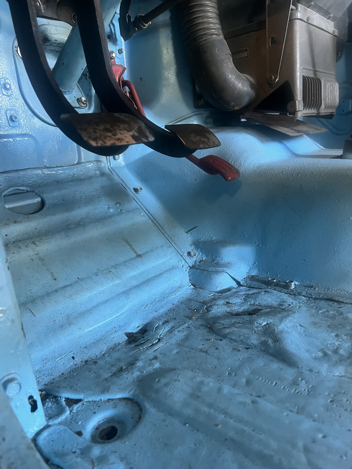

Just getting back to cruiser stuff after some life issues. My son has his 74 FJ40 and has been working on it. Finally able to go for a ride.
Here's the problem. He is having difficulty with the gas pedal height. I can barely reach it with my size 14 boot. He's tried putting his foot partially on the transmission cover but that's just bad and doesn't work well either.
Is there a way to adjust the height?
Anybody else have similar issue and a solution?

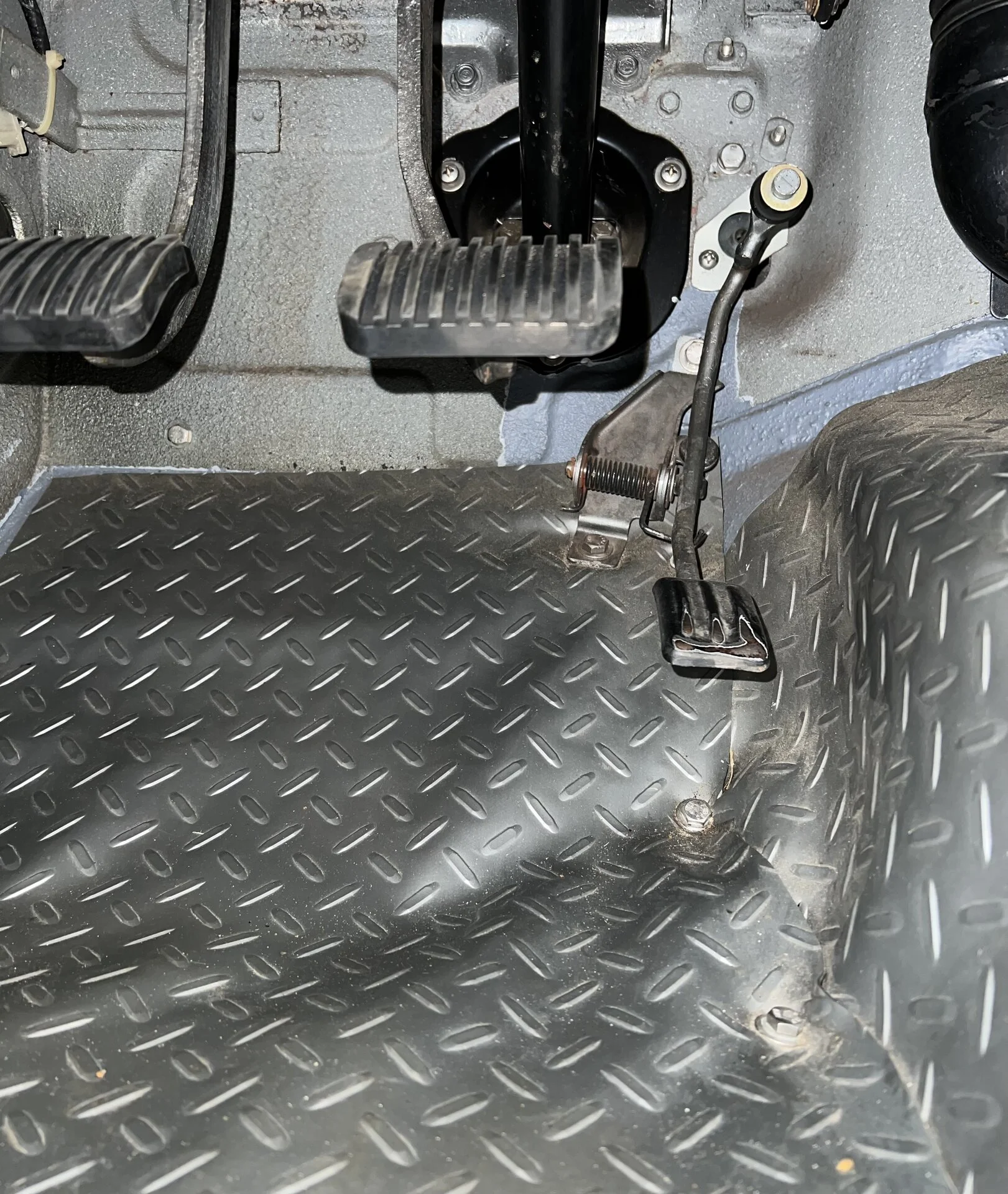

Are you saying the pedal is too high off the floor to easily press? I don’t recall it being adjustable, but I’m not sure about the ‘74. It does seem likely it’s not supposed to be high off the floor. A pic of your son’s 40 would help.

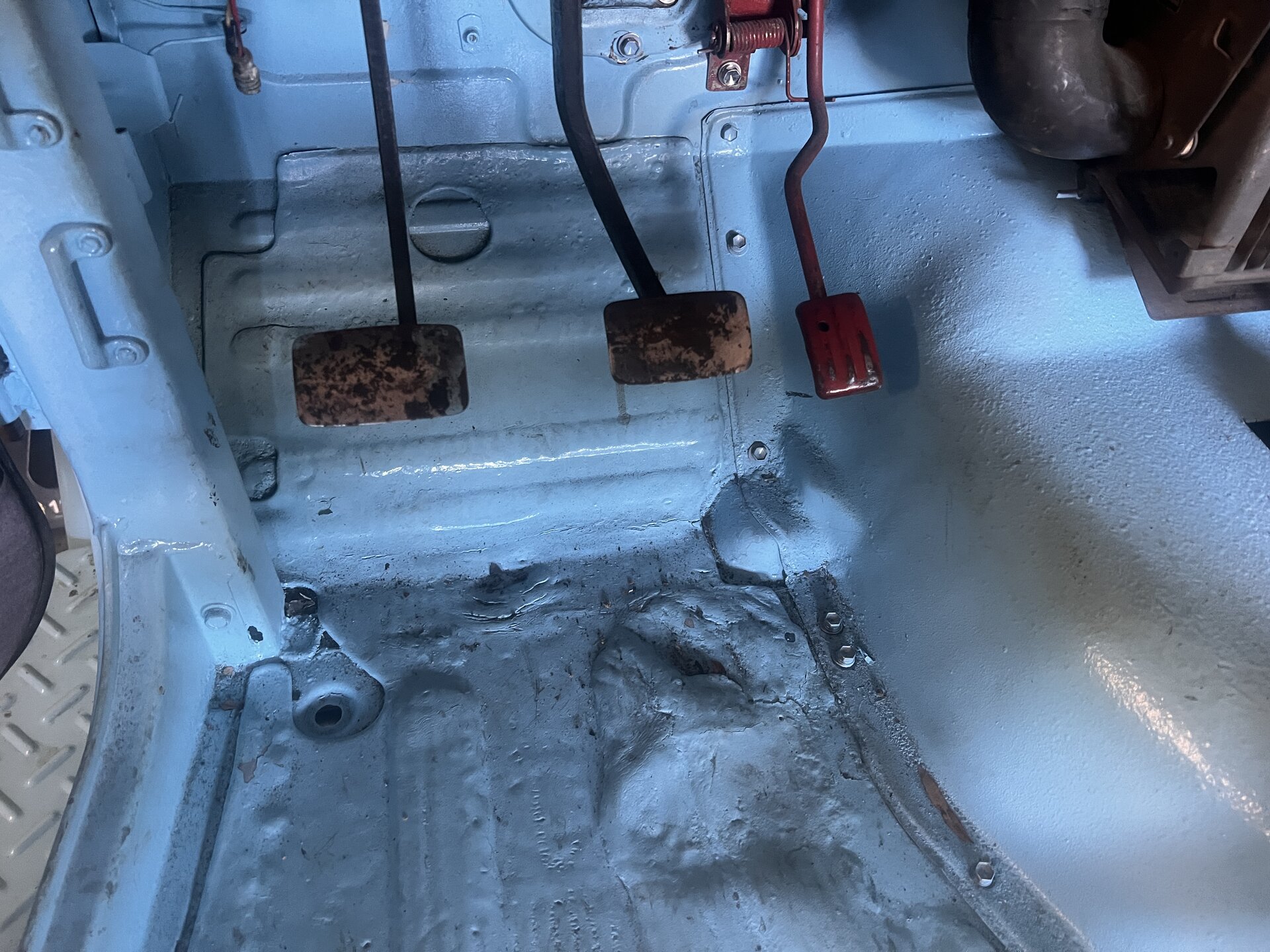

Here's what I have.
I have a 74. It’s not adjustable. I removed it, heated with a torch and shaped it how I need.

Perhaps I will try to bend it like @igotta40 . But mine is mechanical, not cable. I'd rather not convert. If I can bend it, it may be fine. I can't think of a better way.
depending on which way it is bent, you may lose some throw on the pedal and not get full revs from the engine
maybe shorten the rod and move the foot pad higher up on the rod??
