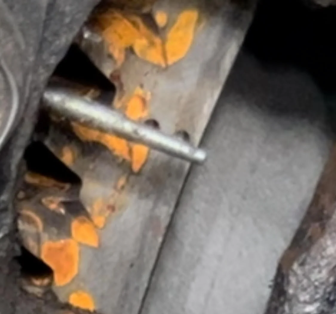

IAC has been cleaned but not the TPS. Connectors checked and cleaned. Intake rubber is intact. Definitely getting fuel but no start. Checked valves today and they were badly in need of adjusting - clearances were too low. And dissecting some photos of the timing gear just now, I realized that what i thought was orange paint to mark the bb, is actually rust. And no proper marks with the distributor rotor in position 1. So I guess I'll be re-treading tomorrow.

This afternoon I set up a mirroring session between my iphone and my laptop, mounted the phone to a bendable mini tripod and after some fumbling, managed to get it positioned with a reasonable view of the timing window. I put the laptop with me under the car and watched it as I turned the crank. It gave me a great view of the marks on the timing gear.

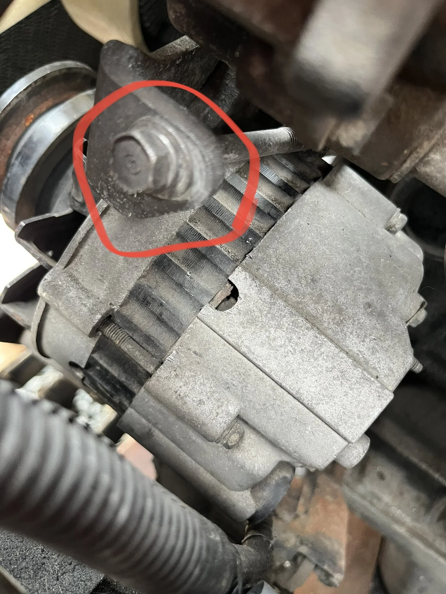

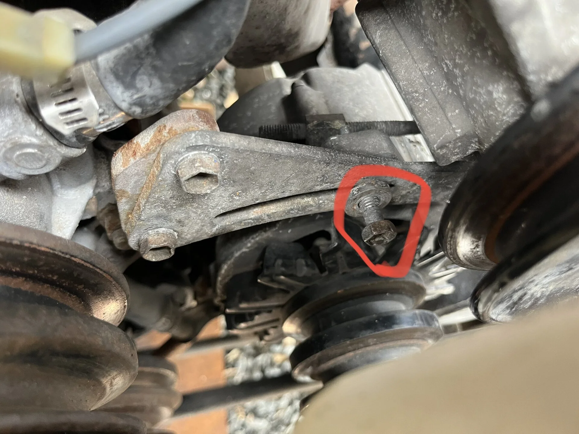

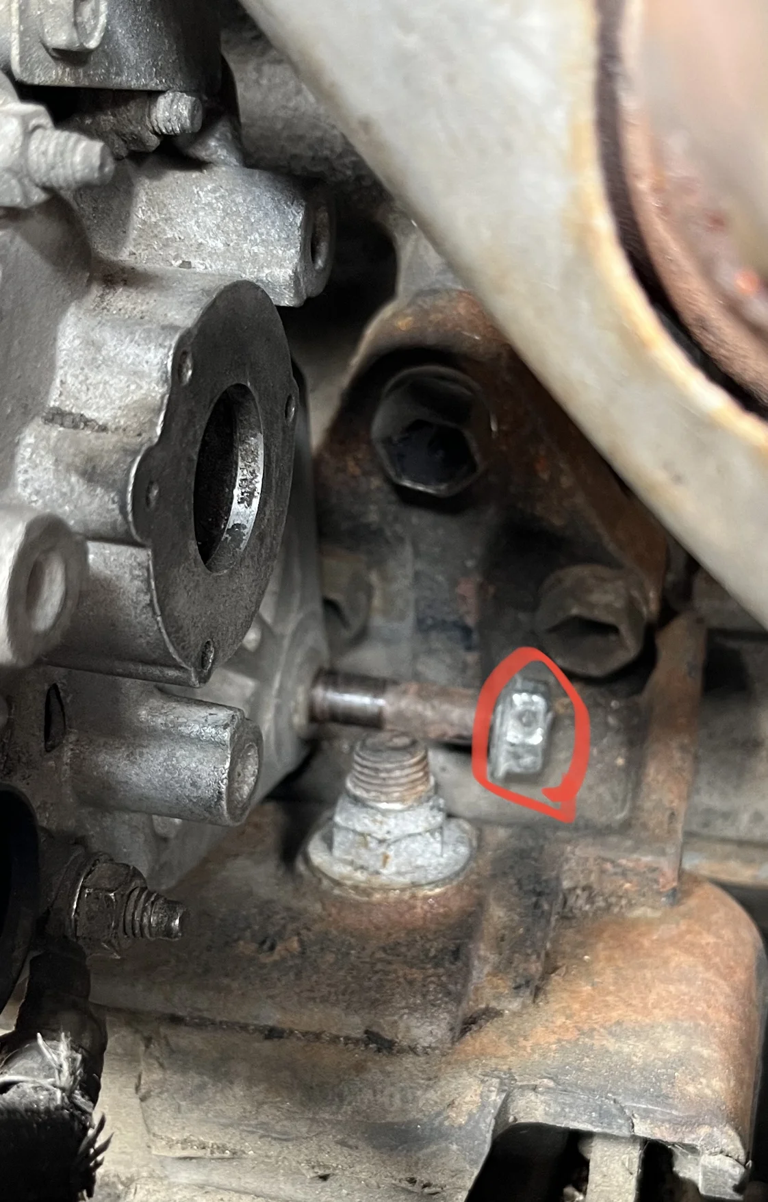

Next the belts need to go back on but I am totally confounded by the alternator which I can't get any motion out of at all despite loosening what I feel nearly certain are all the necessary bolts. (I cut the old belt off since it was needing replacement anyway.) I've attached. photos of all three bolts, obviously loosened to excess. What am i missing?
Thanks @toy_tek I was able to break it loose this weekend. I appreciate the direction since there's nothing quite like going at something with force then realizing there's one bolt still to loosen or that you've loosened the wrong ones. Looks like force will also be needed to remove the oil pan which I started tackling yesterday. Recalled reading about the bottle jack method but wanted to review again before attempting that. I also tested the dizzy and found the resistance to be out of range on the NE coil at 349. I wish there was a good reason why I didn't check this sooner but there have been so many other things to consider and address. Funny that I originally thought I was just going to find and fix some electrical gremlins and drive off into the sunset.

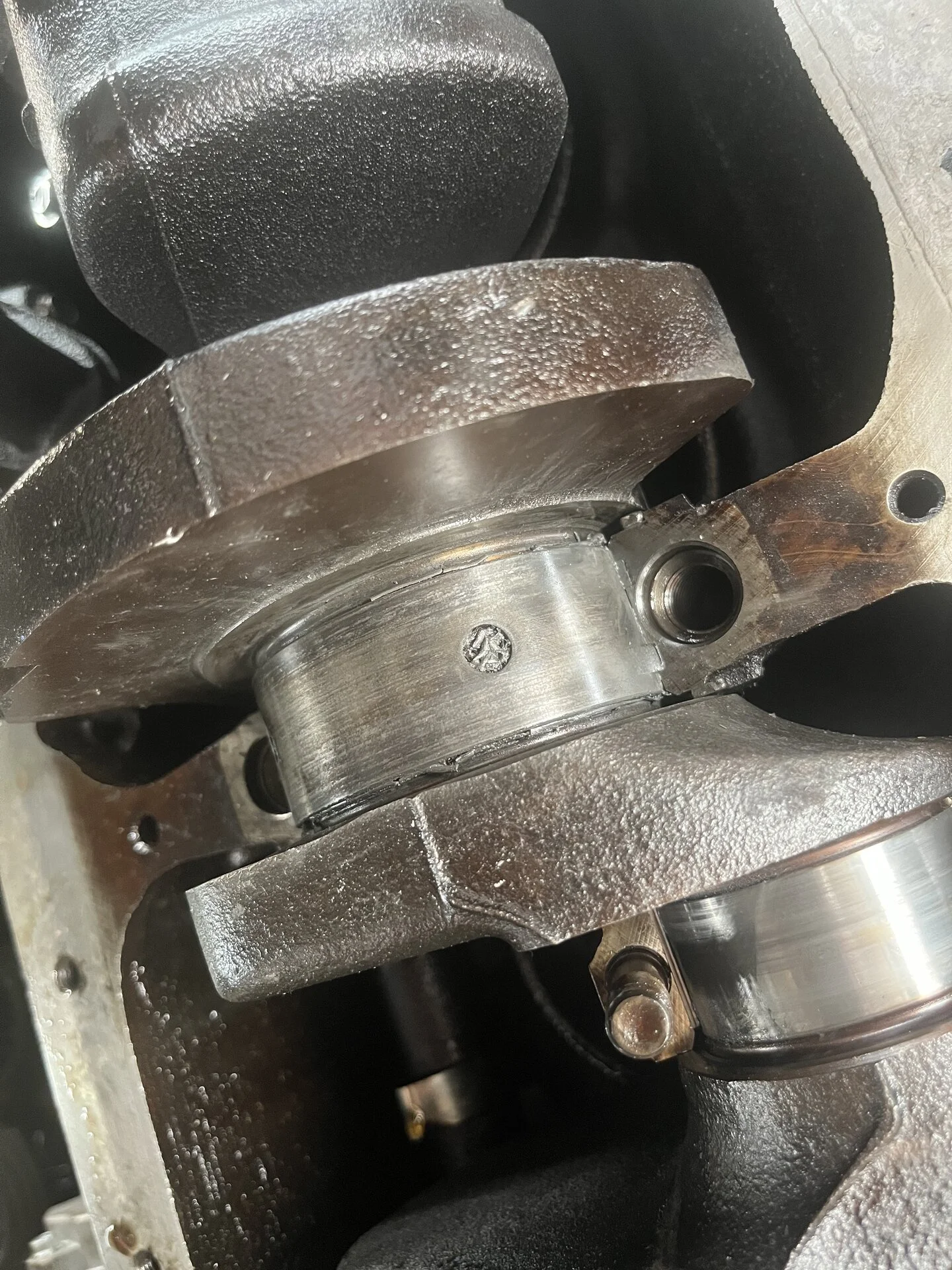

Well... it took awhile but I finally got around to pulling the head. Nothing to see. Pulled the oil pan to check the bearings and there was my answer - a spun main bearing. Everything else so far has looked okay. Regardless, the debate began even before a diagnosis whether to do an LS swap so there's that. On top of the fact that no one can seem to confidently recommend a good machine shop in central Texas. I've called the two most reputable LC mechanics in Austin and got one hesitant rec for a place they hadn't used long because their longtime place closed. But I've done enough belly aching on this thread. I just wanted to post something of a conclusion to this particular chapter in case anyone else encounters this particular set of symptoms because for a minute there things seemed pretty hopeful. In hindsight, it seems that there may have been a lubrication issue that extended far beyond a few seconds running on 2 quarts of oil. And that the constant immediate shutdown behavior was likely due to lack of oil pressure (if i've understood some things correctly) Feel free to correct me or expand on this theory... and thanks for reading,
Ah thats a bummer. Glad you found the culprit though, now you can proceed to make a decision on the "fix". Hopefully some of the TX members will have suggestions on potential rebuild shops to consider.
