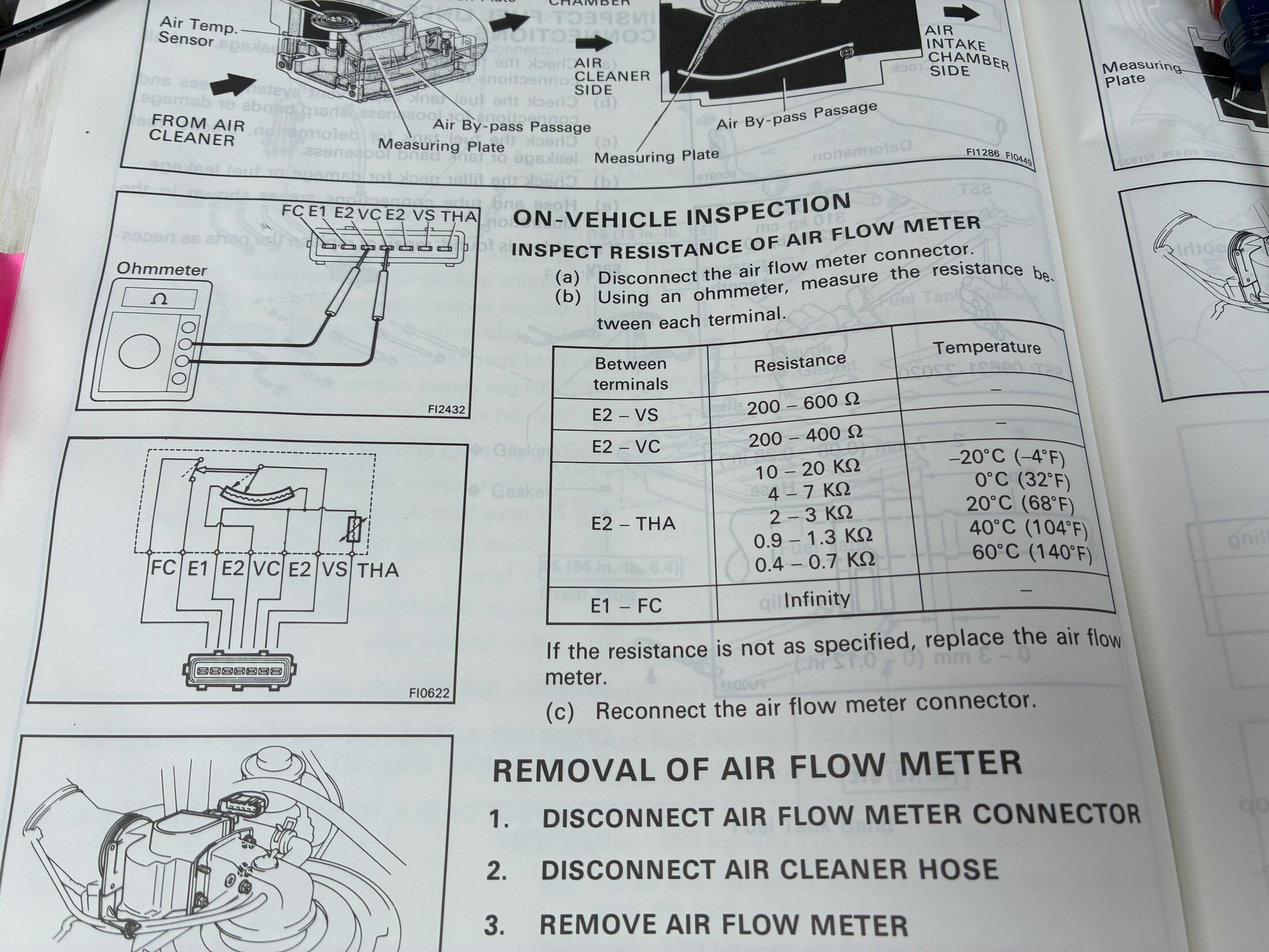

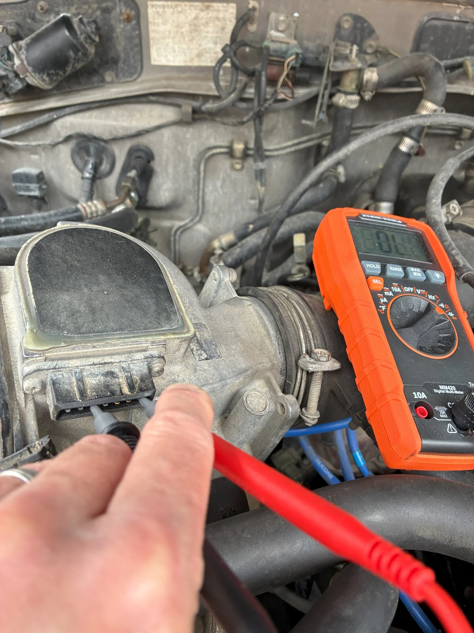

Went on with checking things and found an issue - the AFM resistance isn't checking right. checking infinity from e2-tha. The other resistances are in spec.
Does that mean I need to replace the AFM?

Another confusing wrinkle - I tested the resistance on the AFM from "E2-THA" per the FSM on my friend's 1990 FJ62, and his also indicated infinite resistance (his runs fine). <confused>
