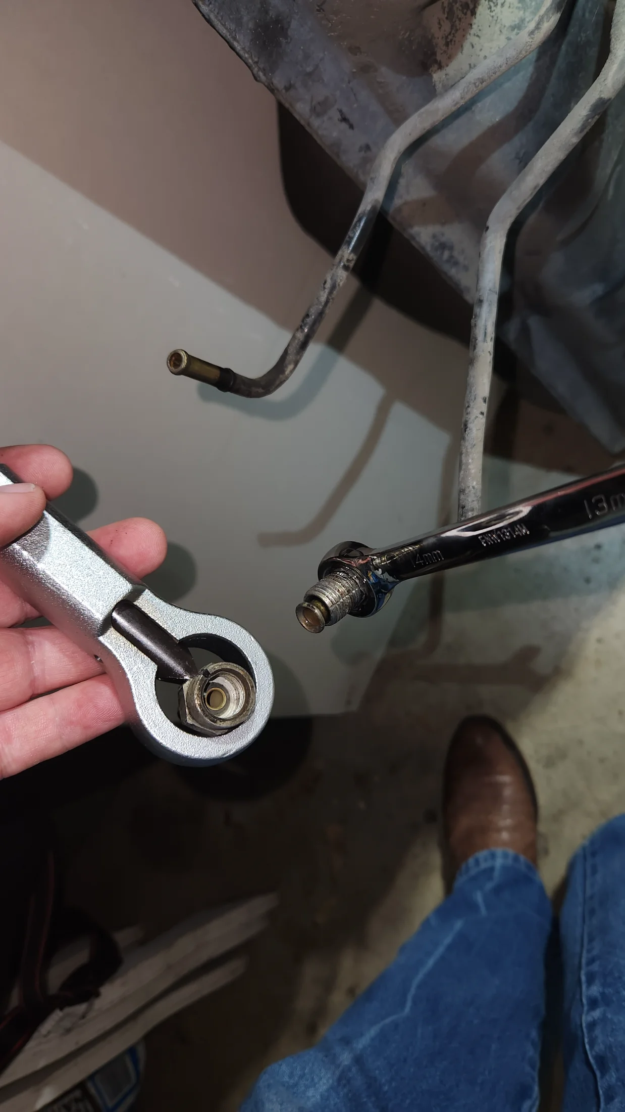

I had this very same issue in June. 360k on the OEM pump. Drove home from 45 miles out with 2 stops and restarts. Everything was running smoothly. Tried to start up the 'Cruiser the next morning and got no start.
Shorted B+ and FP to only hear faint sounds from the tank. Disconnected the fuel line at the fender filter in the engine bay. No fuel flow even wIth B+ & FP shorted.
Took a few weeks trying to nicely disconnect the Fuel Pump Tube from the Fuel Pump Bracket. No Joy. Ended up cutting the Fuel Pump Tube and splitting the connector nut with a drimmel and using a nut splitter to get the tube nut off the hard Fuel lines.
