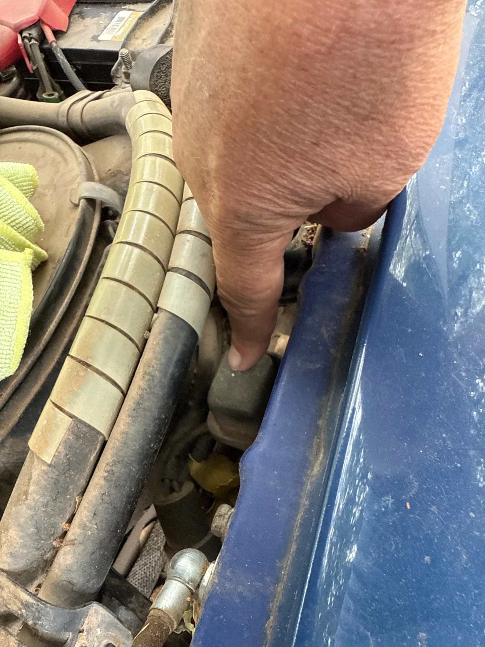

There’s a EFI relay on the pass fender well that acts up on mine sometimes.

x2 on the relay.
OP, are you getting any unusual clicking from the pass fender?
Here:
