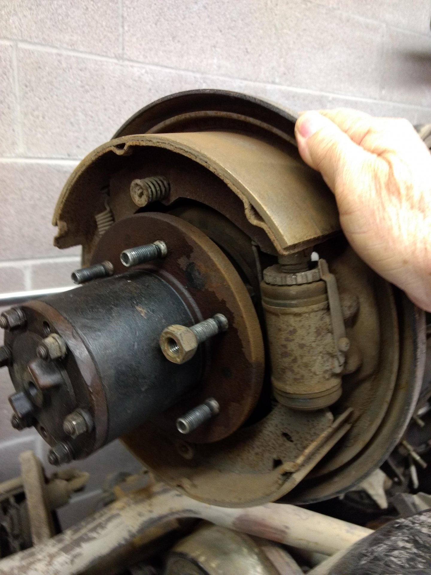

Generally not in Central America. Quickest way to tell is pop the center cover off. Semi floating are flush with the rim. Full floaters sticks out. Not sure if the axle in the lower left can tell it's a FF.
Forgot I had pictures of one I sold a few years back.
View attachment 2670187View attachment 2670189
