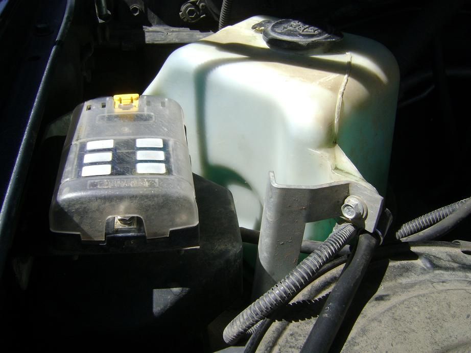

i transferred over the oil separator...i should get a new bowl as it hasn't held up well to brakecleanings, but does catch quite a lot of crap. the snakster also went in, along with the w/w bottle relocation kit, blue sea fuse block and dual battery tray (no battery yet as i'm still using it to move the mm around the yard )

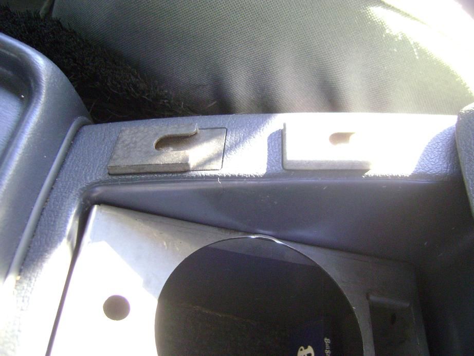

then the painful part...drilling into a clean fender. i didn't have to worry about that with the mm as it was already done. it was very daunting...i taped on the pattern...hesitated....swapped over the rear hatch struts so the hatch would open stupid fast and high and swapped over the chunk of seatbelt so midget me could reach to close it...then i broke out the jigsaw....

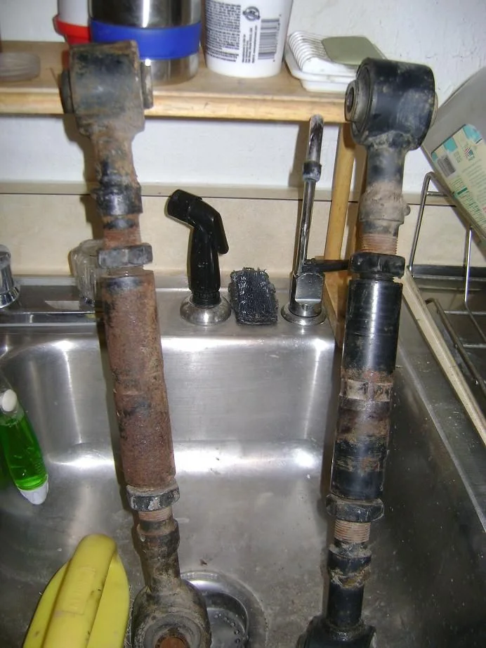

i had adjustable rear uppers that i had tried my best to protect by encasing them in an old motorcycle innertube and that seemed to help a bunch...on the one that didn't come uncinched. :rolleyes: (don't judge my evil welds)
actually i managed to get all except one end loose on both...cleaned them up, re-antiseized them and installed on fat bastard with the innertubes again ziptied on. now that the rig was tall enough for me to fit under, i also swapped the stock "skid plate" with my ipor plate, put in the old blocks for the front sway bar that came off the mm so long ago and the new slee rear sway bar brackets

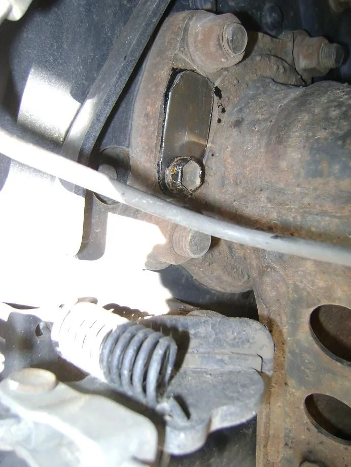

ih8abs, so while under their, i yanked all the rear stuff and blocked off the holes. the lines and valve will come out soon. i also burned through about 4 sawzall blades cutting the rear track bar bracket out and bought a new front adjuster kit since the front track bar on the mm isn't going anywhere soon. and the part time was always one step away on the mm and now it is the same on fat bastard....tcase is all that's left before it's part time. that hopefully will be this summer.
