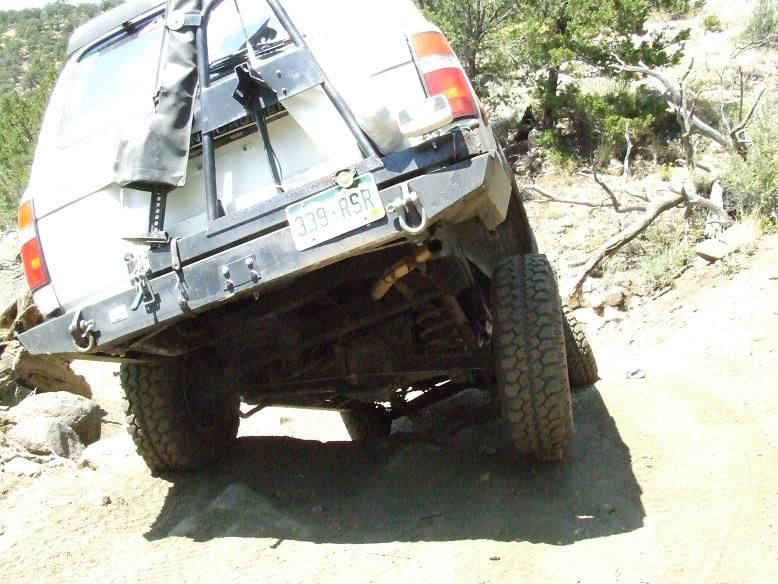

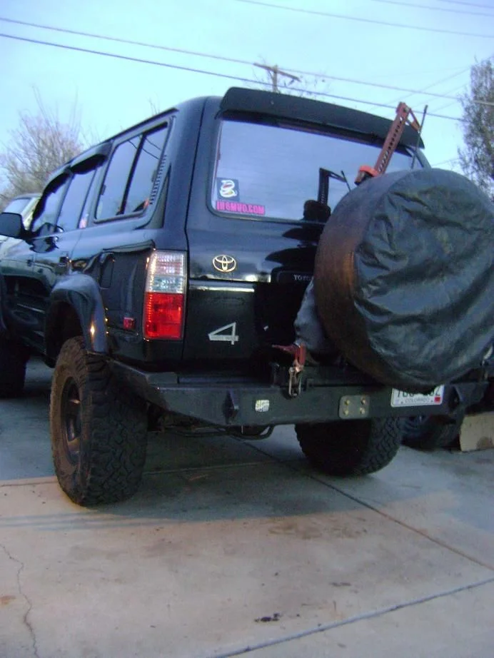

today, i almost finished the rear bumper/tire carrier swap over. need to clean the lower threads on the frame and wire the license plate lamp (was in the middle of that when the neighbor brought over three plates of food for me...now i'm just going to lay on the couch for a bit ;)

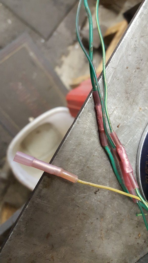

i had already found a hinky p.o. fix on the rear locker harness, but i figured now was as good a time as any to actually fix it.

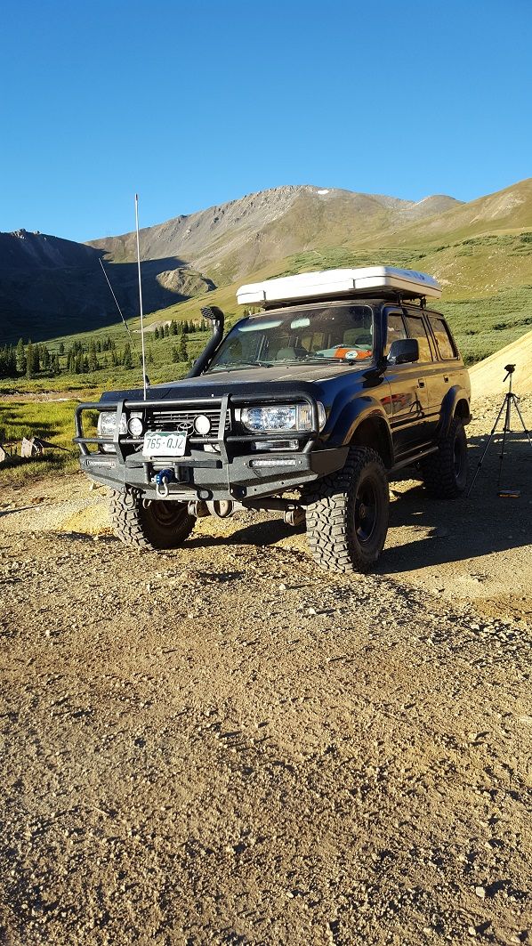

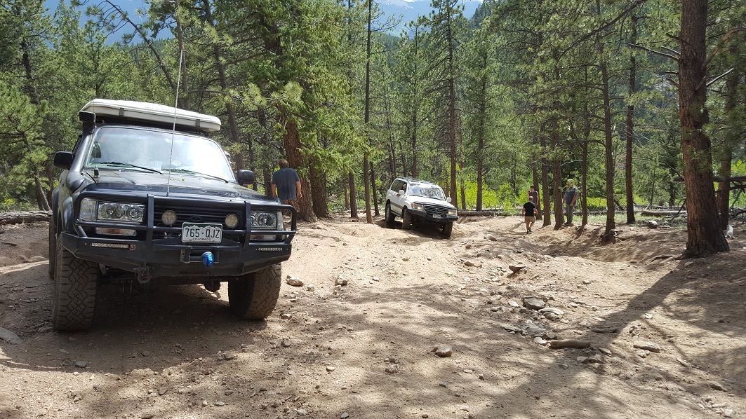

i'm only posting one picture from each different trail and as mentioned, there were a few trips i took no picures. ;) a lot of trips were truly epic ones! if we don't do this for the great memories, what are we doing it for?
