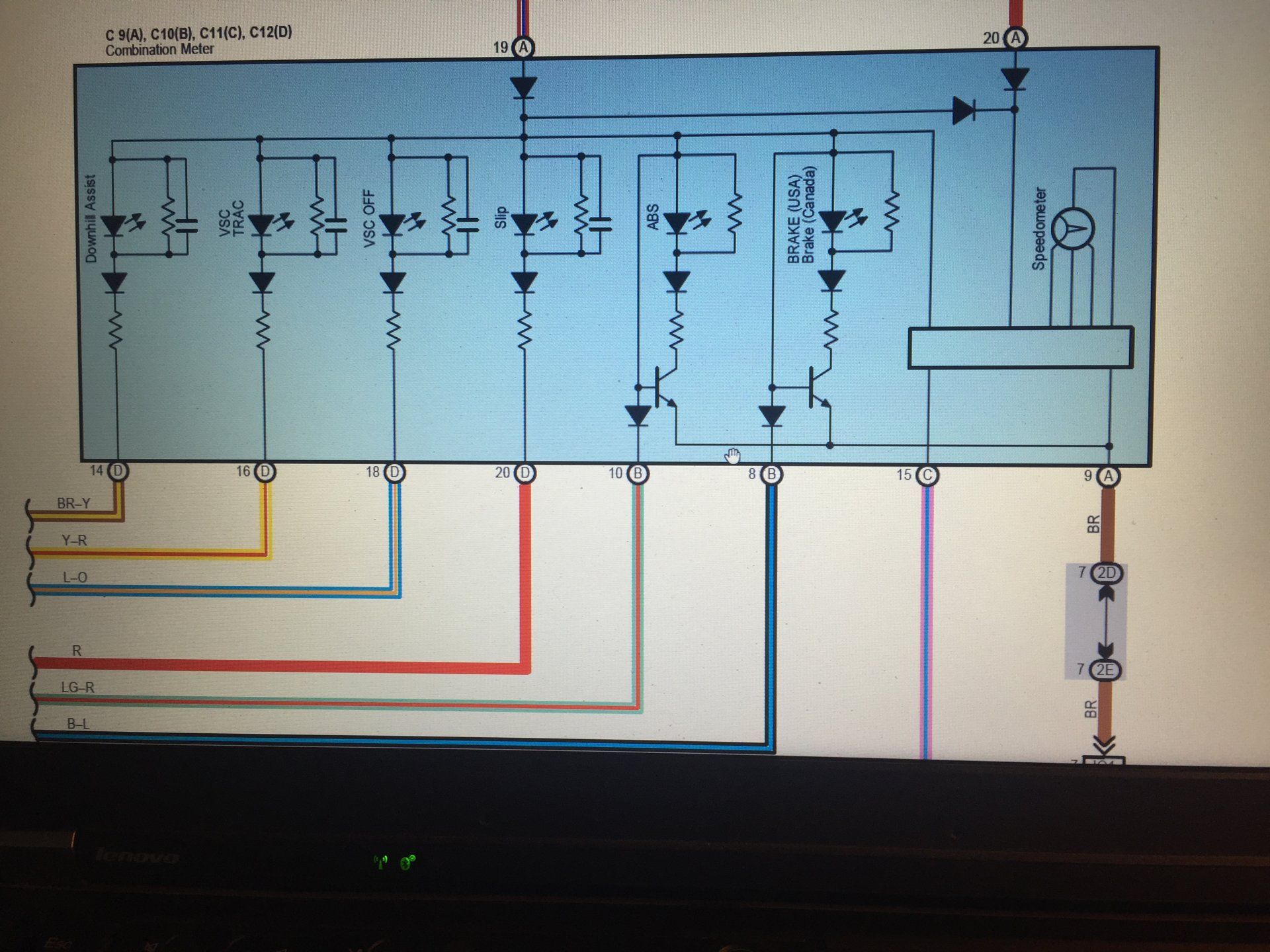

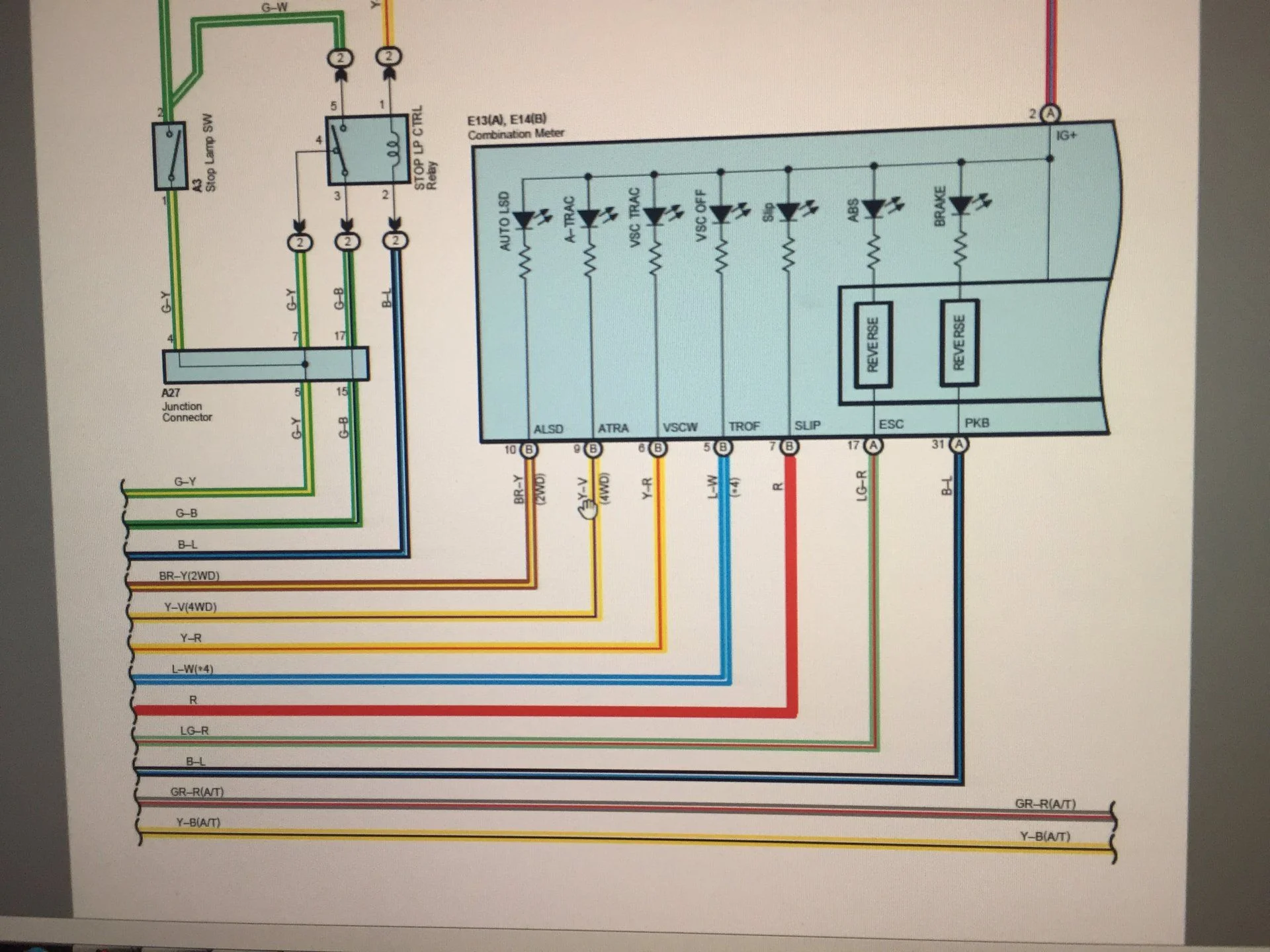

Was doing a side by comparison on electrical diagrams today of the GX and FJC. Need to see if the GX has an unused connector that can be utilized for ATRAC though.
FJC
GX

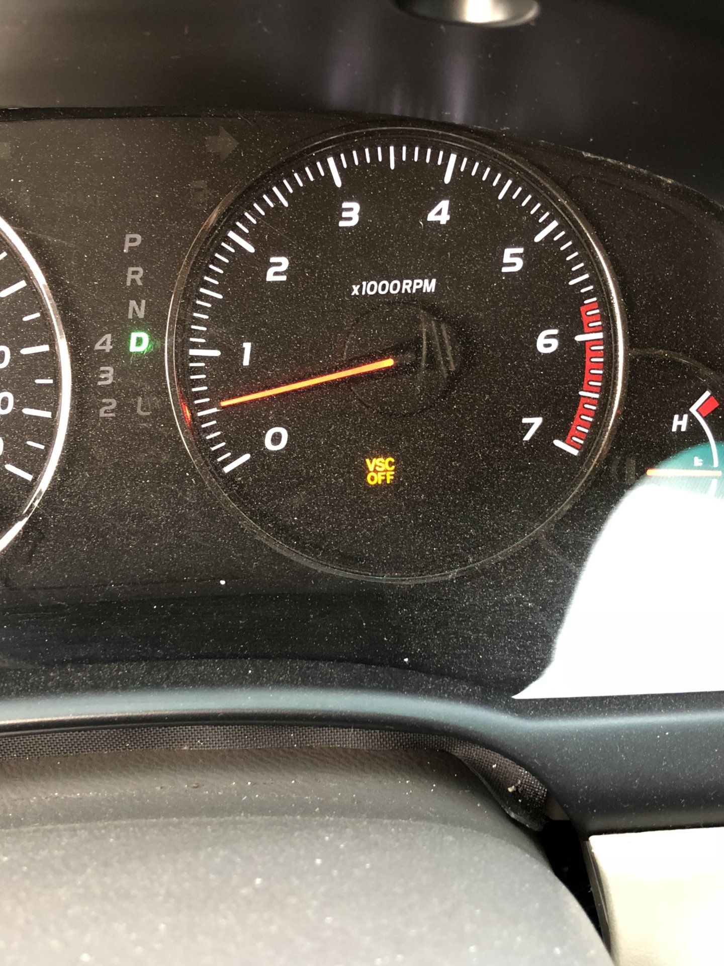

Disconnecting pin 7 causes the VSC TRAC, VSC OFF, and Slip indicator lights to all come on and stay on. Returning continuity does not make the lights go out, you must cycle on/off for all those light to go out. The VSC TRAC light being on constant indicates potential problems somewhere in the following systems:

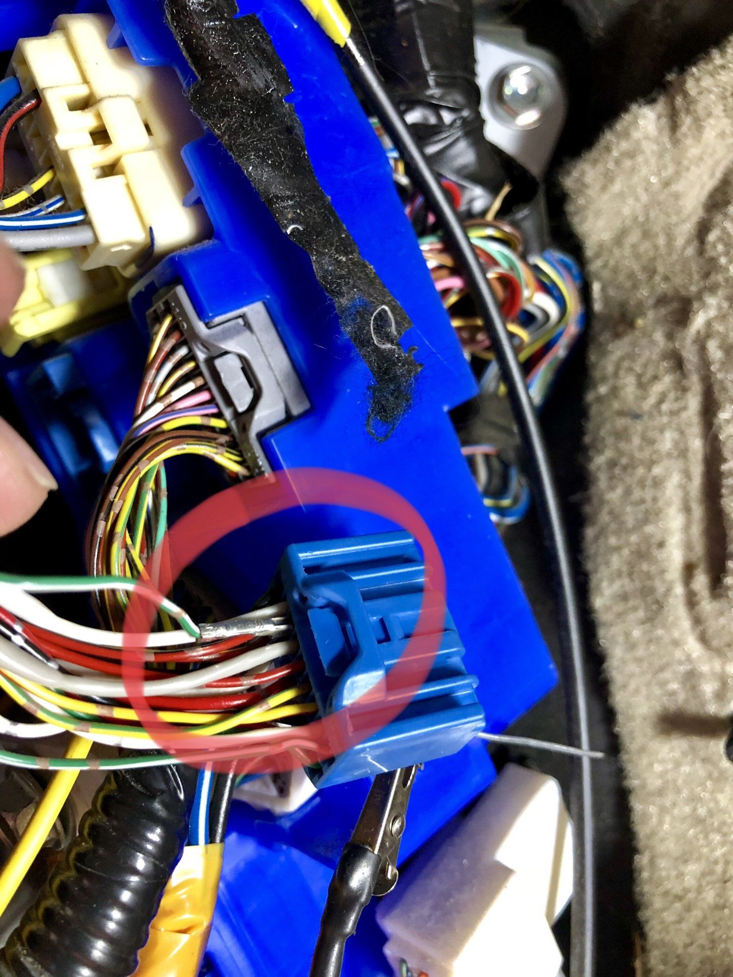

First of all, I want to thank Cringe, Augie and others in this thread for the preliminary work. The connector is located behind the drivers kick panel and is shown below.
This picture below shows the connector taken apart and the location of pin 7 partially removed. Note that there are 2 green with white stripe wires, the other is pin 1 and goes to the instrument cluster. I removed the pin for testing purposes. You can either cut it or use clips to make the necessary connections for this mod. For the remainder of the description I will refer to the part of the terminal that remains in place as the ECU side. The part in your hand is the CDL side.

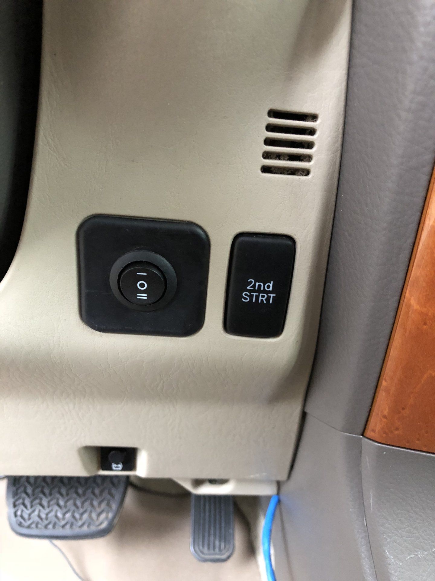

I used a single pole double throw switch (SPDT). Search and you will find a bunch of them everywhere. They may be described as a ON-OFF-ON switch. If you see it described like this (ON) it likely means it is a momentary switch and you do not want that. The one I got just happened to be one of the first that came up on a Google search. You can find it on Amazon https://www.amazon.com/gp/product/B001TQMU5C/?tag=ihco-20
The center switch position is OFF, meaning there will be an open circuit and all Nannies will be off and an error code will be given to the computer. It will require moving the switch to one of the ON positions and one key cycle to clear the code. Both the ON switch positions will either be up or down relative to the center position. Depending on how you wire it one ON position will be what I will call “Normal” mode and the other ON position will be VSC off. The pin 7 wire that goes to the ECU will be the one you attach to the center lug on the back of the switch, this is the connection that matters the most. Connect a good ground to one of the end lugs and connect the CDL side of pin 7 wire to the other end lug. What this does is when you switch to one of the ON positions it closes a circuit to either the CDL side for “Normal” mode or to the Ground and turns off the VSC by sending that ground to the ECU.

This is a three position switch. On my application, push the switch in on the top (single dash) closes the circuit from CDL to the ECU for normal mode. Push the switch in on the bottom (double dash) closes the circuit from ground to the ECU for VSC off mode. Center position is an open circuit causing an error for all Nanny off. To go from normal to VSC off do not pause in the middle, go straight through if that makes sense. You have about 1 second for an open condition before the error codes will get thrown and you will be in all Nanny off mode. It sounds like a short time period but it is actually well within how one would normally flip a switch.
My mod was performed on a 2006. Please use a multi-meter to test your switch function before installing. Just as with any mod here on MUD, use at your own risk.
