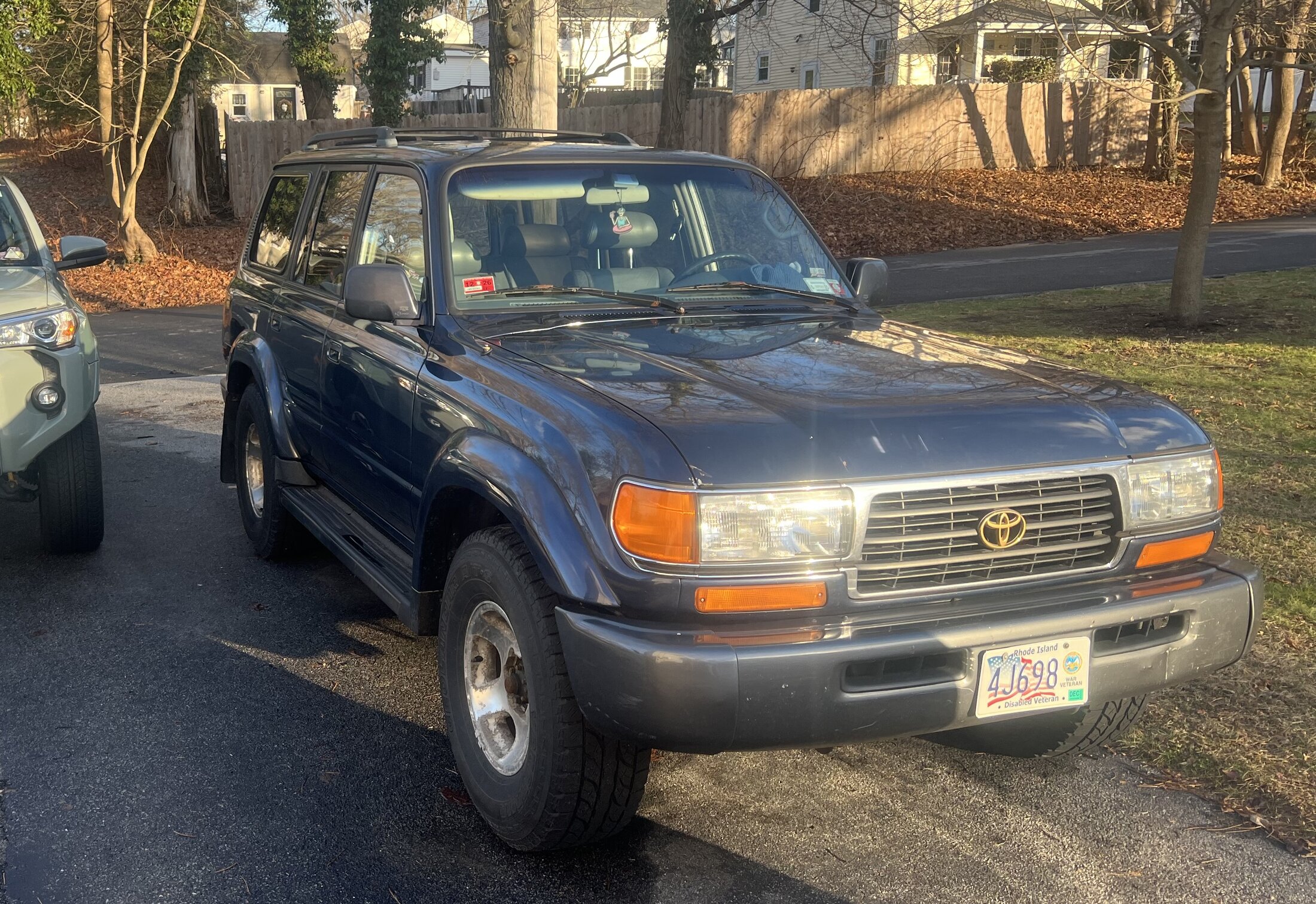

Now, on to the important stuff! My New Land Cruiser! Bought it off Marketplace in November out of New York. Some rust but no soft spots on the frame. Frame is very solid. More on that later. 2 owners. Pretty well taken care of. Good maintenance history. Triple-locked, although I'm kind of wishing it wasn't right now. The rear locker won't engage, but I'll get to that later as well. It drives great! Other than the suspension being shot. The springs and shocks were replaced about 75,000 miles ago with OEM. And the head gasket was replaced about 10,000 miles ago.
I have done EXHAUSTIVE searching on this website. Unfortunately a lot of the info on here is outdated. A lot of the vendors have gone out of vendors, links are bad, etc., so if I ask questions that have been asked before, please excuse me, but the answers may no longer actually be relevant.
The good:
  • Engine runs great
  • Windows work
  • Sunroof works, doesn't leak
  • No rust holes
  • No body rust
The bad:
  • Need to do a rust clean-up. I've read into the deep dives and understand this is probably a futile effort. I'm going to do the best I can without killing myself on this. The transmission cross-member looks really bad, as does the rear cross-member. I plan to chop the rear cross-member off to do a high clearance bumper. That solves that problem. The transmission crossmember may be a candidate for removal. We'll see once I get the thing on stands how badly I want to do this.
  • 2 check engine codes, ABS and airbag codes:
    • P0401: EGR. Either clean out or delete. Probably delete.
    • P0171: This just popped up yesterday so I haven't done much searching on it, but some of the maintenance I have planned could remedy this (ie fuel filter)
    • ABS Code 32: Left front wheel speed sensor. Will check it out when I pull the wheels. Either clean or replace. I understand it's a magnet and can get all kinds of crud in it. I would like to have a working ABS, but I haven't done a full diagnostic
    • ABS Code 35: open circuit in left front or right rear wheel speed sensor. Thinking this indicates a bad speed sensor in the front left. Will find out.
    • Airbag code 31: airbag sensor assembly malfunction. I need to dig into this one. I may actually just take it to Toyota to diagnose because I don't want to mess with airbags, and the price of an OEM sensor isn't too bad to just swap it out.
  • Cruise Control doesn't work. Haven't done diagnostic yet, I do have the FSM.
  • Oil Pressure Gauge has stopped moving. It stays at the bottom. It worked when I first got the car. Did an oil change with 10w40 dinosaur oil, like the previous owner used, and now the sensor stopped moving. Oil level is good. Have done many searches on MUD on this, and most people say this is a gauge issue, but I have an oil pressure gauge coming from Amazon today and I'll get to the bottom of it and find out if I'm within spec or not. Also sending off a sample to Blackstone next week.
