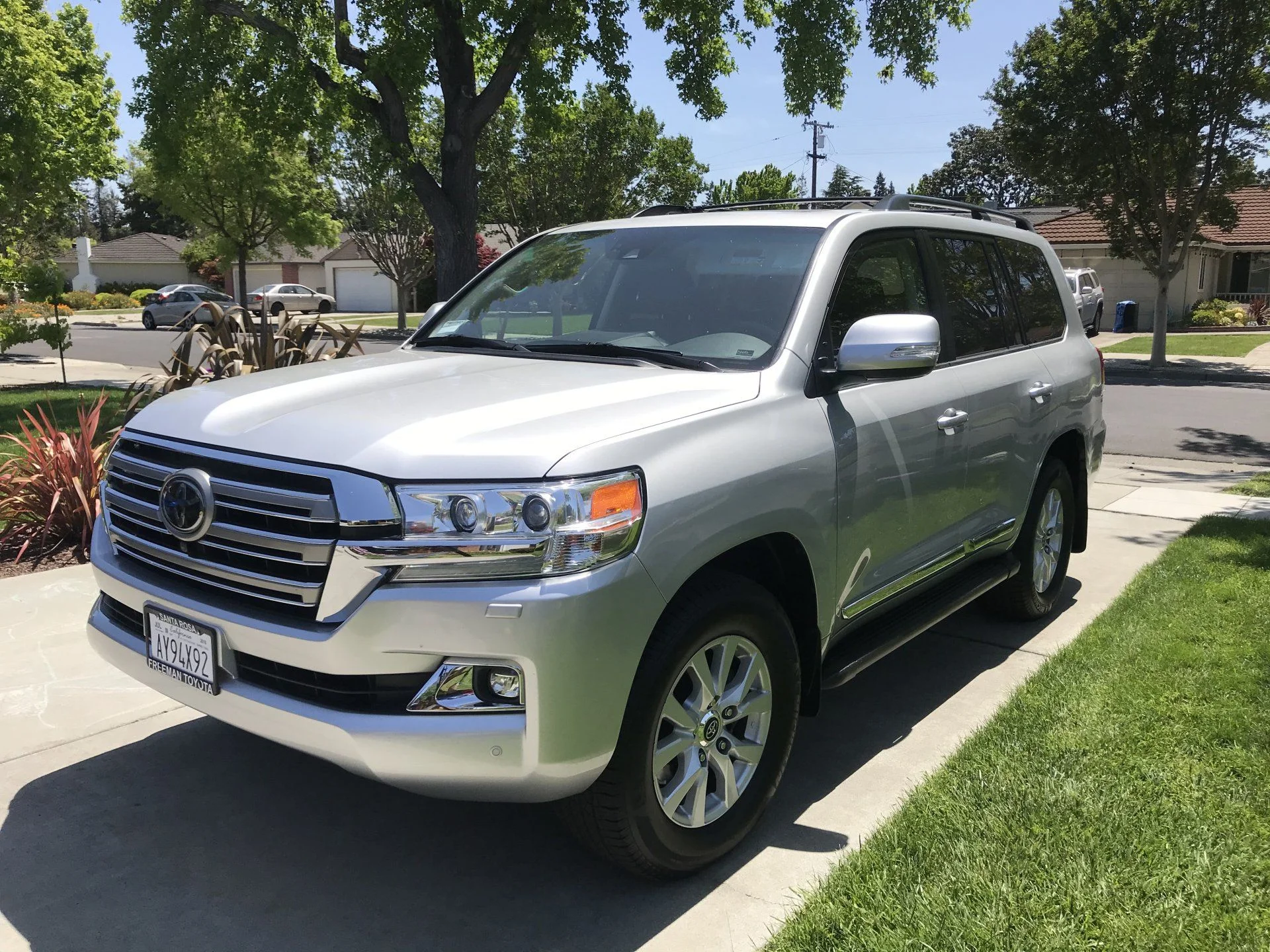

Hi all, after lurking and voraciously consuming all the amazing content in these forums I'm taking the plunge to do my first forum post as what I hope turns out to be a build thread :poof:
While new to MUD I'm not new to overlanding, having traveled a lot of Africa in an old Series iii 109 Landrover with a straight 4 cyl. 2L engine and manual transmission that I reconditioned and made expedition ready with long range fuel tanks, water tank, custom roof rack, RTT etc back in 2001 with my girlfriend wife. All this crazy virus talk has resurfaced our adventure urge to get out and see what others seldom do and share it with our kids.
Many spreadsheets, internet searches and emails later I'm now back in the 4x4 overland game again with a 2016 LC200 CPO I picked up for a reasonable deal with 60k which has lived all its life in California in the Sacramento area with light use and solid service history. Would have loved an Australian spec V8 diesel but the petrol is not a bad second. And for those that haven't noticed I'm now an official Landrover to Toyota convert (what took me so long ;)
My needs: I have a family of 4, a large 90lb dog, a ton of camping equipment and a love of outdoors. While I've love to build a "rock lander" I doubt I'll be doing too much rock crawling in Moab and at most will be doing some light crawling in the Eastern Sierras and will otherwise be focused on true expedition style overlanding with the family - the more remote the better but also just making good use of BLM land and other hidden gems in state parks. I love the idea of stealthy potential; a balanced mix of DD and ready-go expedition vehicle - not an easy place to get and therein is the challenge fun.
There are some really cool build posts and I have to constantly throttle my inner geek when I see color coded Australian front bumpers or custom storage builds and I'm channeling all my observations into a spreadsheet to tame the complexity as it seems like a lot to take on when coming in cold. First up will be tires, I'm leaning towards the 285/70/18 RG on my stock 16 wheels as I've seen one popular person do without needing to trim. Next up will be to increase the load capability with a suspension upgrade. Trip planning will refine my next steps after that; I can see LRA, TrekBoxx, Dissent/Slee on my birthday list but prefer the form follows function approach.
This build thread is really my effort to give back and help others like me but I'll be taking my time so don't expect zero to hero build antics since I'm a regular Joe balancing work/family obligations and not (yet) a sponsored YouTube sensation :)

285/70r18 is nominally 34” and a good match for the truck. You will be trimming and removing some minor items and probably adding a spacer, but yes not major surgery. Probably 20 min per corner in the front or something. My truck doesn’t have kdss so I can’t speak to fitment for that, but otherwise it should go.
Thanks for the feedback - I was hoping not to trim or mess with spacers and have spent a lot of time in the tire size database where I saw the KO2s reported as working on stock vehicle. I also saw @mcgaskins rolling with the RGs on stock from his Ruby build thread which is what intrigued me. Will let you know how it goes
I don’t think you can clear the top uca mount in a tall 285. It might squeak by. If you are on stock 285 you can go out and look. A 34 will be a bit more than an inch to 1 1/2 higher than the current tread.
If you don’t space it your tire angles “scrub radius” will also be off some.

Also k02 run famously small. And front bumpers remove the foreground zone

Thanks for the link @grinchy - just the kind of Saturday night reading I look forward to. A lot of the popular Australian touring builds run 33" which seem close to my needs, got some thinking to do.

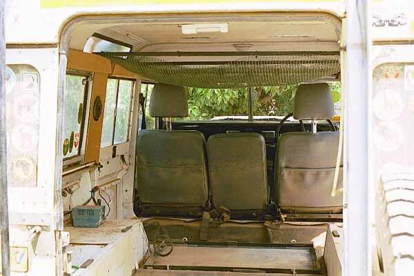

Any pics of the rover?
Too many, don't get me started :) Here are a few glamour shots and one shot showing some of the mods inside for securing the fridge where the 2nd row used to be and the small inverter box on the rear wheel arch where I stored the 2nd battery. I bought the rover from the original owner who had named her "old white lion" and I kept the name. I kept the vehicle stored on a friend's farm long after I left South Africa for the States and eventually sold it to a wildlife photographer who modified the rear passenger doors for camera rigs and she lives in/around the Kruger National Park area.

The rear unpacked showing some of the mods.
