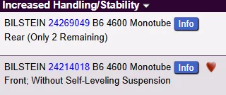

I'm going to go with these. I've used 4600's on my 62 and Tacoma and they were perfect. I'll likely go from the .25" oem spacer to a .5" by Dobinsons and then a .25" coil spring spacer in the rear. A little more height and a tight ride without spending a ton.
I'm also considering replacing all of my control arms with Delphi Loaded units at the same time for a true one and done.
