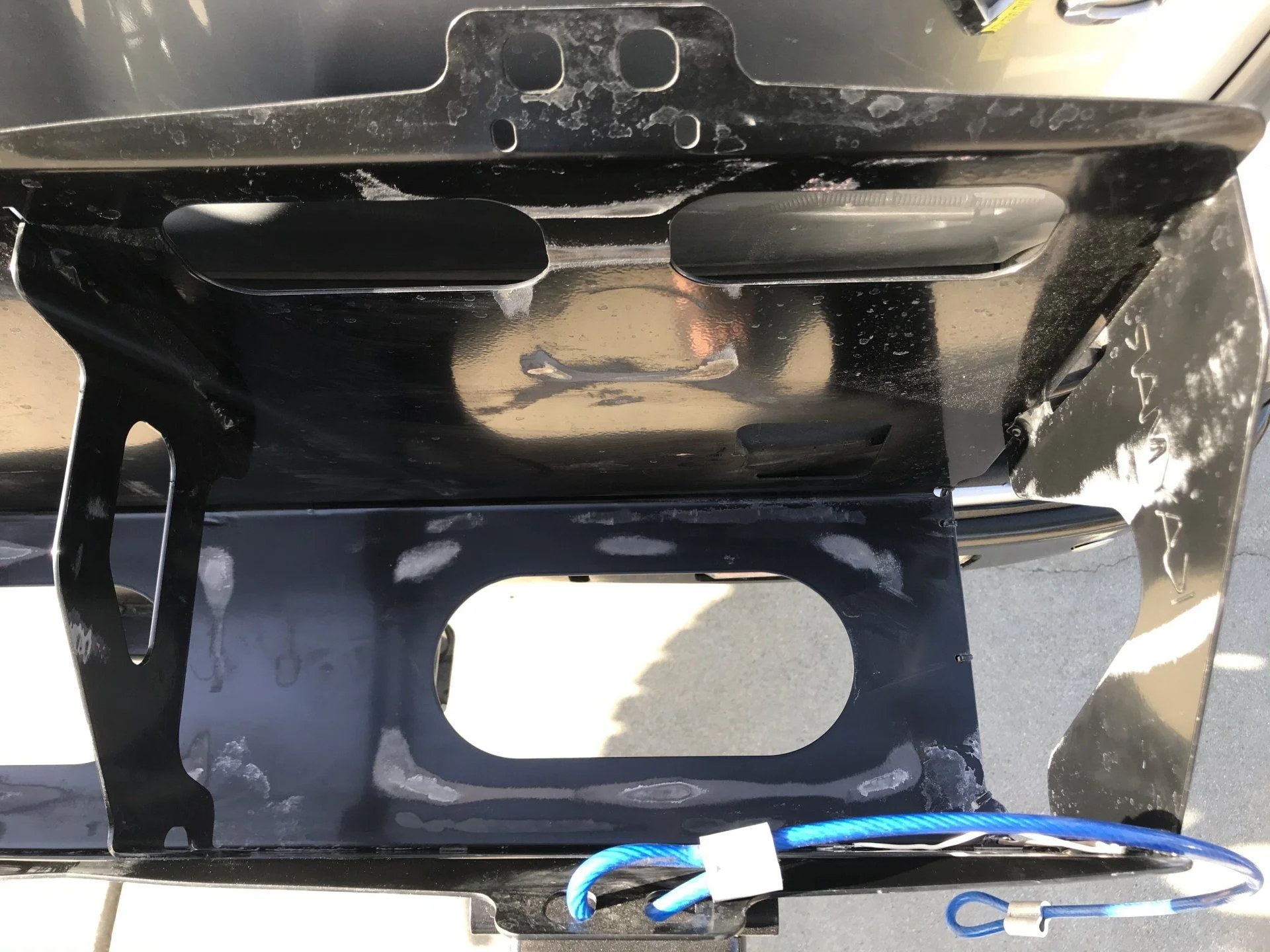

  • Steel jerry cans in my Kaymar were not a tight fit in the carrier and they rattled and wore away the PC on the badly rutted roads

I wonder if for the jerry can mount, you could just run some 3M foam tape around the top and then add a piece of foam on the bottom. Maybe something like a rectangle cutoff from a yoga mat.
Good suggestions thanks, will give that a go for the next time for sure - some photos showing the wear and tear
