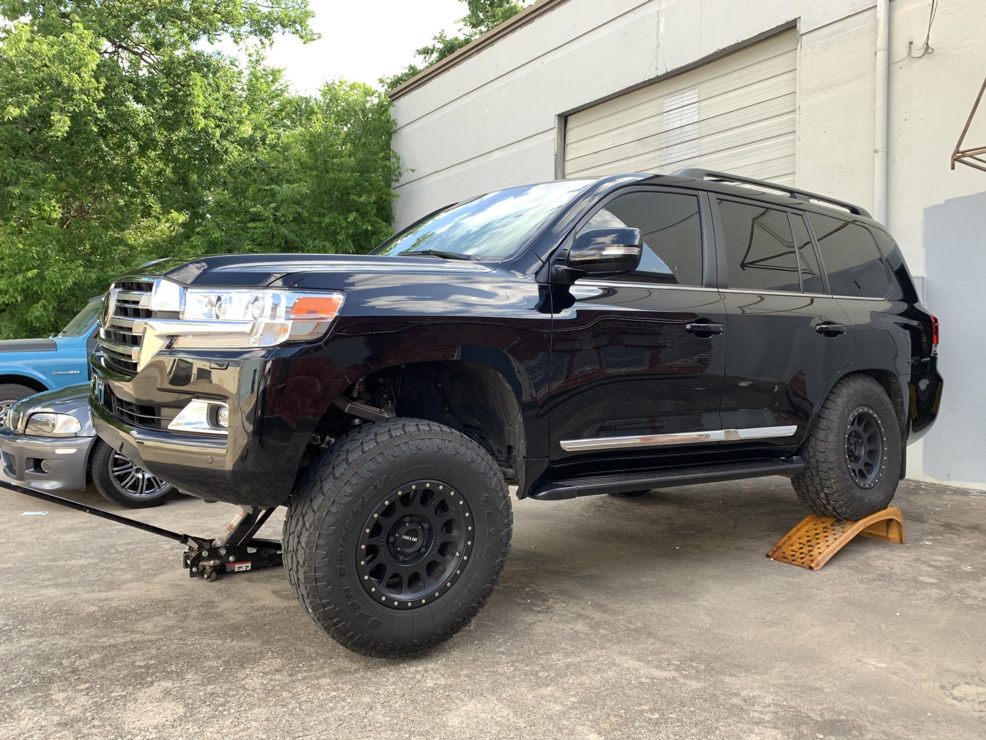

Snapped a couple pics of my new to me 2016 below.

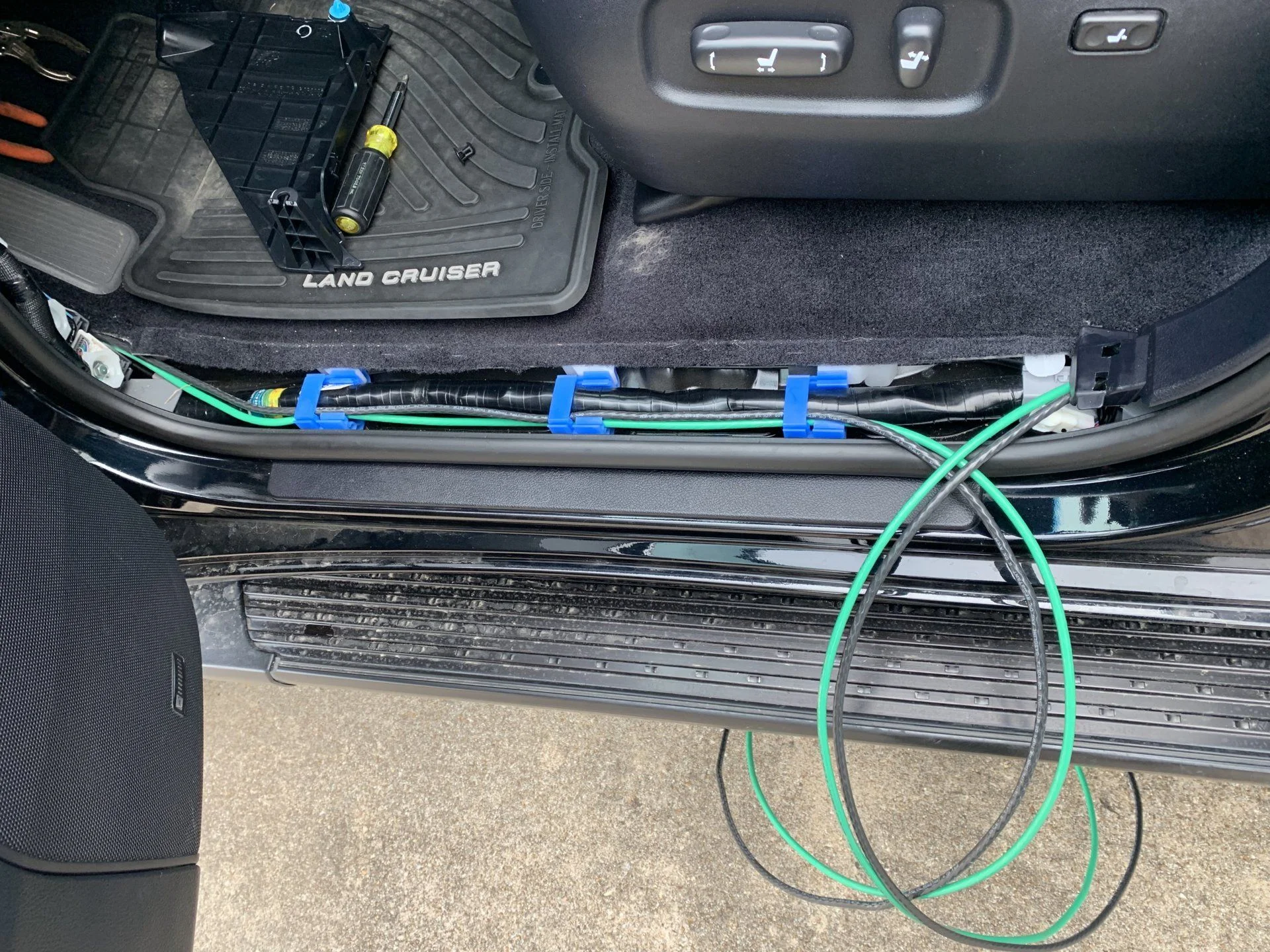

Fridge power - single fused power run to the rear? Portable power? Solar? Dual Battery? Immediate needs will involve 2 to 3 night stays in single locations off grid with only short drives daily. Installed.

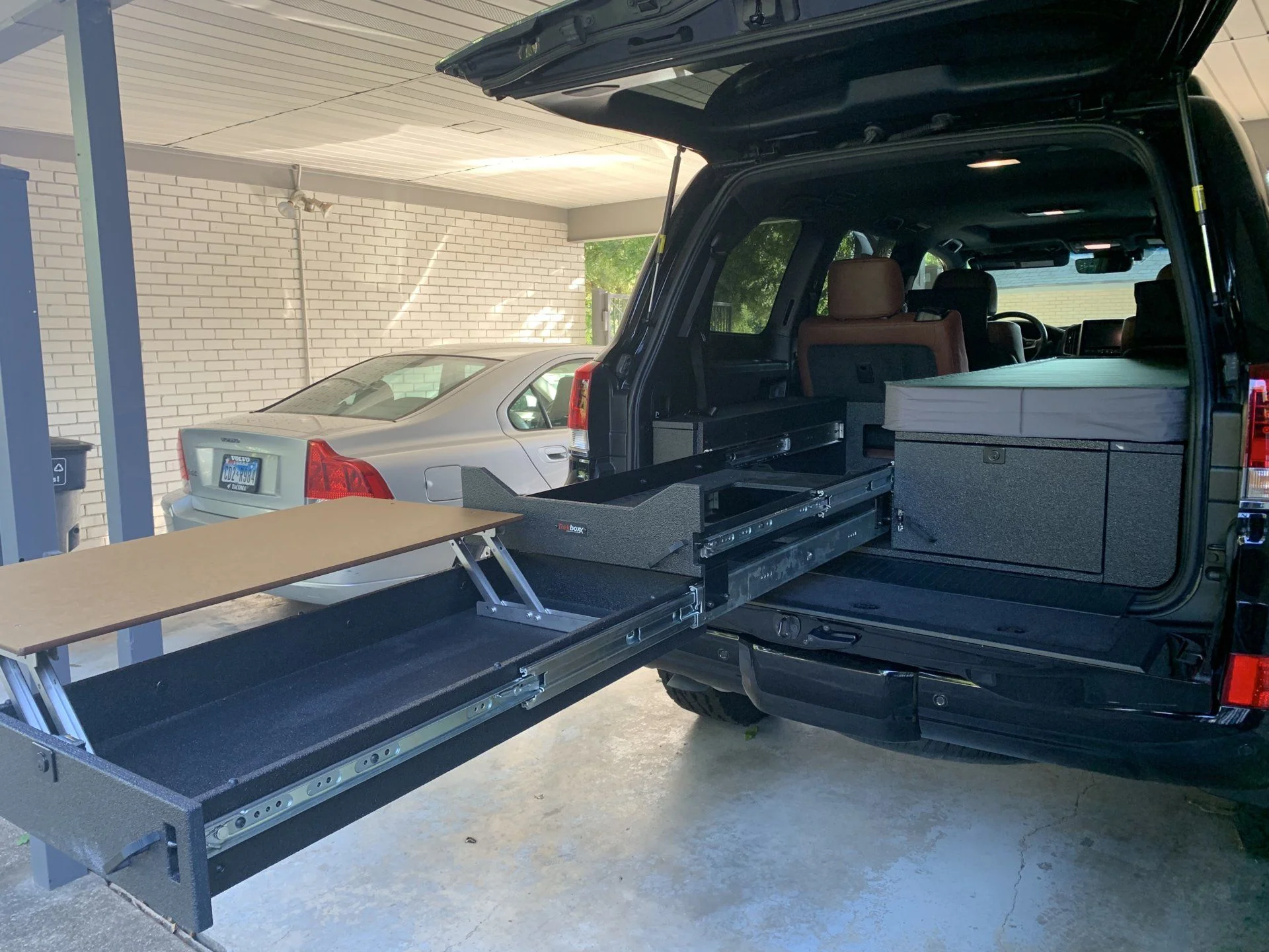

Trekboxx Alpha Drawers - since installed and fantastic
Dometic CFX 75 Fridge - also done and loving it

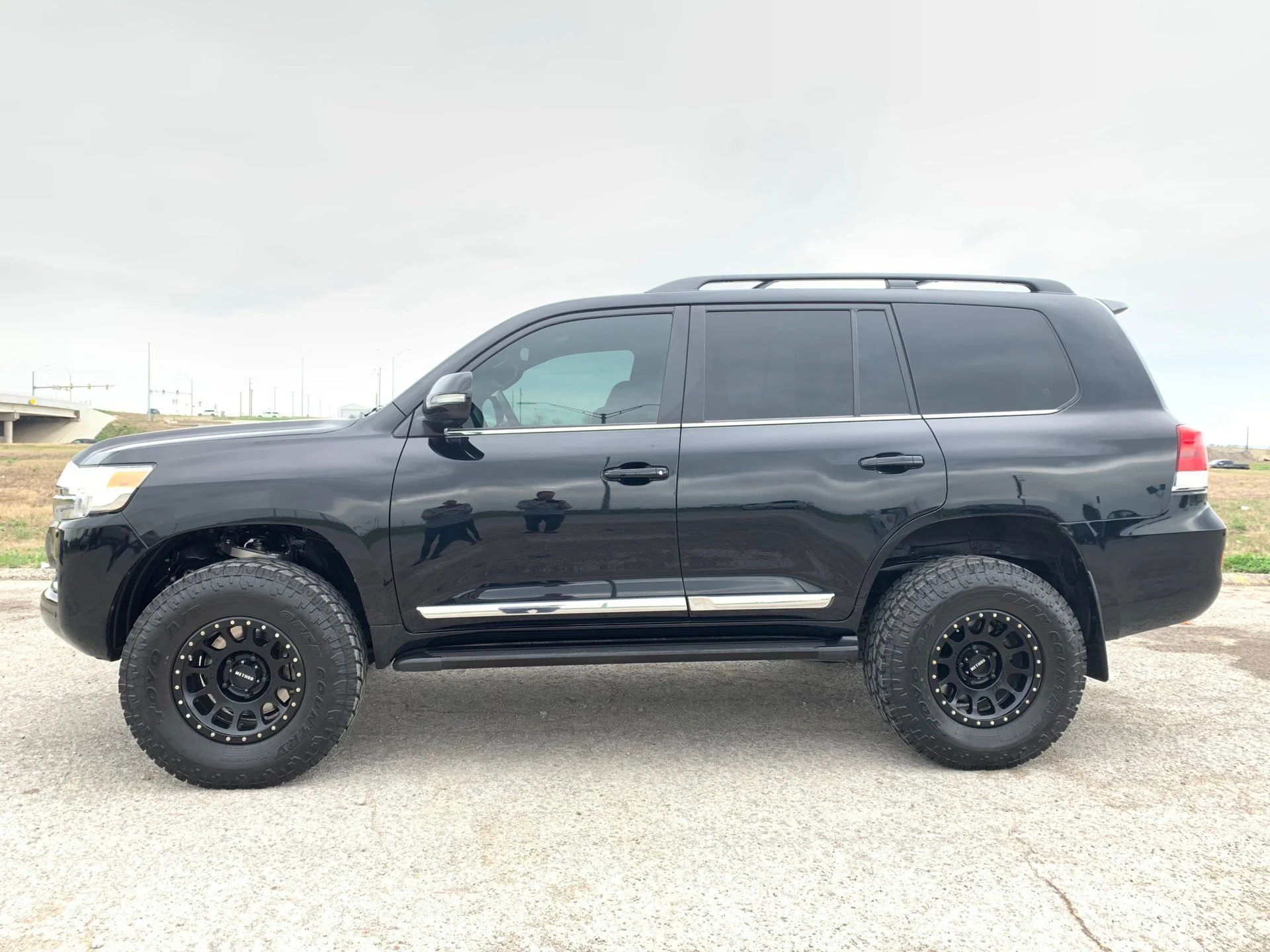

Will those zero offset wheels tuck in the fenders?

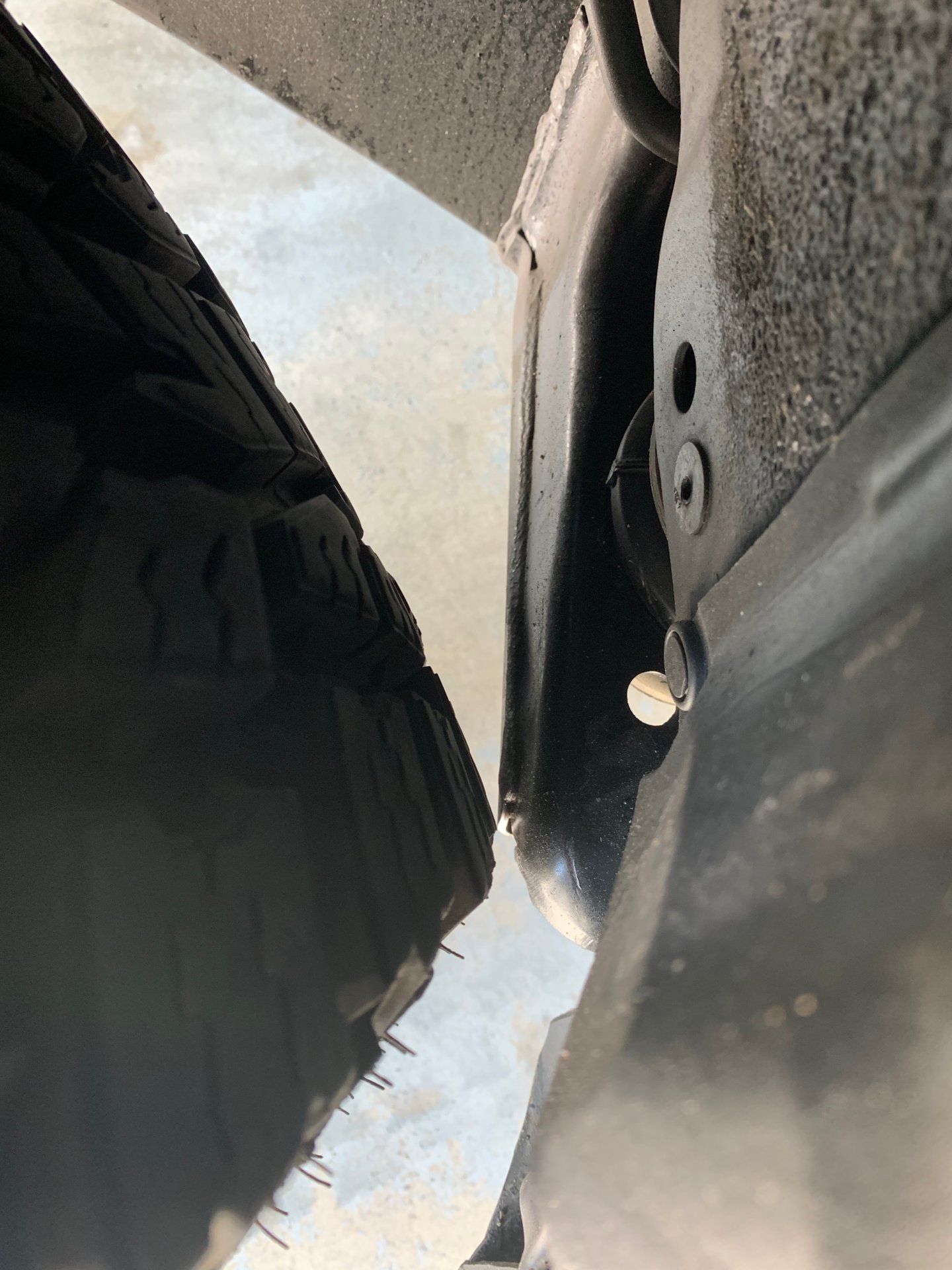

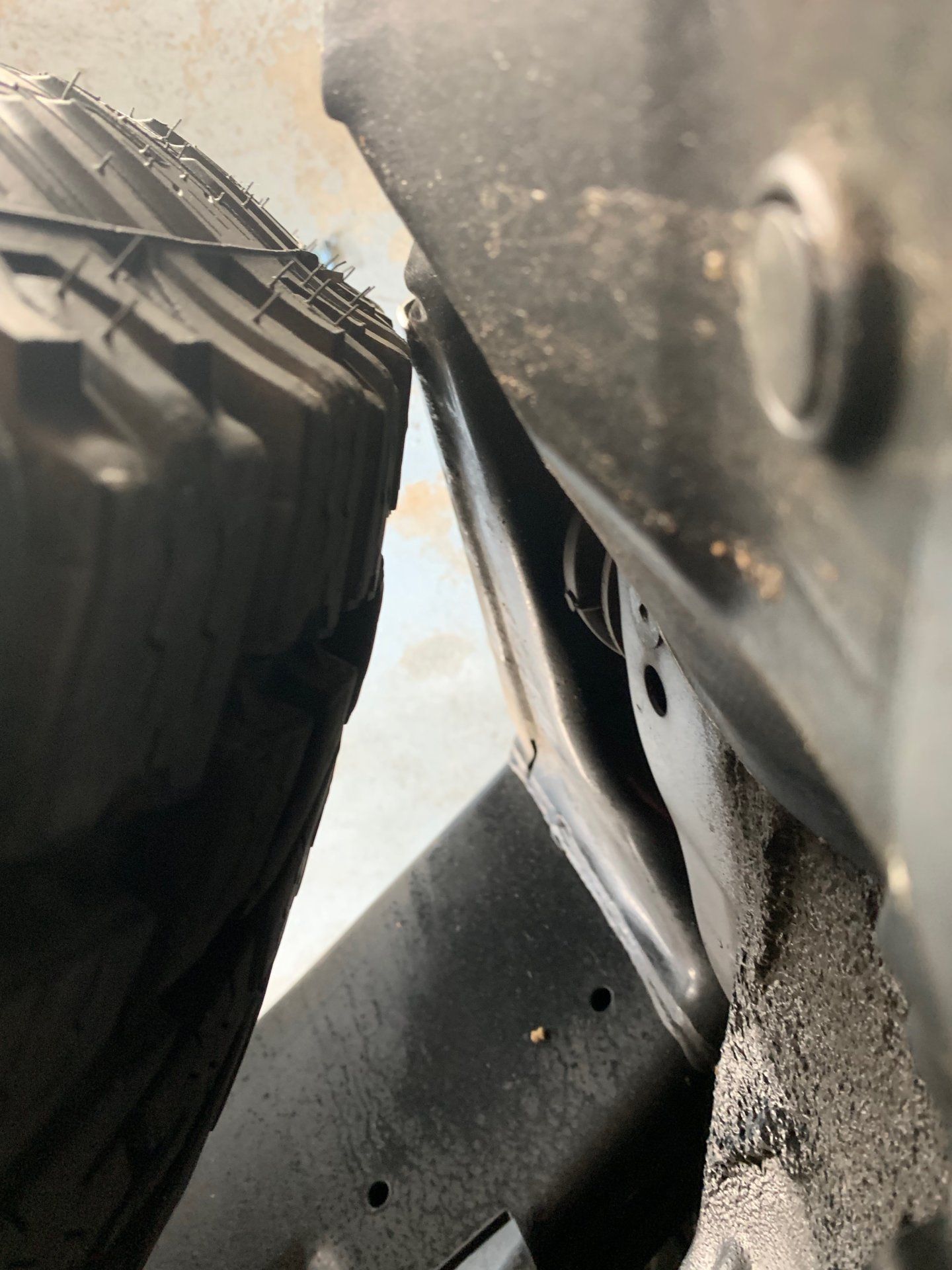

This is a great question, the original owner built this but never took it further than the Neiman Marcus valet from the looks of it. I have slight rubbing in reverse turning situations on the frame directly behind the front tires. There is a folded weld there that rubs the corner of the tire lugs. I'll post up some pictures of that and down the side to see what you think about the offset. All work was done by 4 Wheel Parts in Plano including wheels and tires.
@tbisaacs, two pics of the frame rub. Beyond this the only other contact is some slight polishing of the plastic inner fender in front of both front tires but this is inconsequential, the frame rub on the other hand would be nice to rectify.

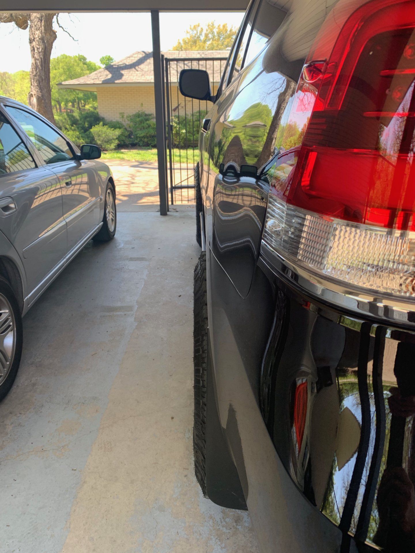

Second two pics are down the side of the truck, not sure if someone can guess if I'll tuck properly running these offsets? My rather uninformed guess is that a 20 or 25 offset wheel would have been perfect, but if these work the stance does look pretty nice.

Thanks, love the pics of your setup as well. No issues other than the very slight frame rub described above and that is only experienced at 3/4 lock in reversing situations. Even then its just the very corner of the outside lugs on the front tires that rub and this could be quite variable depending on the brand/make tire you run and how aggressive and wide the lugs are. These tires at 285/75 are a full 34" off the truck and 33" underweight, I honestly can't think of any reason to go bigger than 34's as they seem to be the largest one would need (within reason) and yet without any real compromises.

Thanks. Ah gotcha, yeah I only had frame rub behind the rocker panel corner behind where the front mud flaps used to be. I'm running 285/70 on stock suspension with the 17x8.5+0.

Yep, that's the area where I have my minor rubbing as well. It's quite minor for others thinking about this setup. I think the 0 offset likely eliminates all the normal rub locations (on KDSS for instance) that most experience with a big tire and introduces this small one. Disappointing I didn't know about the Jamboree last week but thanks for the info on what's happening around DFW, I'll look up the TX Overland group. If you find yourself planing to be over by the TCU/Colonial Golf area of FW shoot me a message I live right by there.

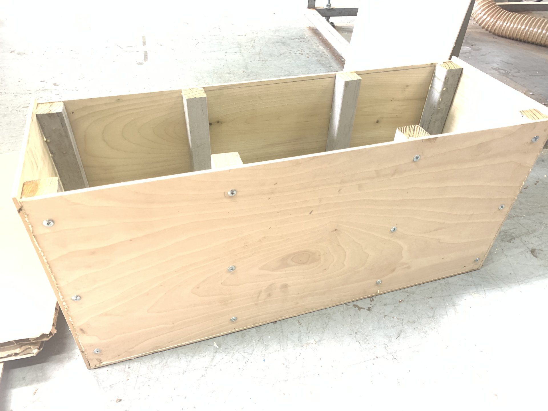

This was back in June but I did remove/rebuild/replace the Icons, this included the building of a wooden crate to send them off to Arizona for the rebuild + new shafts. All in all it wasn't a big deal and turn around on the rebuild was less than a week including shipping time.
Ran power to the rear for the fridge and aux outlets 6ga +/-, a baby could do it.

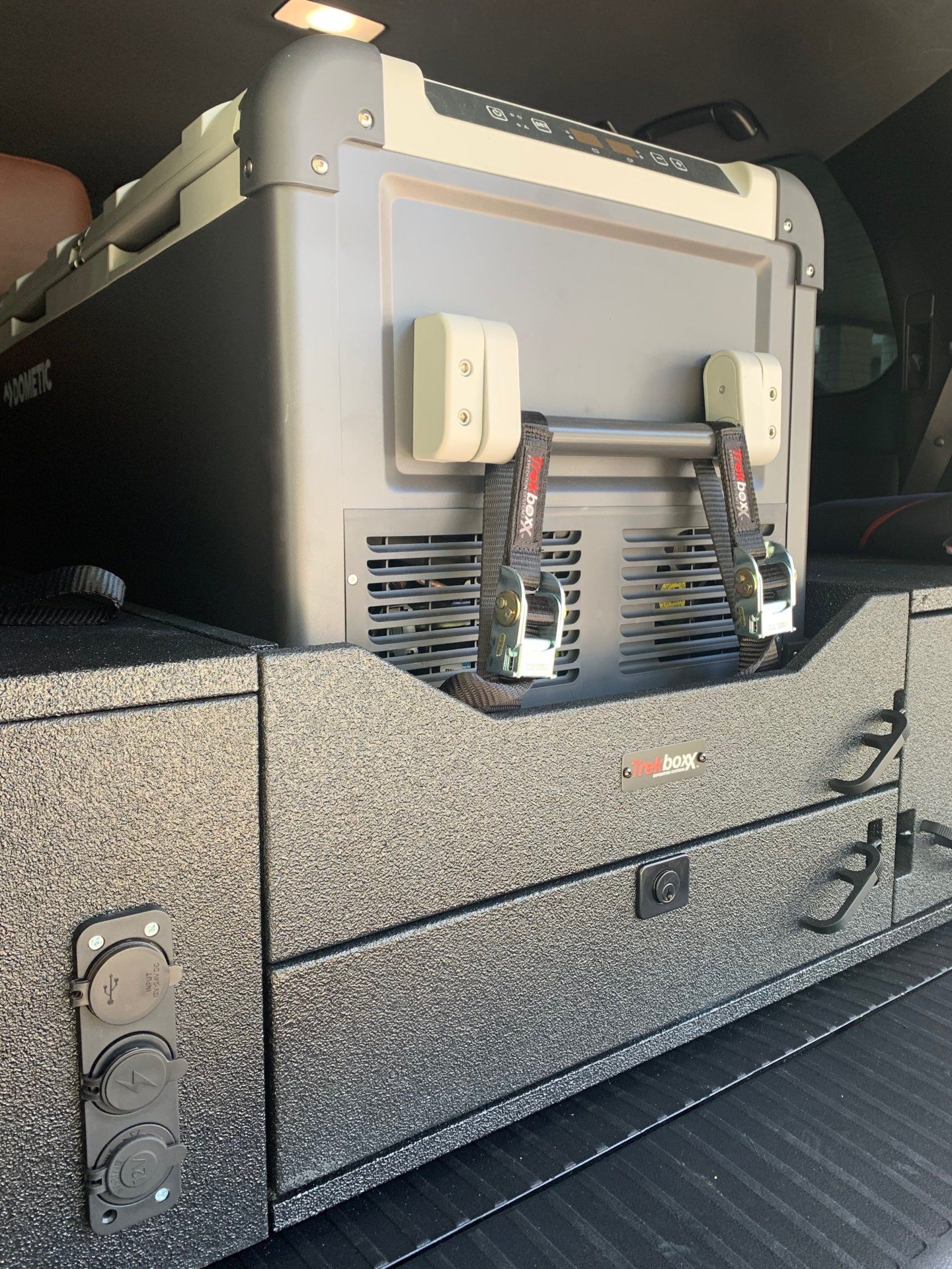

Made my own coiled fridge power cord using the 12v Dometic cord supplied with the unit merged with coiled cord from Amazon so it retracts automatically and doesn't get stuck behind the drawer when pushing the fridge slide back in. Works like a charm.

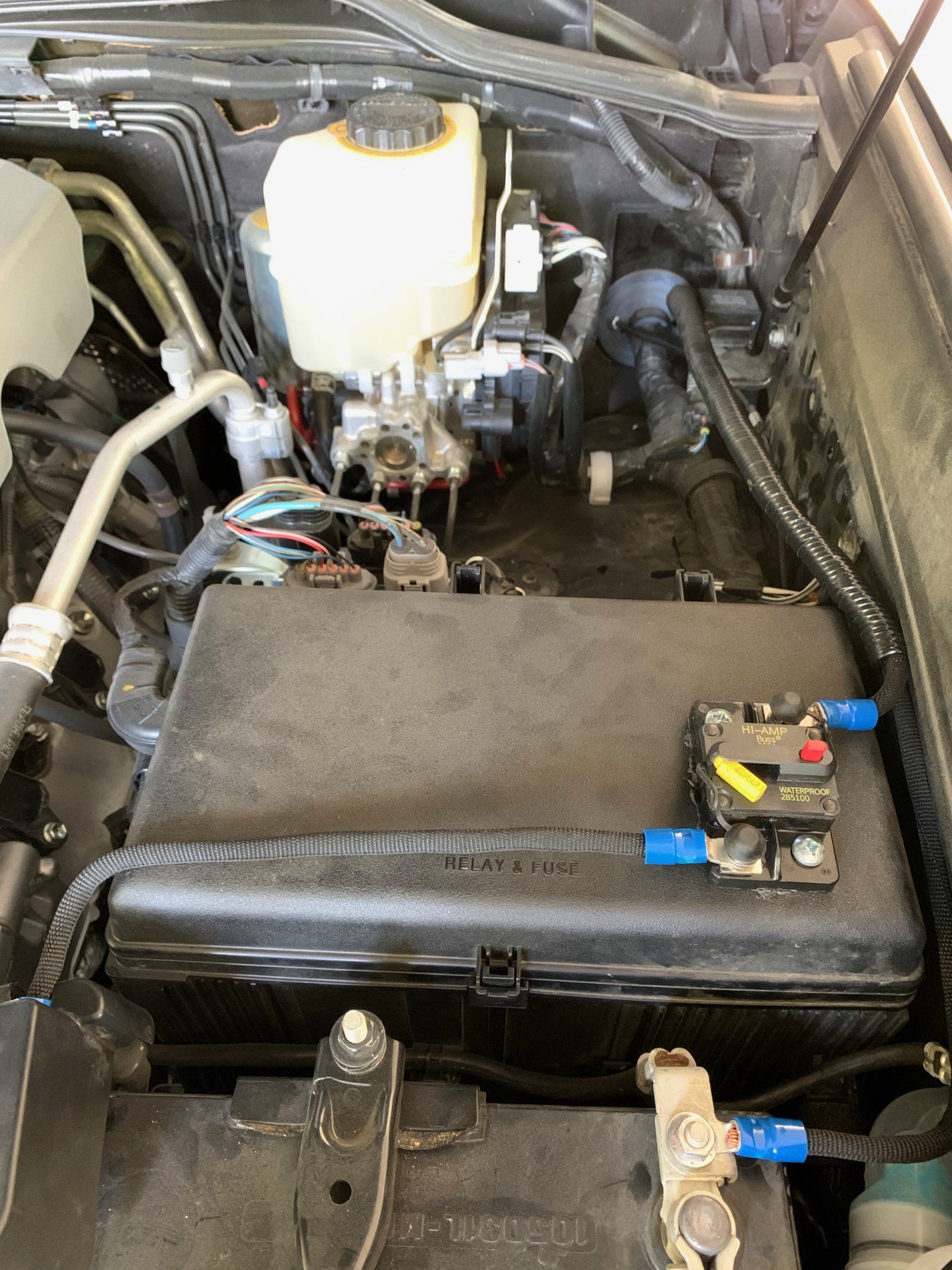

Under hood I did a Blue Sea whole house circuit breaker that kills all non stock electric loads so I can isolate the user installed items if I choose.
Added aux charging ports to the drawer system, USB-C, USB Q3.0, two 45amp Anderson plugs one of which is for the portable 120W Renogy folding solar panel and one for future use. Also a standard 12v outlet just for fun, I need one more screw.... Thats the Dometic CFX 75 and it's a beast fridge freezer dual zone.
