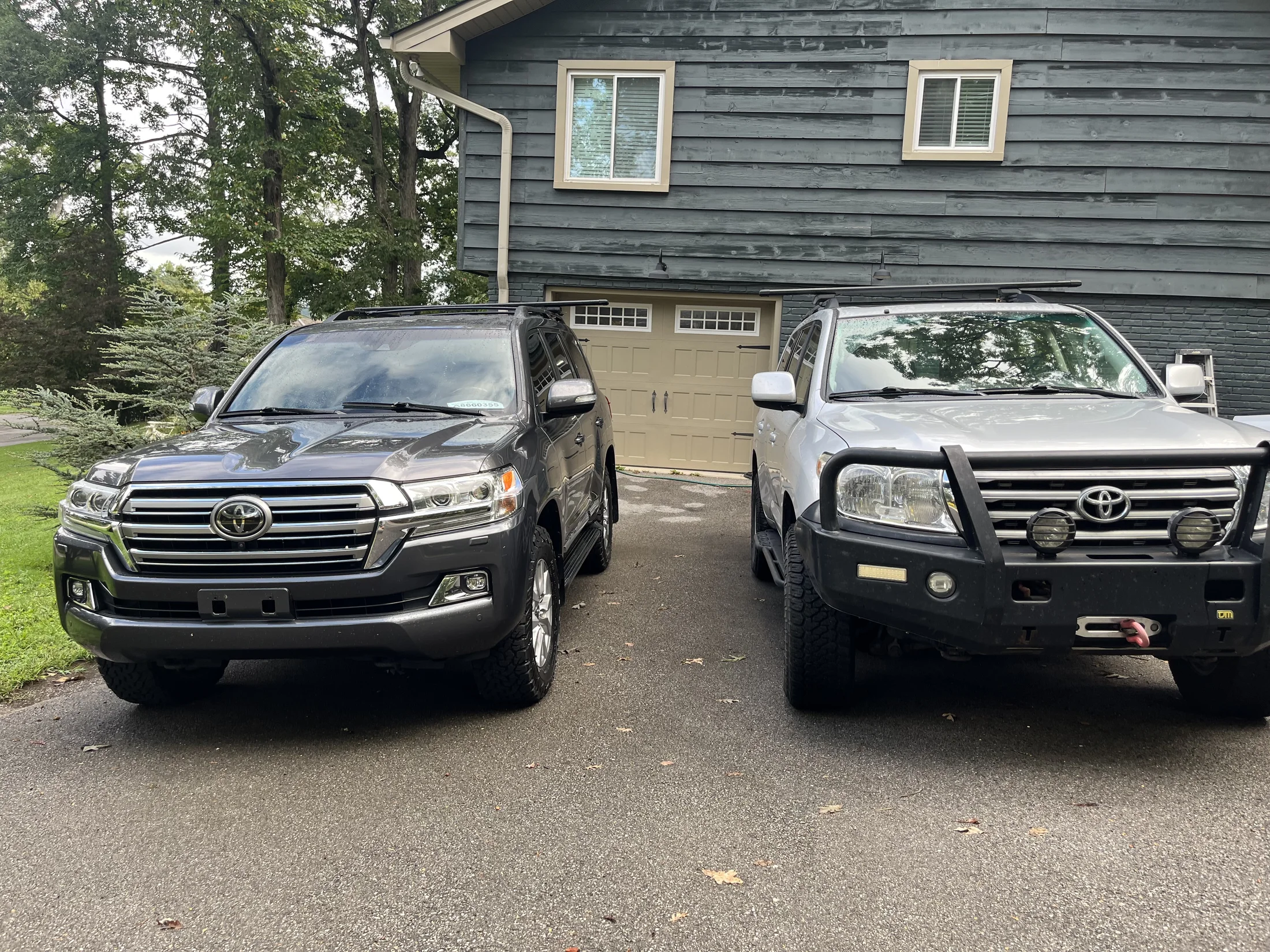

Lined the two up to start swapping stuff over.
First I moved the Yakima Racks and the cargo bin/drawer system over. Then I started to pull the factory skids, grill, and bumper off the new Cruiser. That’s when stuff got weird…
I crawled all under the new cruiser before purchase and everything looked clean, stock, and unmolested. No evidence of any body or suspension work at all. I pulled the splash guard off on the front passenger side and found this…

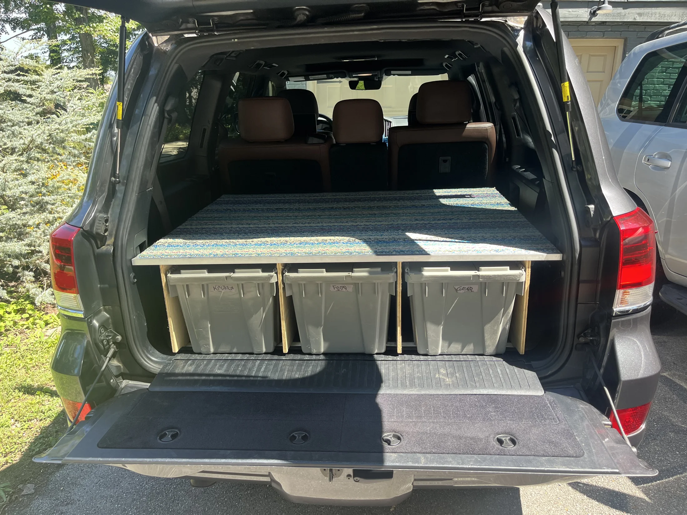

Reposting here for build completeness. The absolute most useful mod in our old cruiser was my poor man’s drawer system. Part of what solidified another 200 series for us was this setup. None of the other options had the depth nor the height in the cargo area for this to quite work
Details here:
Poor Man’s Drawer System
Once the third row was out, this goes in in a few minutes, max.

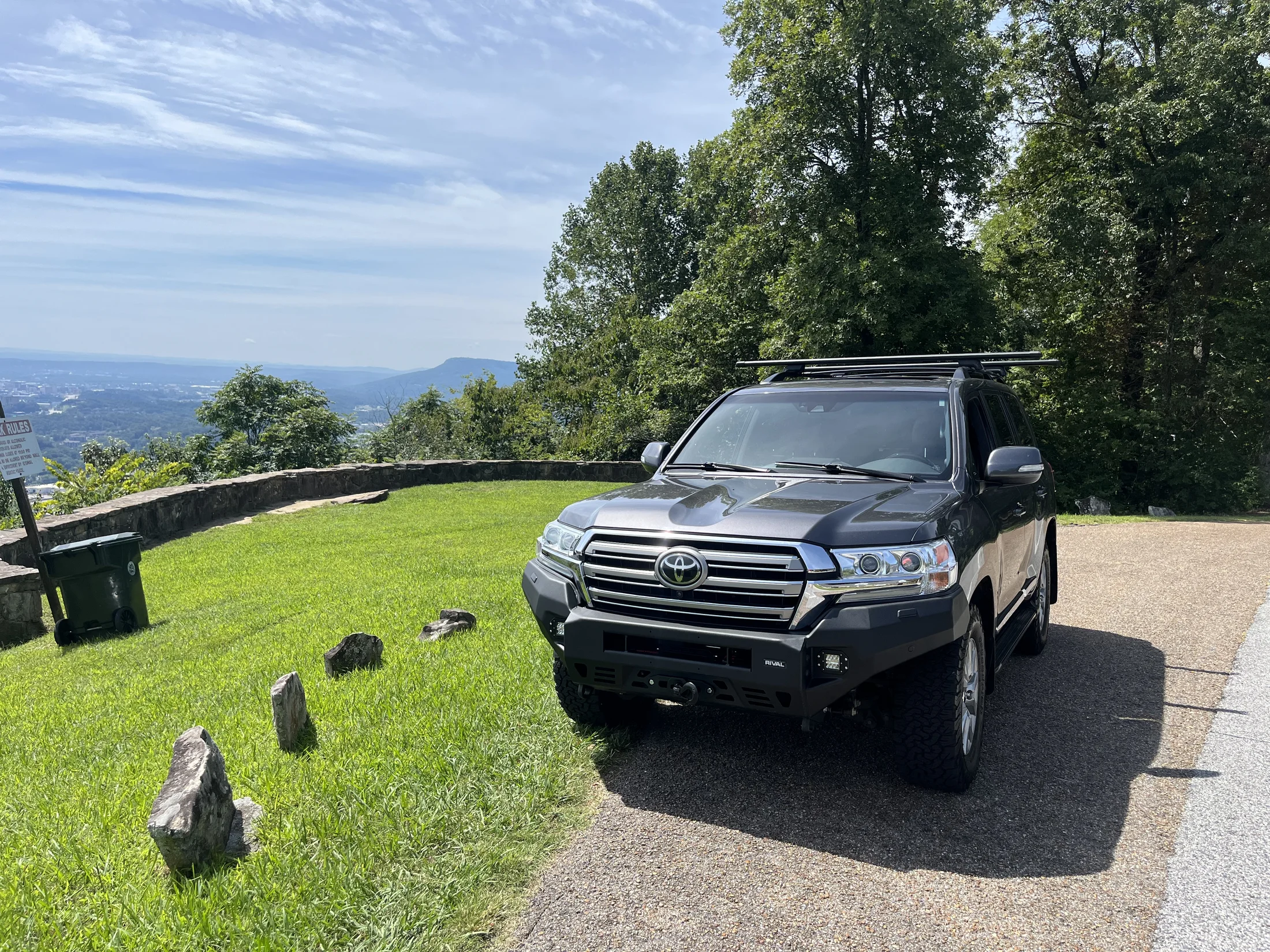

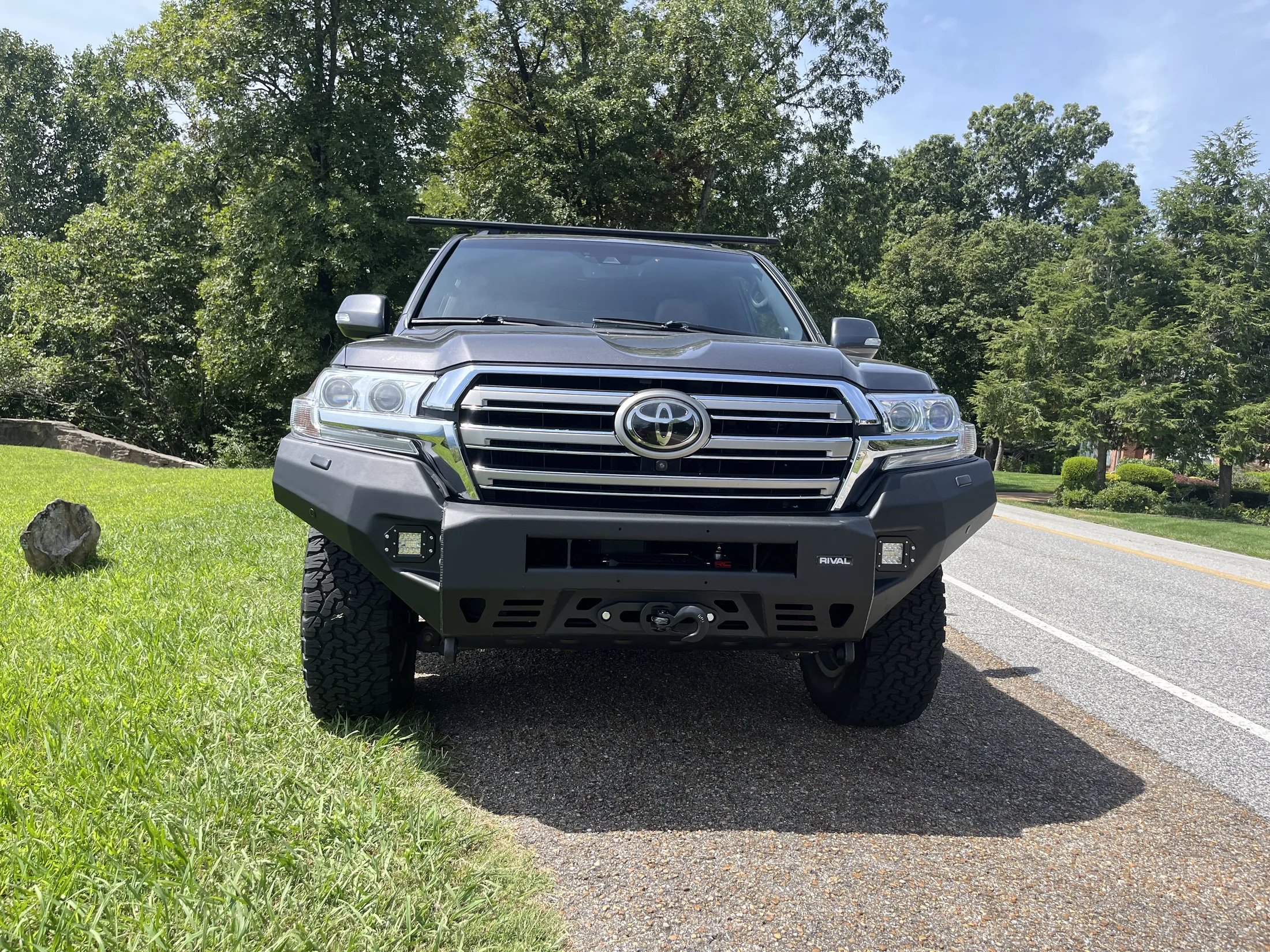

The Rival 4x4 bumper was delivered yesterday and I got it fitted last night and into this morning.
Overall install was about as expected, with some challenges getting it in place and mounted solo. Getting the bumper in place with the trim gasket in place was really difficult, so I removed the gasket and re-installed after all four bolts on each side were loosely in place.
I think it looks good and a bit lower profile than the TJM T13 on the old truck. Most of the pics I could find are either color matched or significantly more built than this one so I was pleasantly surprised at how it looked on a fairly stock truck.

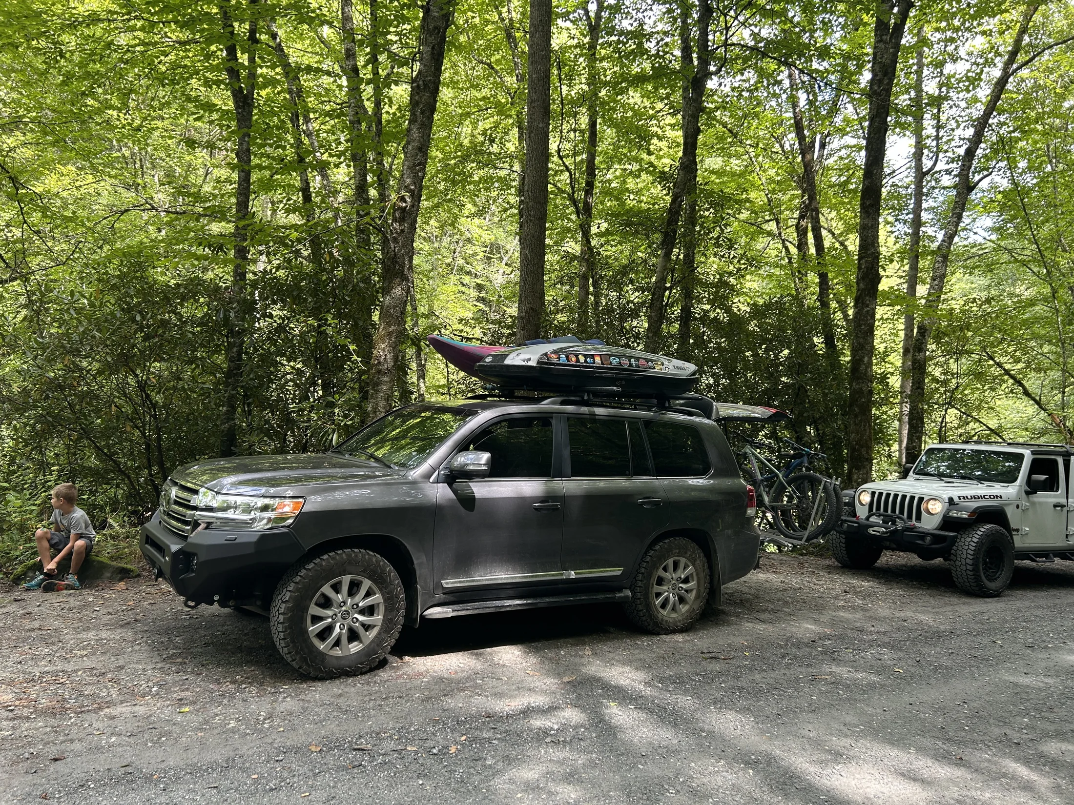

A few more action shots from our second week around CB. Pearl Pass was amazing, with a bit more challenge. Only damage was a small scrape on the rear corner under the bumper (I think every off-roaded 200 has one) a few scrapes on the rockers (that's what they are for) and a small crack in the passenger headlight. I think the Rival bumper might be just a hair too close on that side and it flexed into the light.
Since we had the space to store it, and knew the trail would be a bit rougher, we dropped the bike rack and rambleswing off for this run.
