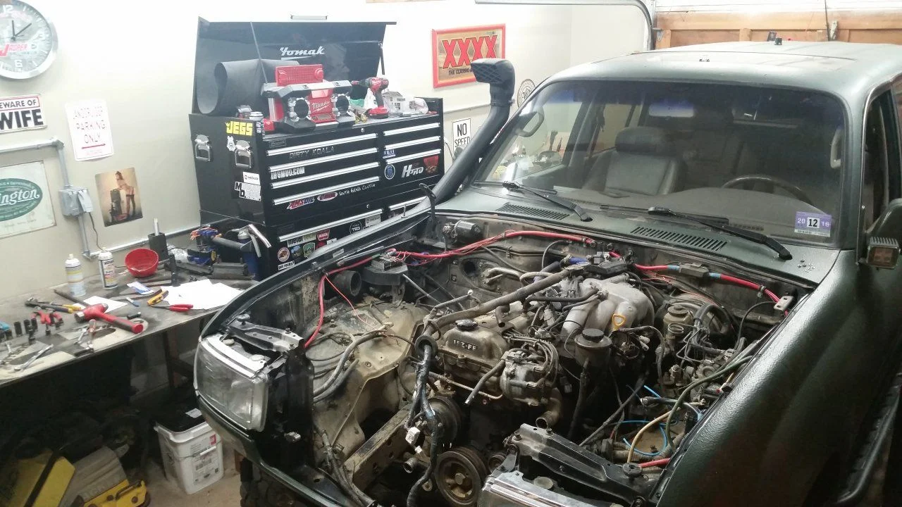

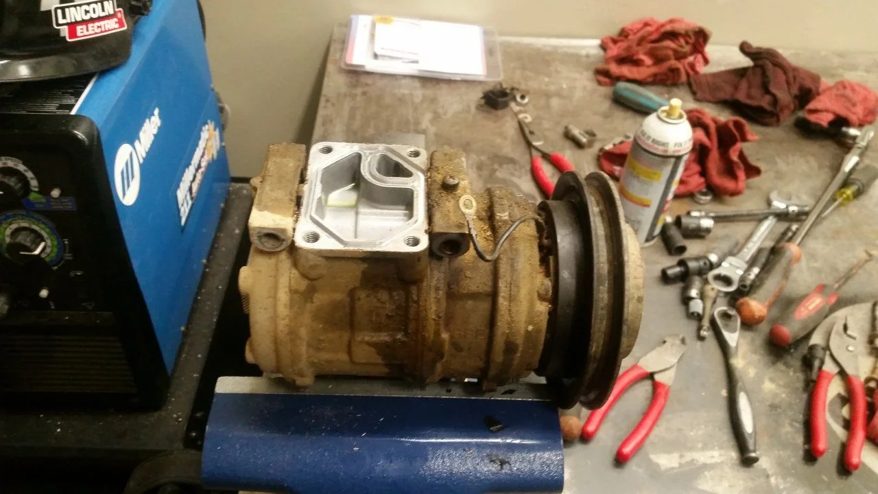

Only had 30 mins tonight, but got the air filter canister, power steering paper clip and A/C compressor out. I also took the top plate off of the compressor, this is reused on the adapter plumbing so that OEM toyota A/C lines remain in the truck.
Was my son's 1st bday party this weekend, so had limited shop time, but I did manage to get everything ready for the big pull.

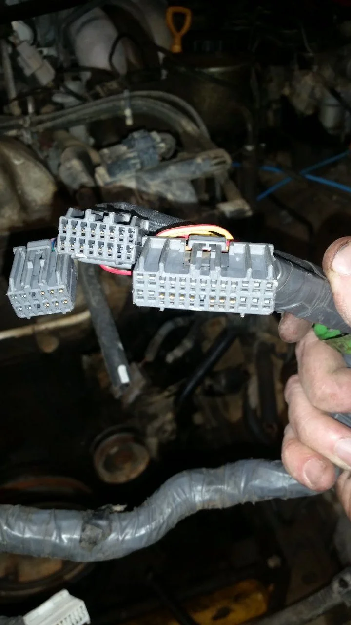

It seems the fastest way to pull the motor is to disconnect the harness from the PCM and pull through the firewall...then take the engine harness off after the motor is out. That is the route I am going.

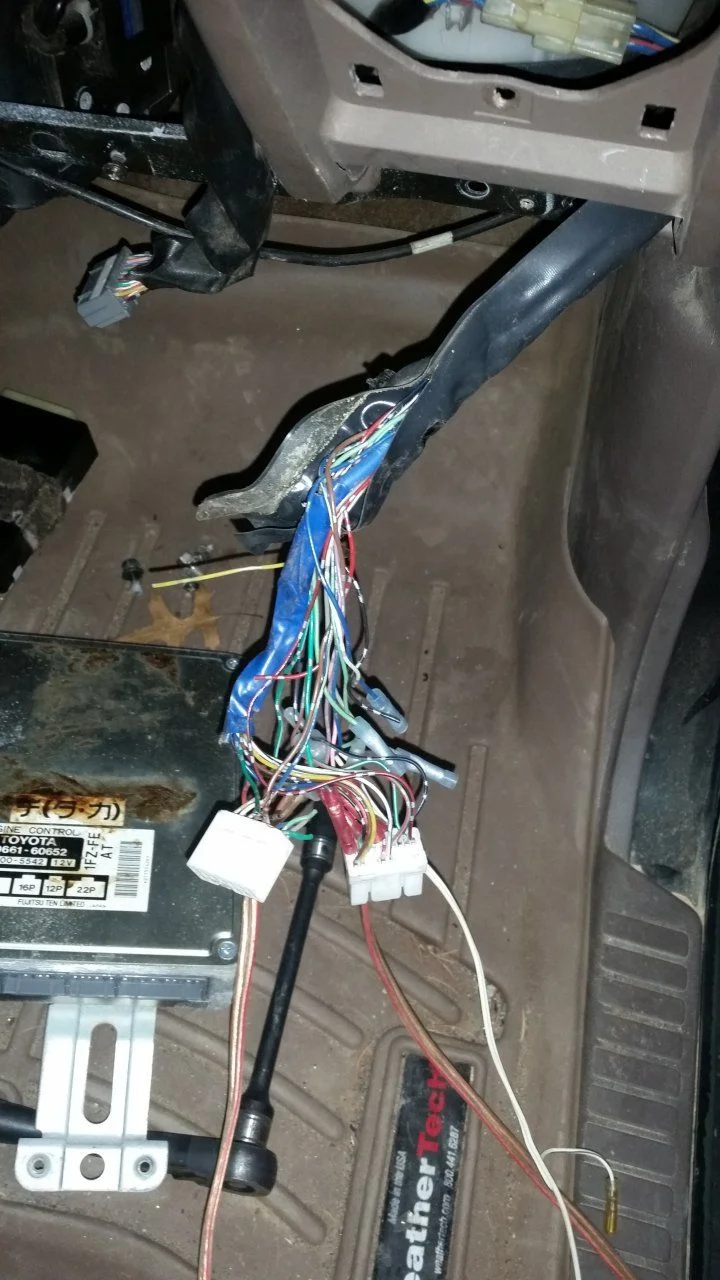

The 97 PCM has 4 plugs, 3 of which are part of the engine harness, and the other, I assume ties into the body harness. I assume the three grey connectors in the picture below are IH1, IH2 & IH3, but I can't identify which is which with the EWD I have...there must have been variations between 96 and 97. Can anyone confirm which plug is which? I am guessing the widest plug (26 pin) is the IH1.
I also found this gem, a prior owner really hacked up the factory stereo wiring, I will tidy this all up before putting it back together.
Mystery solved I think. IH1 and IH2 don't plug directly into the PCM, they are the other two white plugs on the engine harness that are closest to the firewall.

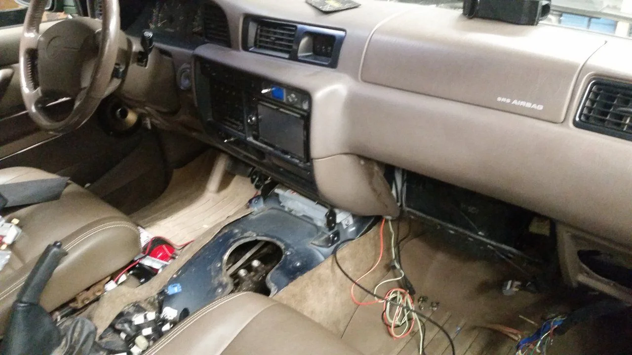

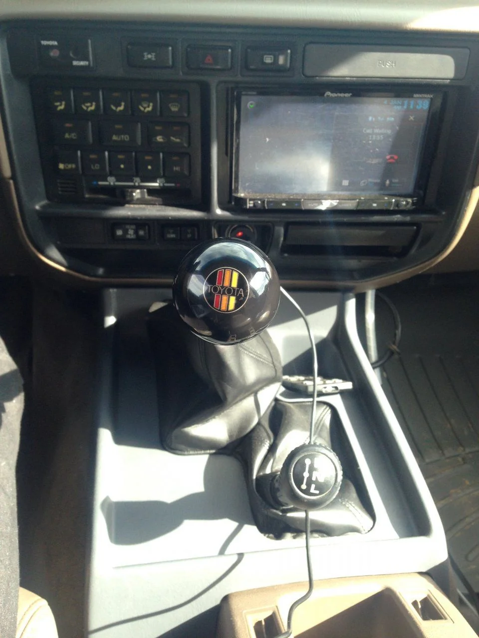

I also took out the center console and shifter and then removed the hood.

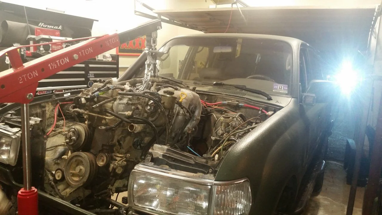

Only thing left to do before pulling the drivetrain out is drop the cross member and unbolt the engine mounts.

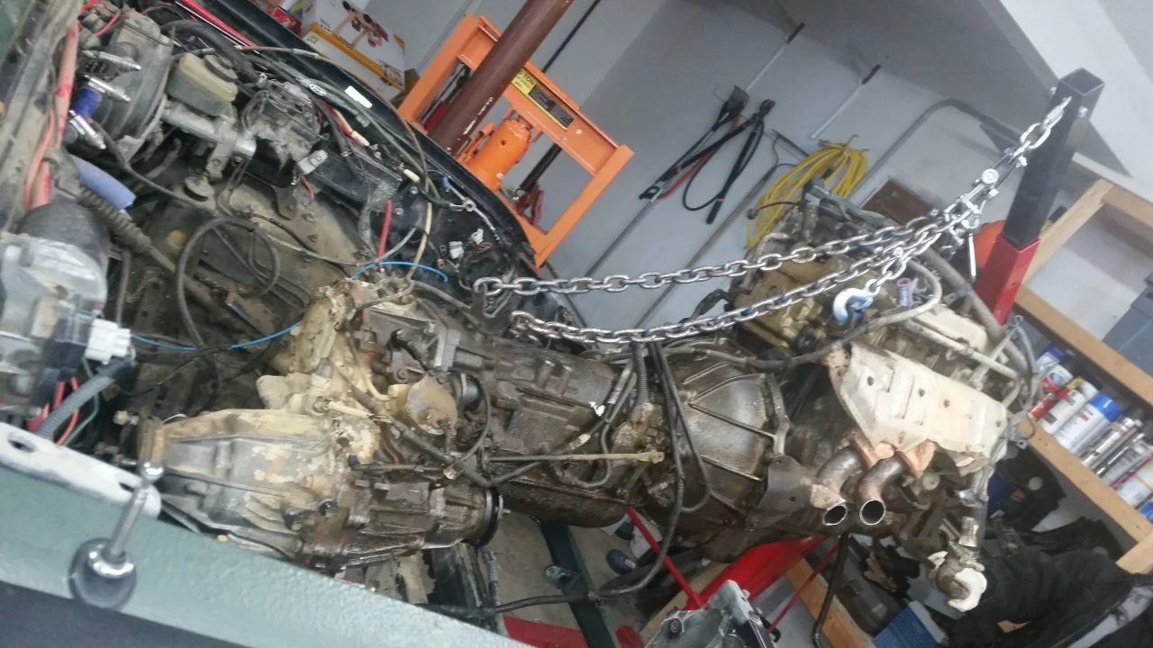

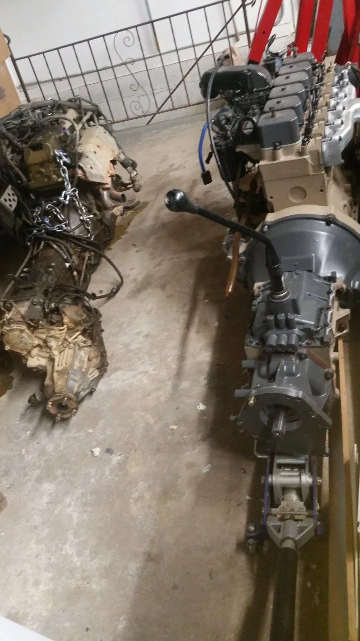

Major milestone accomplished tonight, the drivetrain is out!

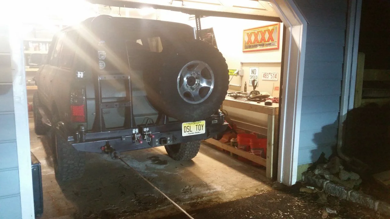

I am certainly glad I picked up an OTC engine leveler, would have been much harder to yank everything out without it.
Hooked up a winch from my mates truck and used the remote to pull the truck back as I manned the hoist.
Now that's one long drivetrain.

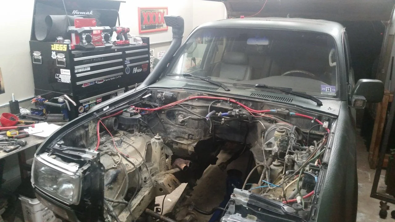

Done!
Wow the original drivetrain looks so little next to the Cummins.
The toyota drivetrain is a couple feet forward of the cummins, so it's a bit of an optical illusion, there is really very little difference in the overall dimensions.

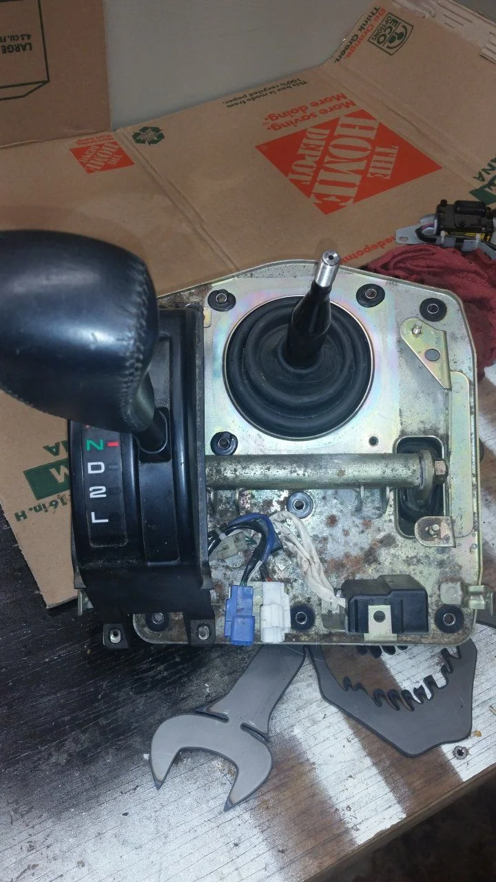

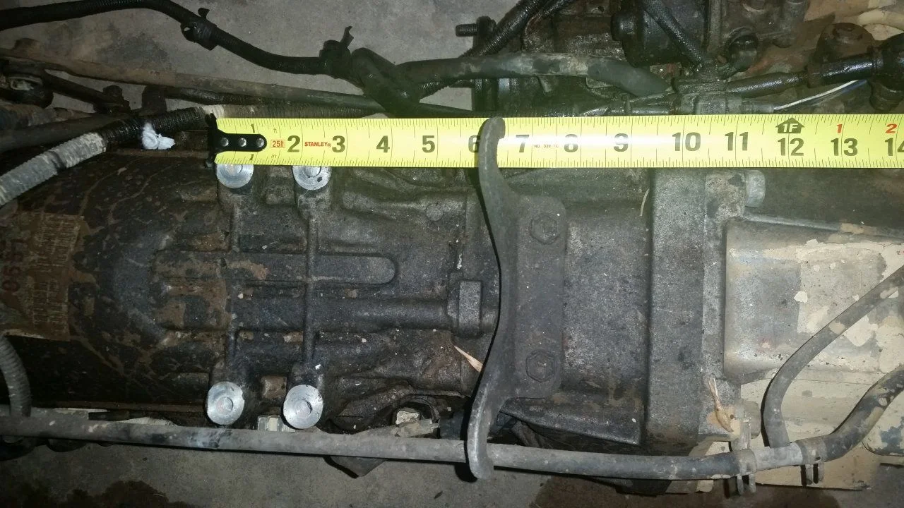

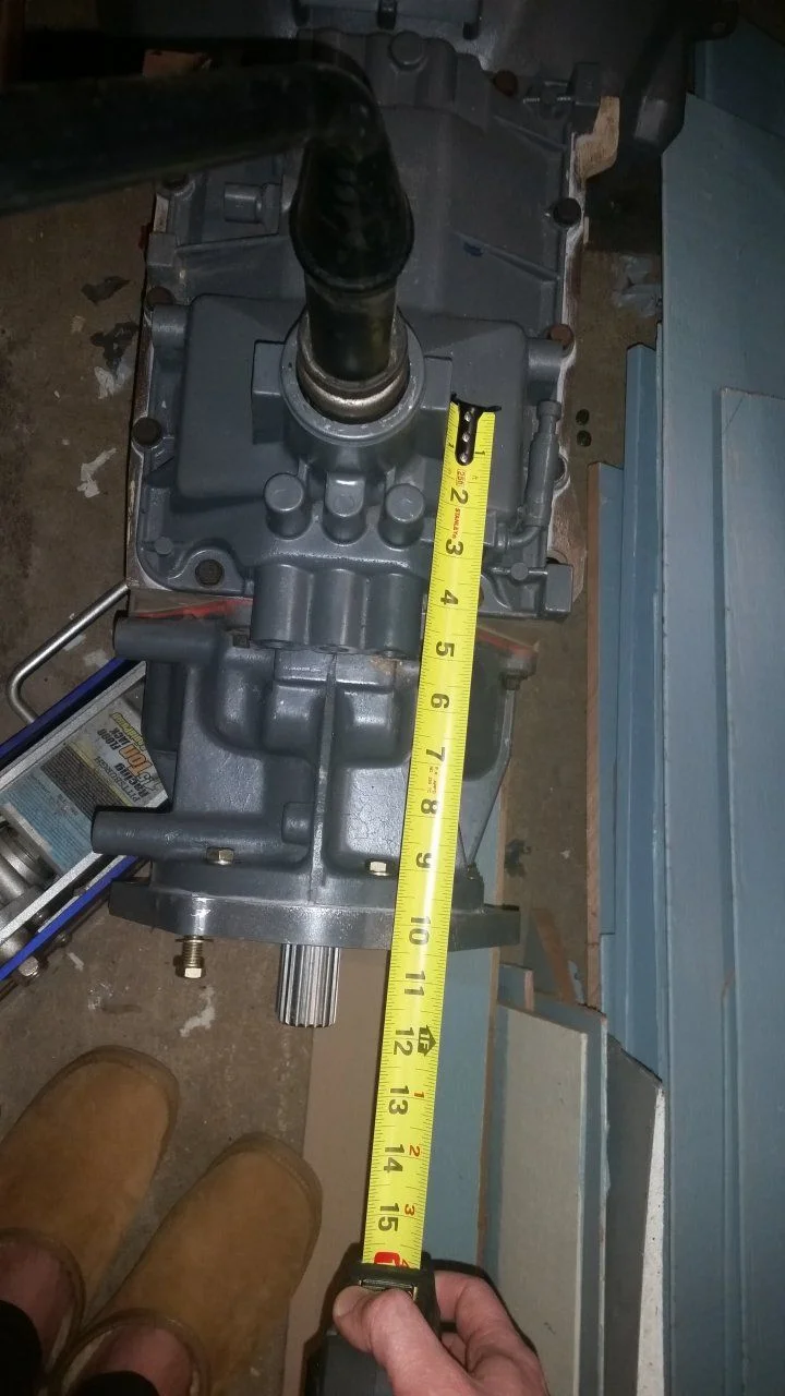

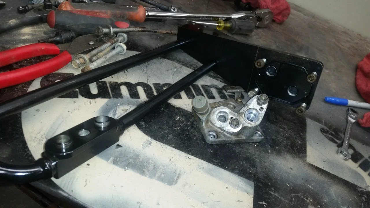

Last night I took a look at how I could make a plate to bolt the xfer case shifter to. At first I was a little discouraged since to put the shifter back in the OEM position (in relation to the xfer case) I would be interfering with the trans shifter tower. (10.5" from front of xfer case to front mounting holes on trans)
I poached one of @thegogglesdonothing photos and realised that the OEM position of the xfer case shifter on a manual sit's about 6 inches further back than on an auto, this puts the mounting location in a good spot on top of the rear extension housing of the trans.
I need to call @beno and see if the OEM xfer case shift linkage for an HF2AV that came behind a manual trans is available.

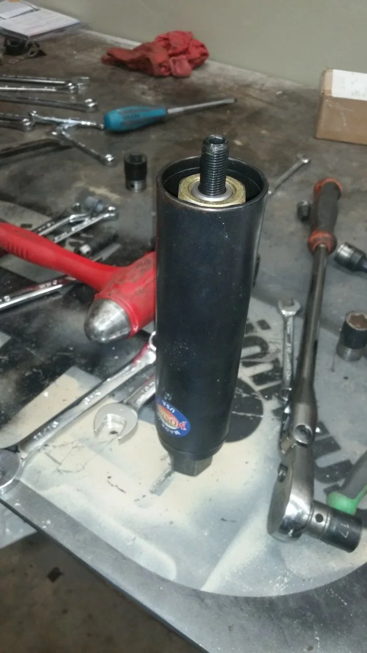

Did you need to press the 5th gear on your new main shaft when you assembled yours? Tried to test fit my new 5th gear onto my main shaft and would not go on.
How did you press the gear on if it is press fit?

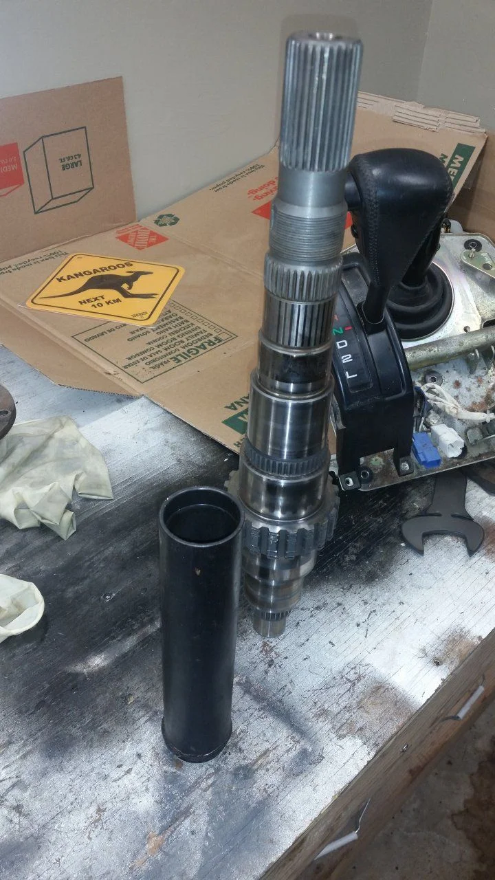

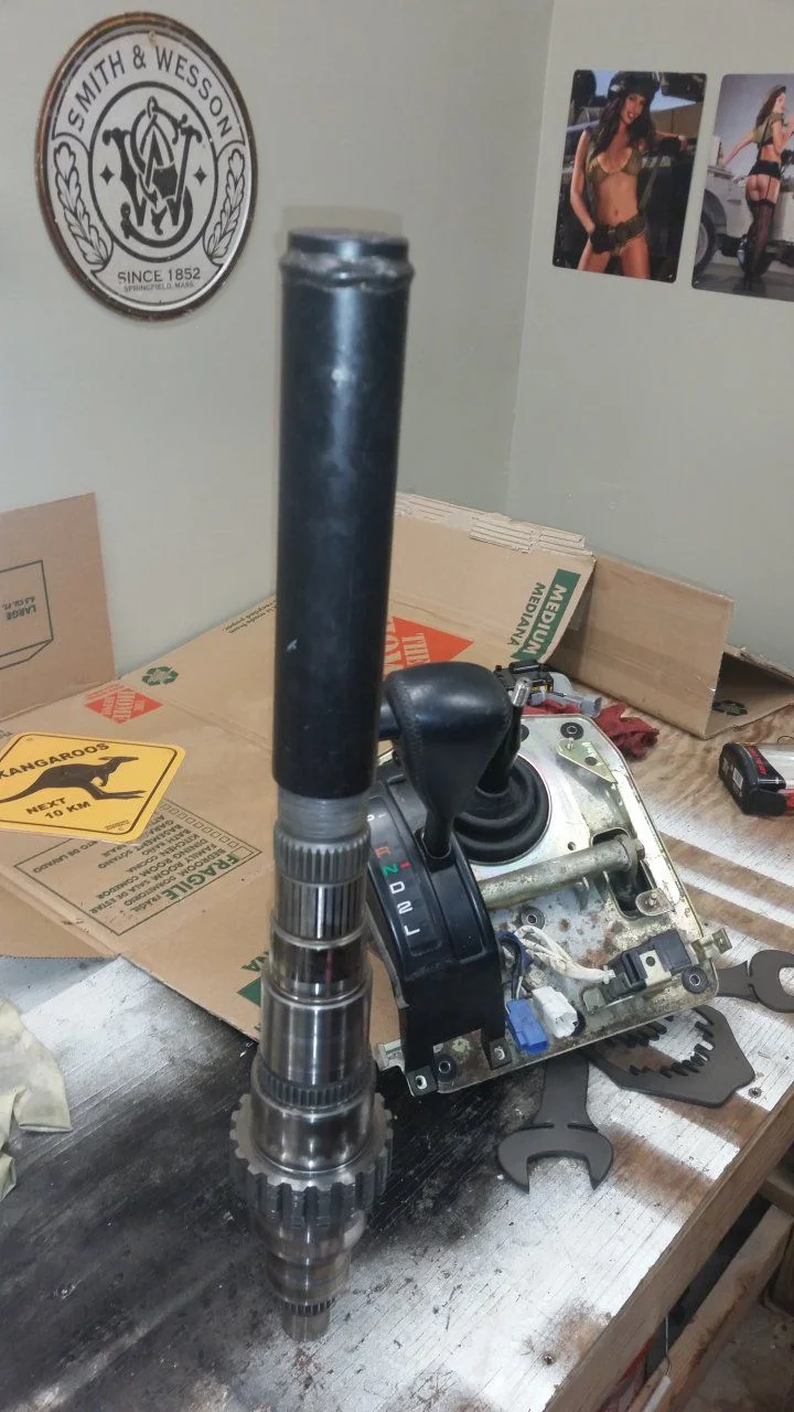

The oem mainshaft has an internally threaded output shaft, which this tool can be used to press 5th gear on with. I believe the quad 4x4 torque king shafts are also threaded.
Dustin had difficulty adding an internal thread after re-splining the cut down shaft, so instead I used this and a 40oz dead blow hammer to press 5th gear on. (This is the old OEM mainshaft for display purposes)
Thank you very much good sir!
My main shaft does not have the treaded end on it like the OEM so I was a bit lost lol.
This clears it up! Do you need to install 5th gear after the Main shaft is installed in the case or can it be done before?
Since 5th gear is on the outside of the main case, 5th gear gets installed after the new mainshaft has been fully assembled and put back in the case, it's one of the last steps you do during the rebuild.
I am about 3/4 the way through a detailed writeup on how to rebuild an NV4500, I just need to dedicate another hour or so to wrap it up.
