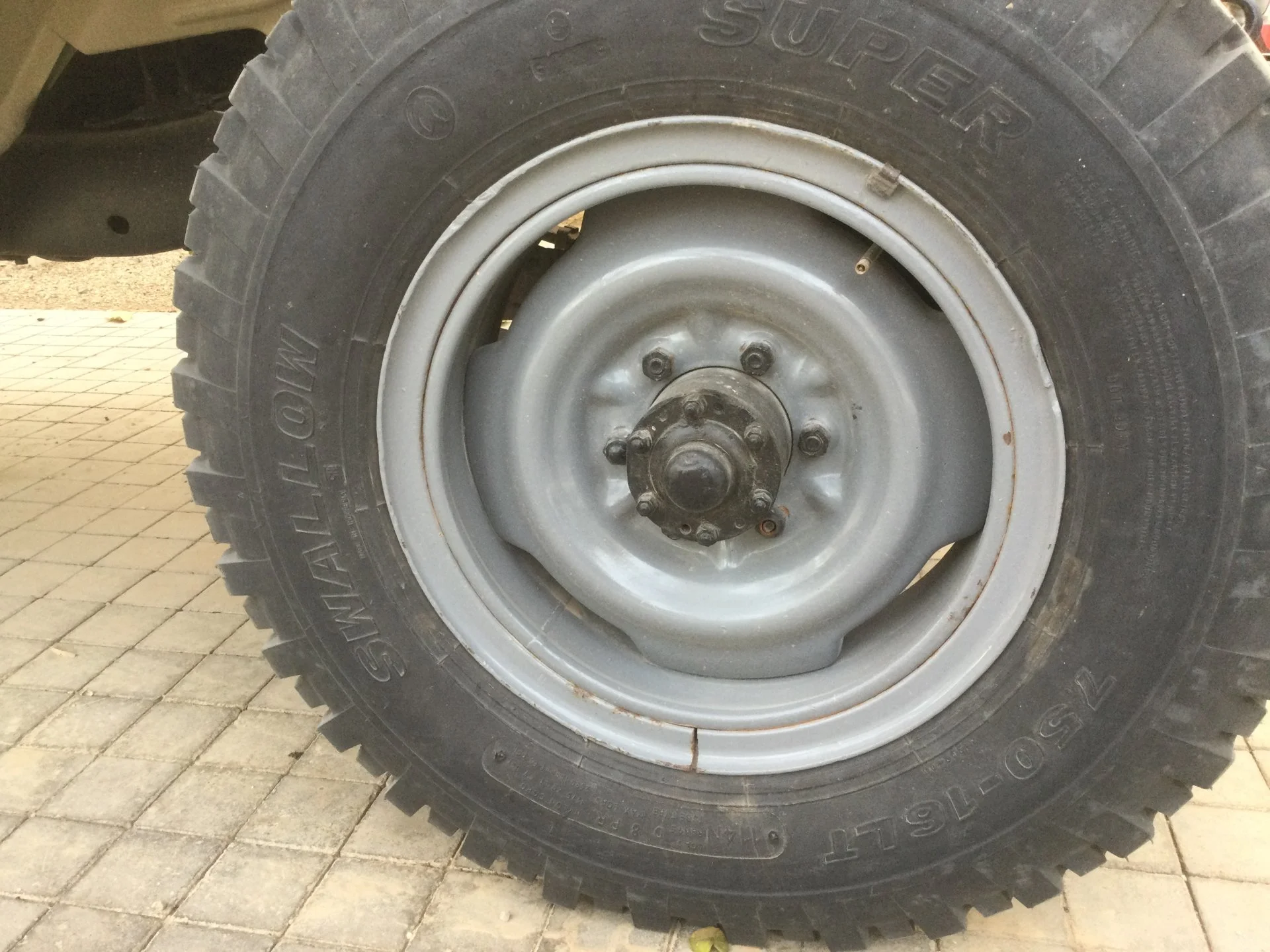

Although I never see locking hubs over here, the parts diagram does show them as an option for both my '83 Troopy and my '94 pickup. Looks like the Troopy optional hubs are still available. I assume they are Aisin? Looks like it covers 4X and 6X from 1980-1989 in all markets.
The '94 FZJ75 also shows optional locking hubs on the parts diagram but lists them as "not applicable".

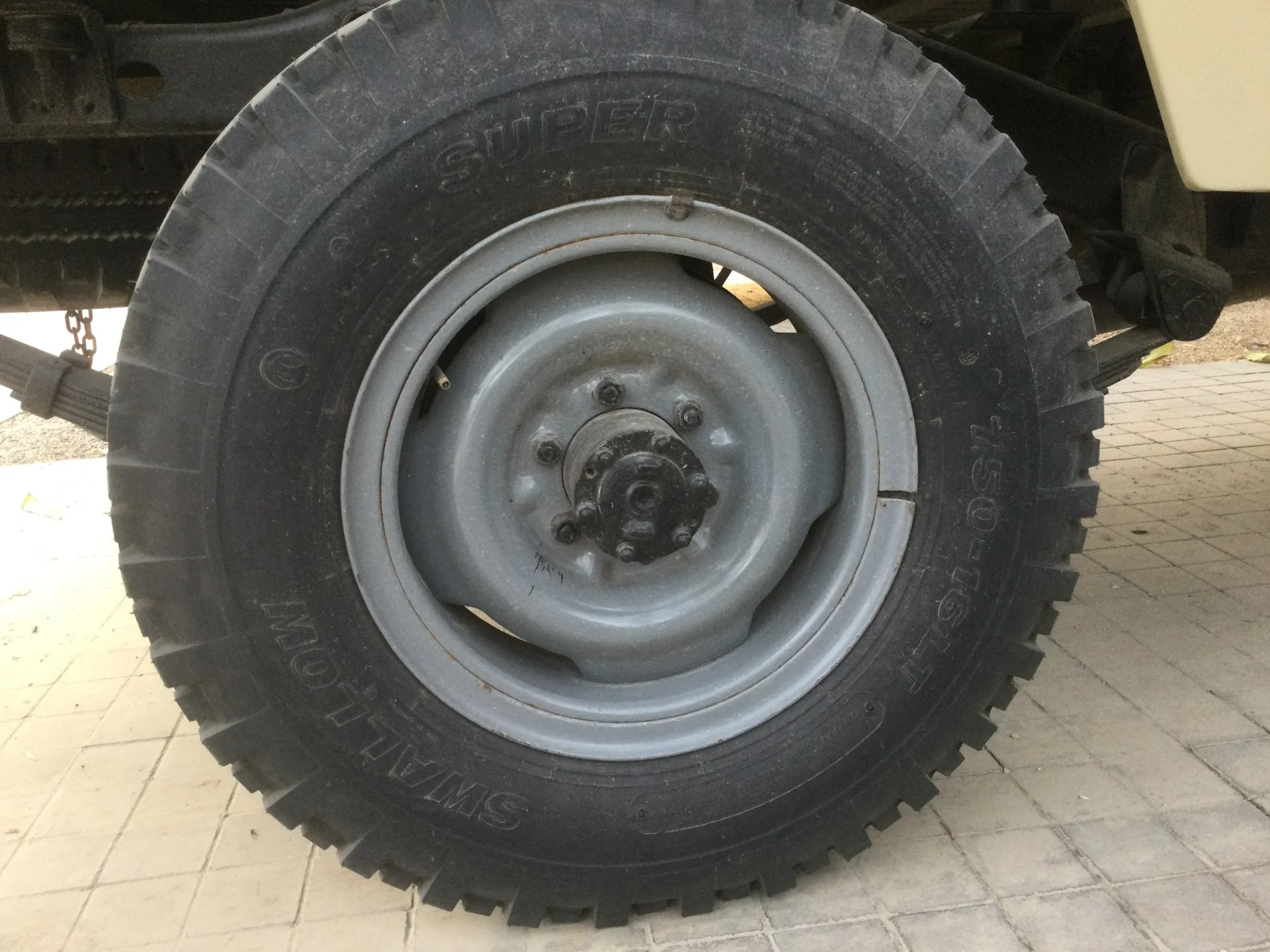

Note the utter lack of locking hubs on this 76 series.
Just looked up a 1973 Australian spec FJ55 and it also shows the locking hubs as "Not applicable". 1978 Aussie on the other hand gives an optional part number: 43530-60012
1973 and 1978 Japan spec FJ55 (FJ56 for the 78) doesn't even show an option for locking hubs. Nothing but drive flanges - so much for the bad roads argument.
Europe and the Middle East (and all other General Countries) shows the same as Australia; NA for 1973 and same optional part number: 43530-60012 for 1978.
So the US seems to be the only market that offered the option in 1973 with the rest of the world except Japan offering the same sometime between there and 1978. Fascinating that the option was never offered in Japan. I guess they considered drive flanges the bees knees and that was that in the motherland.

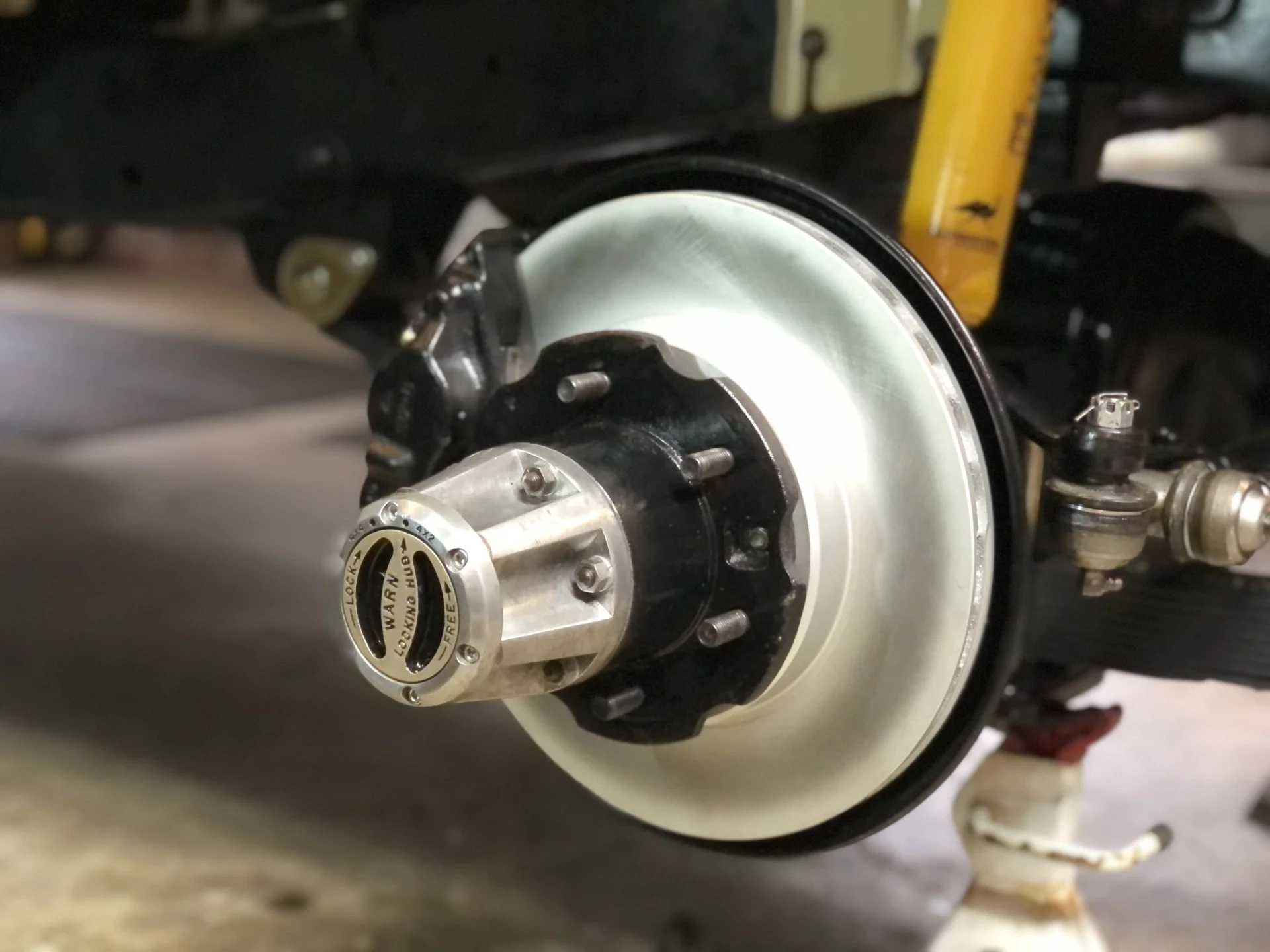

In the event of a broken birf, it would be about 5 minutes quicker to pull a drive flange than it would be to remove a lockout hub. Six less bolts. So there's that. However, worn and broken birfs may be more of an issue if they are always in action as opposed to mostly sitting still in a lockout hub environment. I'd say it boils down to a matter of preference. Lockouts look better to me. It's what we in the states are used to seeing on trucks. When they are all cleaned and freshened up, they sure look sexy.
Aisin's look even sexier than Warns IMO.
Warn’s look great on vintage domestic tin. They are the classic American lock-out.
Prefer the look of the ASCO/AISIN’s on Toyota/LC’s.
