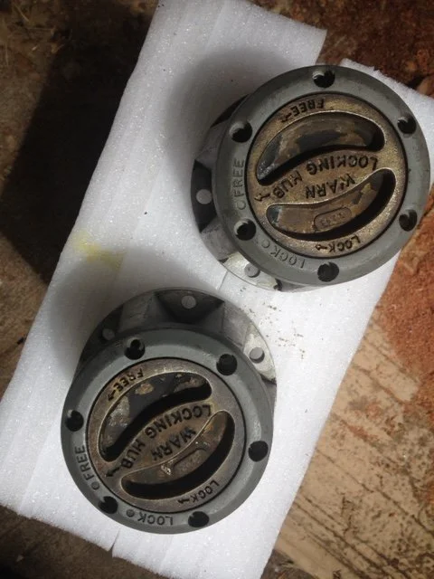

These are the warn hubs everyone is referring to.
I have those plates on the front axle of my 65 FJ45 Pickup.
Come to think of it I may have a set of those warn hubs sitting in some random bin in the garage. 🤔
(note to self...."you're turning into a hoarder")
That is exactly what they were.

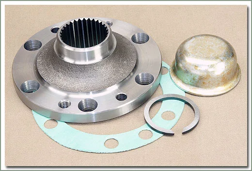

I think they are called drive flanges and I think that is/was the standard configuration from the factory. I personally would never bother to change them to locking hubs but now I'm just repeating myself. :p

The difference between drive flanges and locking hubs is that drive flanges cause the birfields and front diff to turn whether the transaxle is engaged or not? And locking hubs allow the wheels to turn without driving the birfields and the front diff?

You are correct. Drive flanges force the birfs, diff and front driveshaft to turn all the time, even if the transfer case is not transferring engine power to them. The upside to locking hubs (free-wheel) is that they save a lot of unnecessary wear and tear on front axle parts and save a little on gas too. The downside of locking hubs is that you have to get out of the truck and lock them to engage the front.
