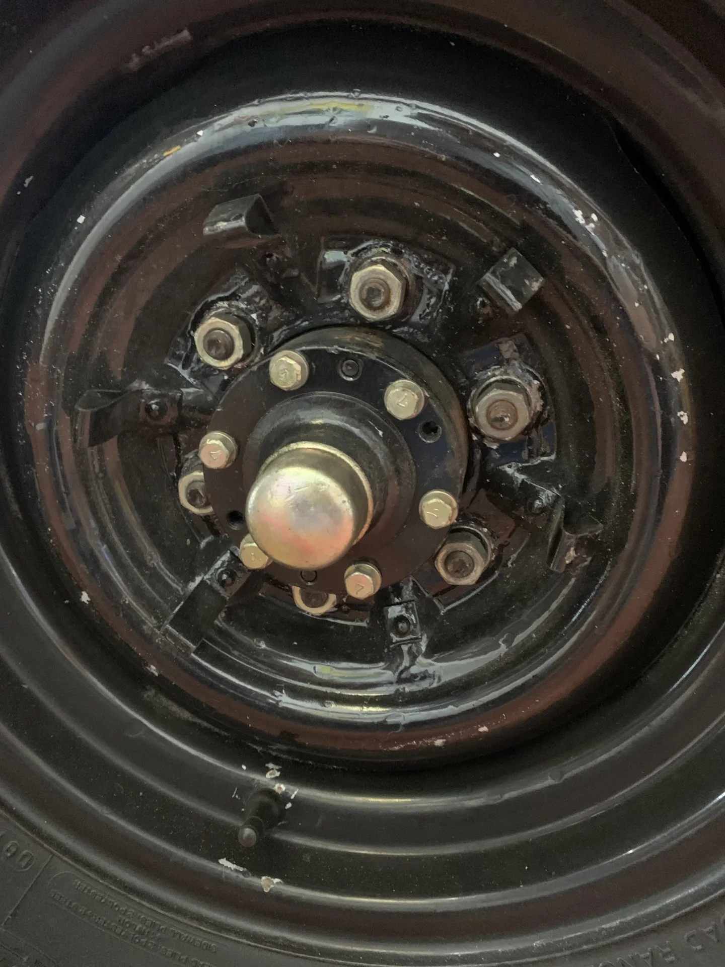

New owner to a 73’ 55 and my old 40 had them and every one I see on here has locking front hubs... I didn’t see anything about them in the manual either. It’s in Portuguese maybe.
I understand it just means the axles are turning full time just not sure why mine would not have them.
Truck came from Venezuela.
I’ve read that in here, people say they came with drive plates. So does that mean I can remove the grease cap and end plate next install a locking hub?

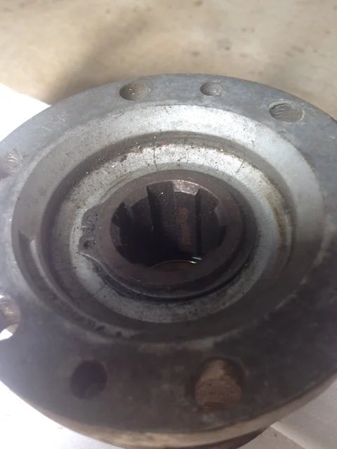

My 73 (Coyote) came without locking hubs. I did a disc brake upgrade with 60 hubs and installed locking hubs at that time. Once the flange was removed on the original hubs, it looked like you could just install locking hubs without problems. I have a couple sets of the course splined hubs if you decide you need them.
Not sure on the dealer installed thing or not, but drive flanges were, and are common depending on market, spec ect.
If you want locking hubs you will not only need complete hubs, but they will need to be for that axle (10 different applications of hubs I think) and there are 4 thicknesses of snap rings black, red, blue, green that you may have to use
