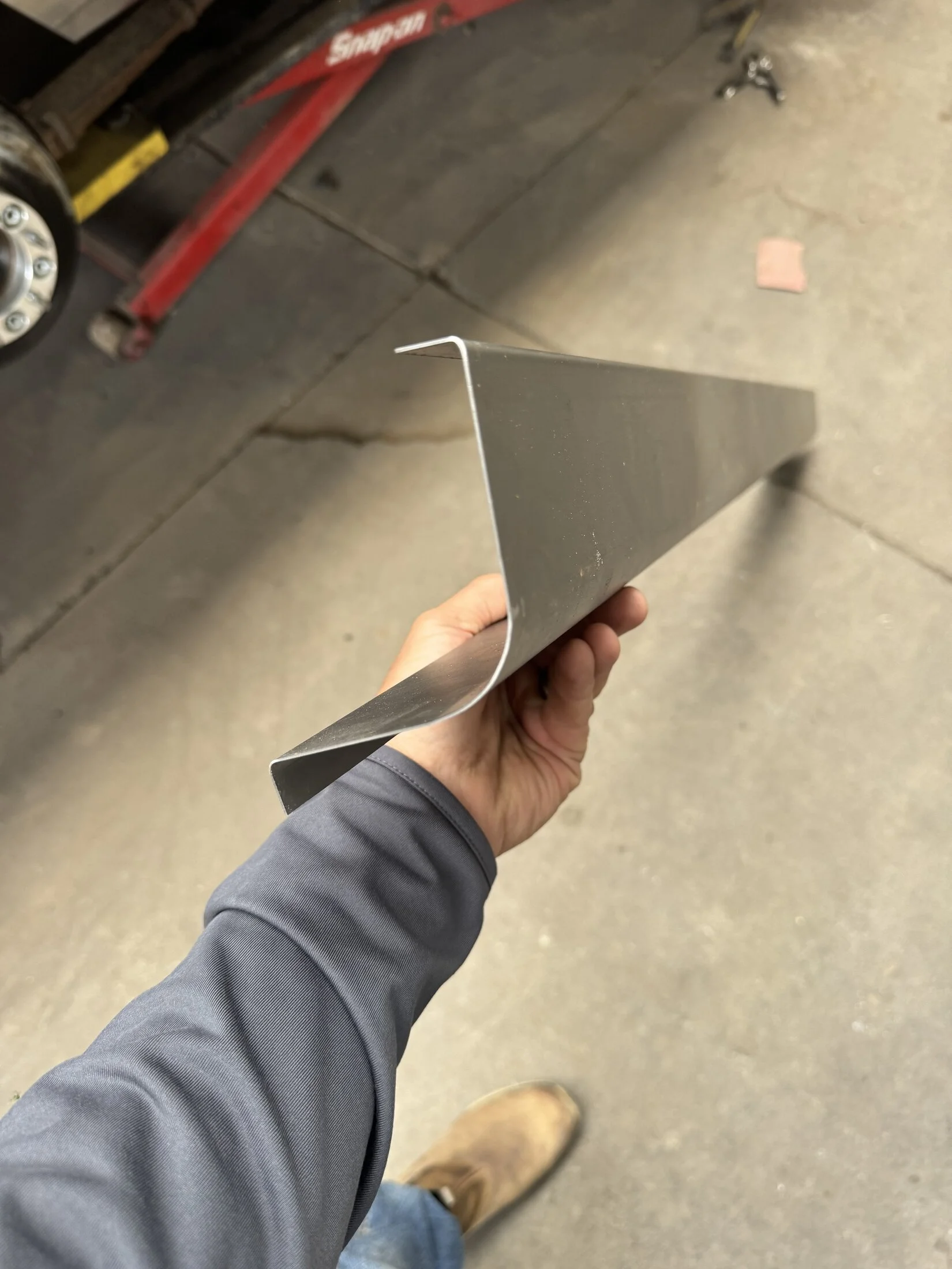

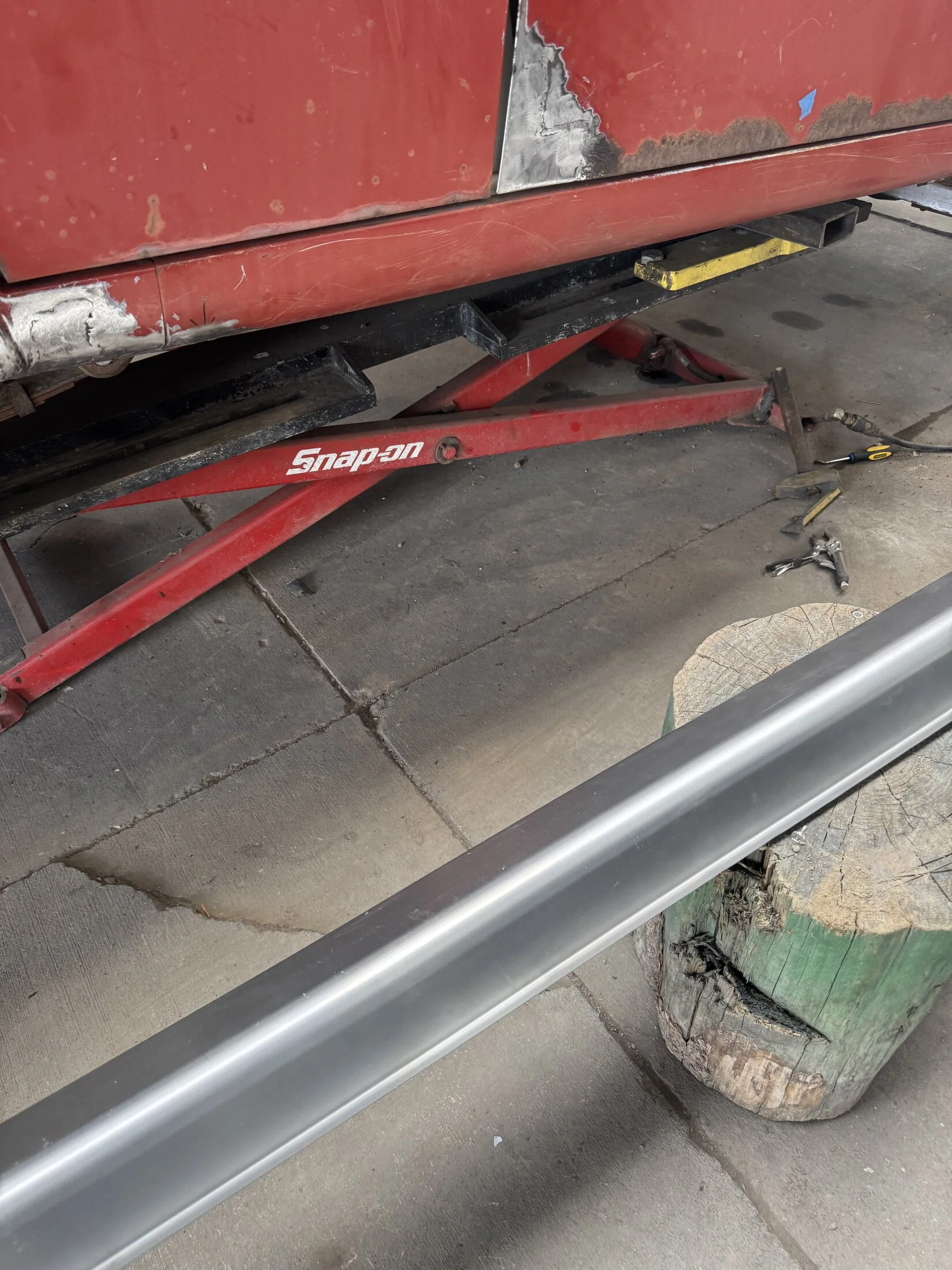

Just looking to see if anyone needs some of these. In the past, when the 55 rockers were rusted, I had a method to repair them. I would cut access holes in the rocker, sandblast them and then seal with a POR15 type product. My feeling is, with the 55, there is usually some rust in the rockers...even if it isnt showing yet. Anyway, rather than patch each cutout, I have had luck with my HVAC guy bending me some rocker covers. There is plenty of room under the doors to fit these in. I know I can have both sides made for under $200. Not sure how I would ship. This is really not my thing, but I thought it could help some people out. If not, you can take this idea and a template for your local guy to make.
Take a look. Any suggestions on shipping etc would be great.
