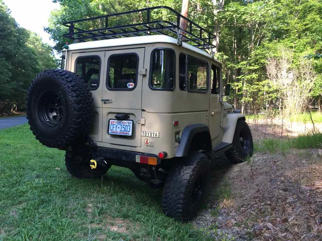

The difference is HUGE! I am much happier with this new setup. I am going to have to extend my bump stops down 2" in the front and 3.5" in the rear. I plan to either fab up my own extensions or pick up a set of the killer ABS bump stops from Mark's Offroad.
shackle angles are much better now.... good thing is when they start sagging more you can just add leafs back

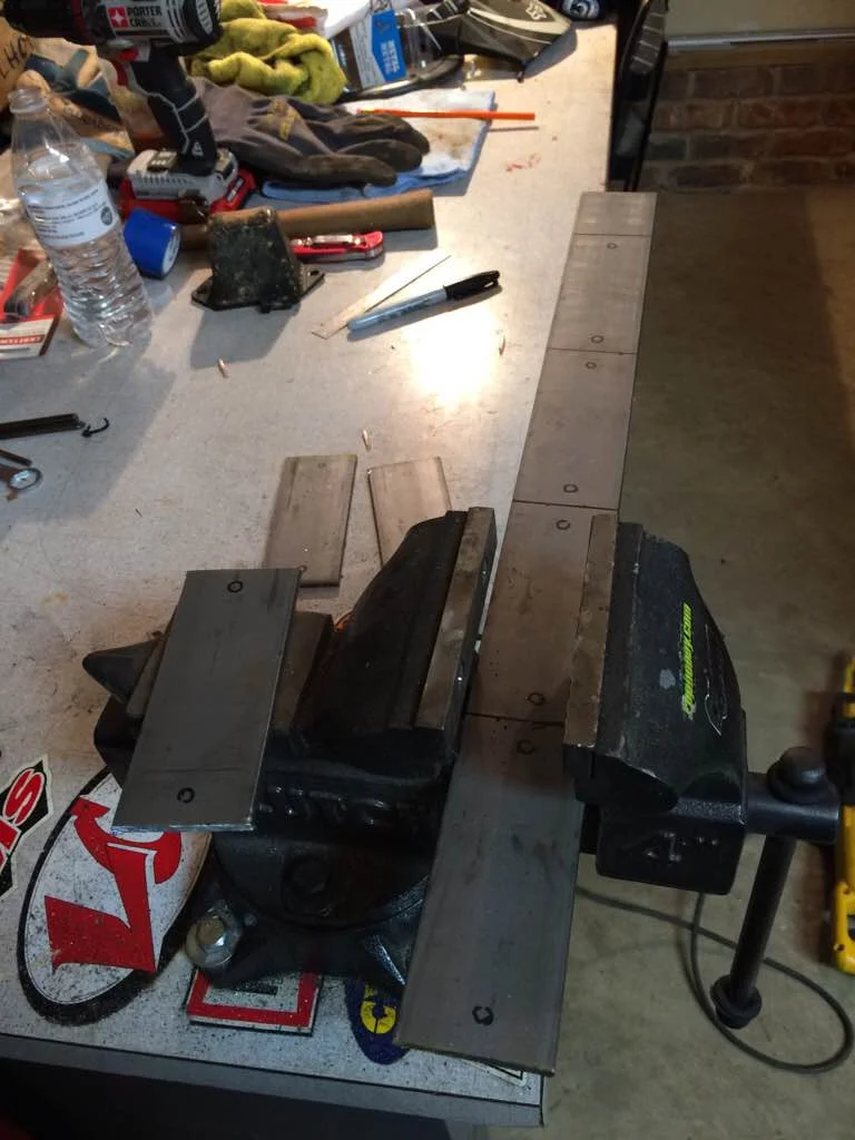

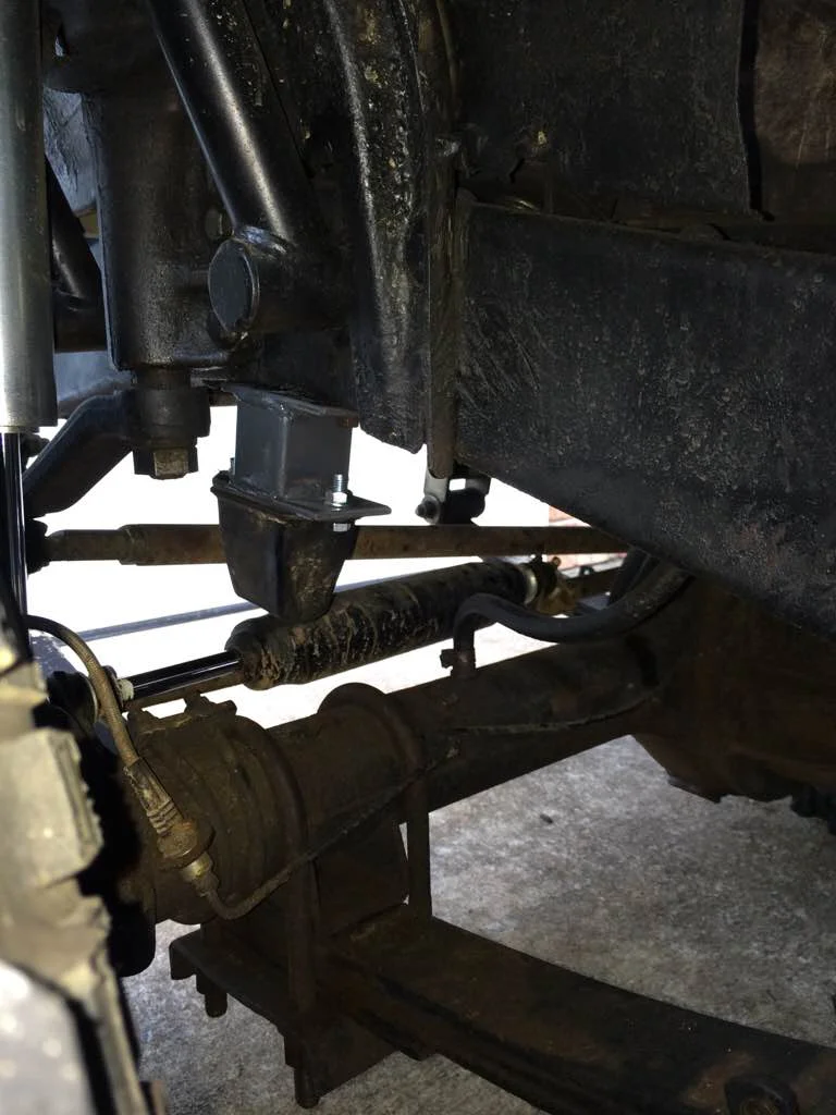

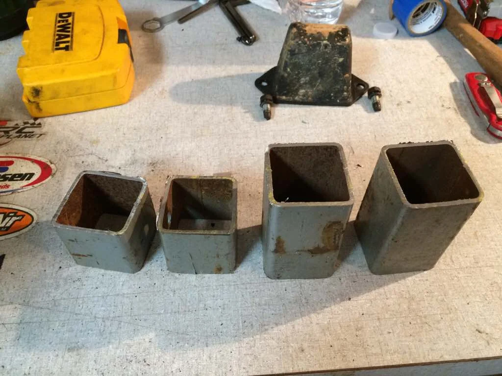

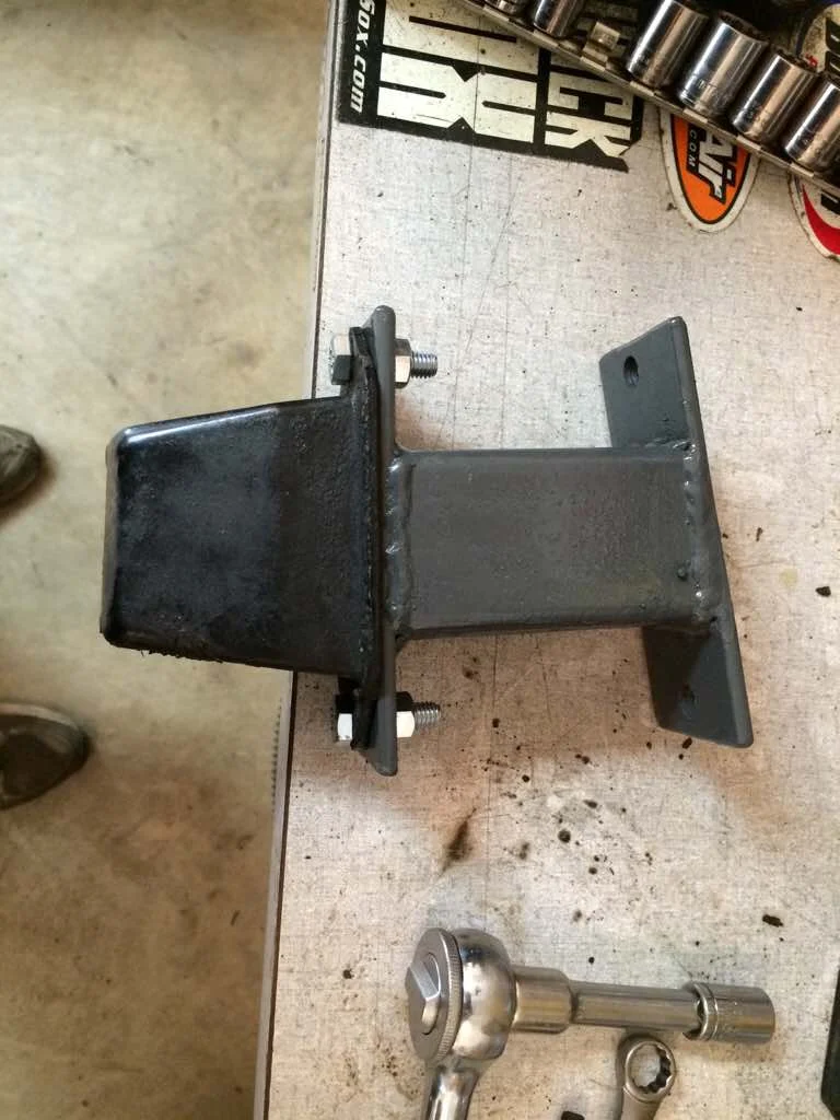

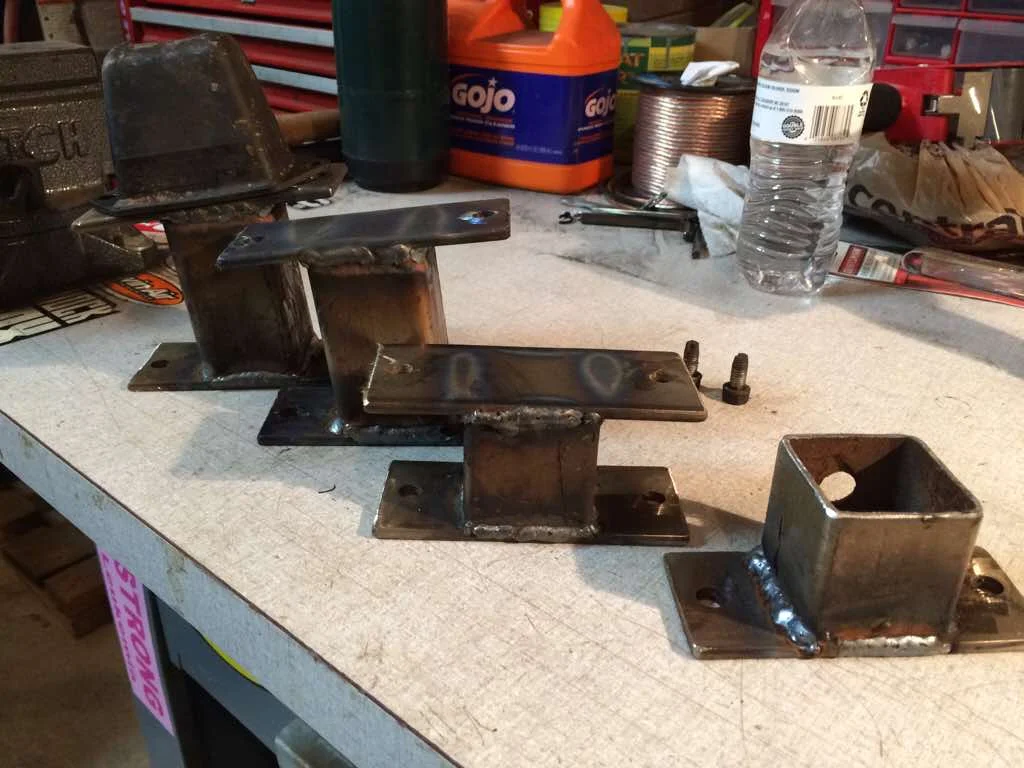

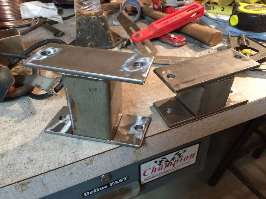

I decided to fab up some bump stop extensions to keep rubber away from sheet metal. According to my measurements I need 2" up front and 3.5" out back. Mark at Mark's Off-road has the right idea with his extensions. They are made with an incorporated angle to better position the bump stop over the axle in a lifted application. I did my best to copy his design using some 2" flat stock and some 2" square tube I had laying around.

This shot shows the angle on the longer rear extensions. The fronts are flat.

Finished product:

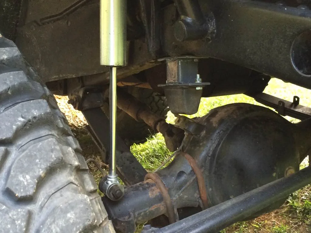

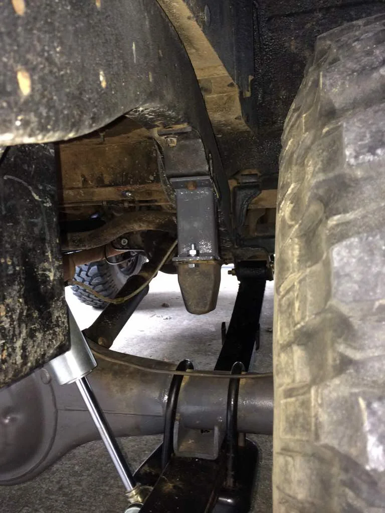

Got a chance to test the bump stops yesterday. Cutting it a little close up front but I think it will be okay. Pics to follow...

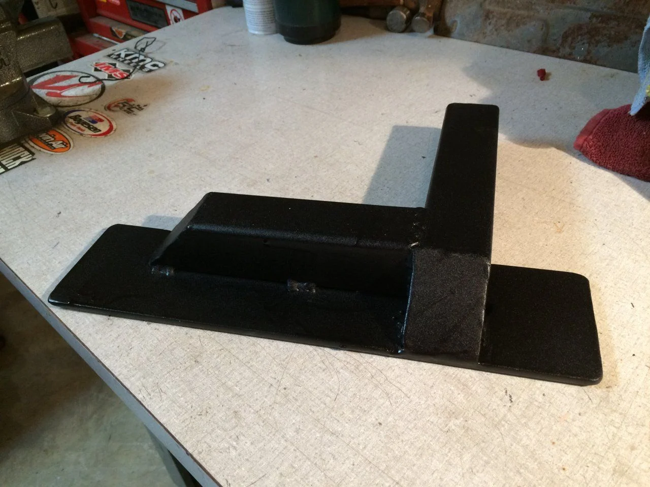

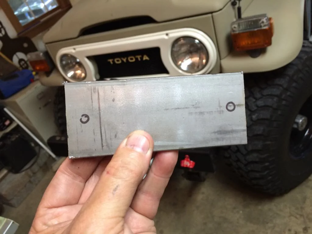

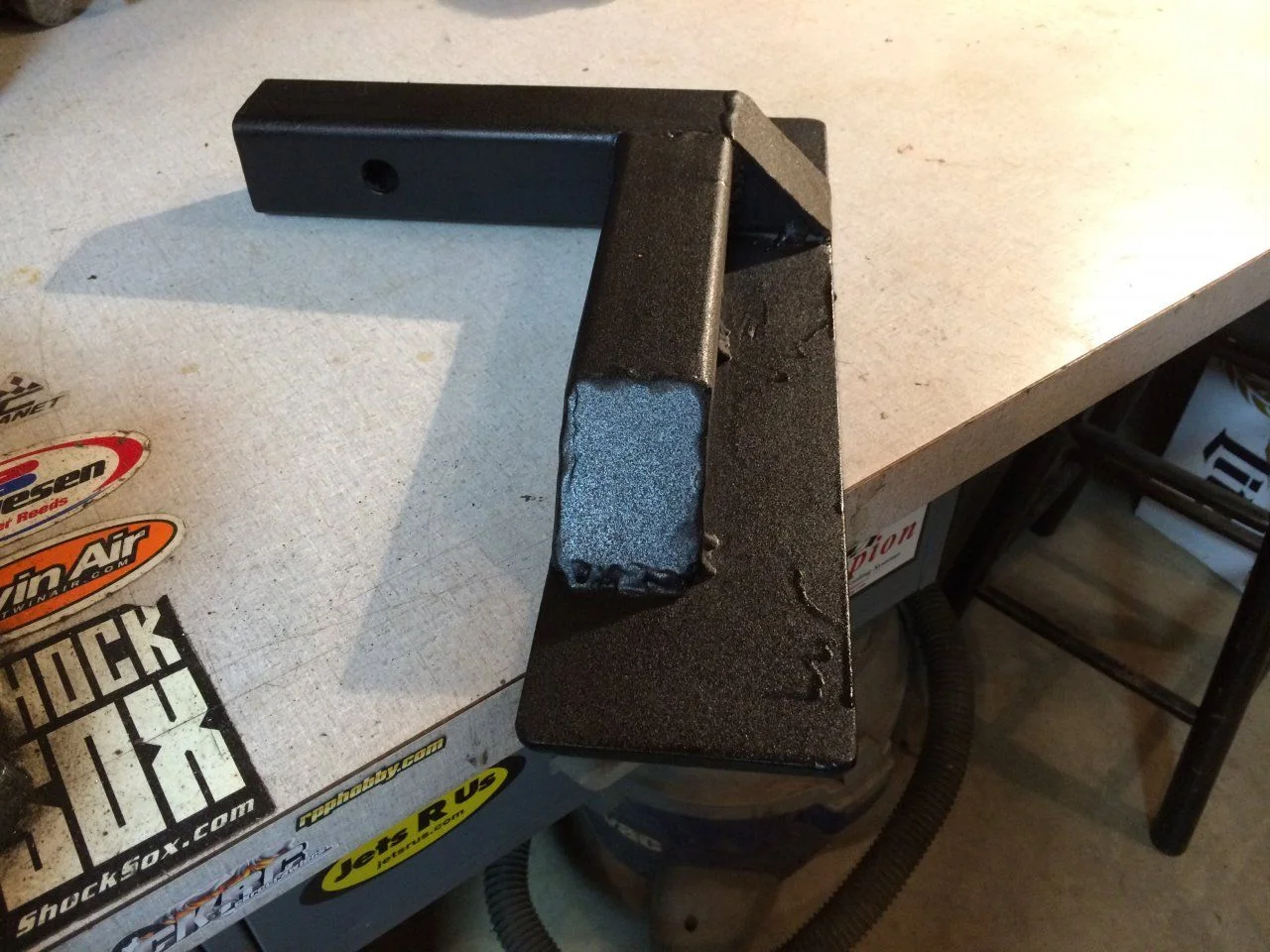

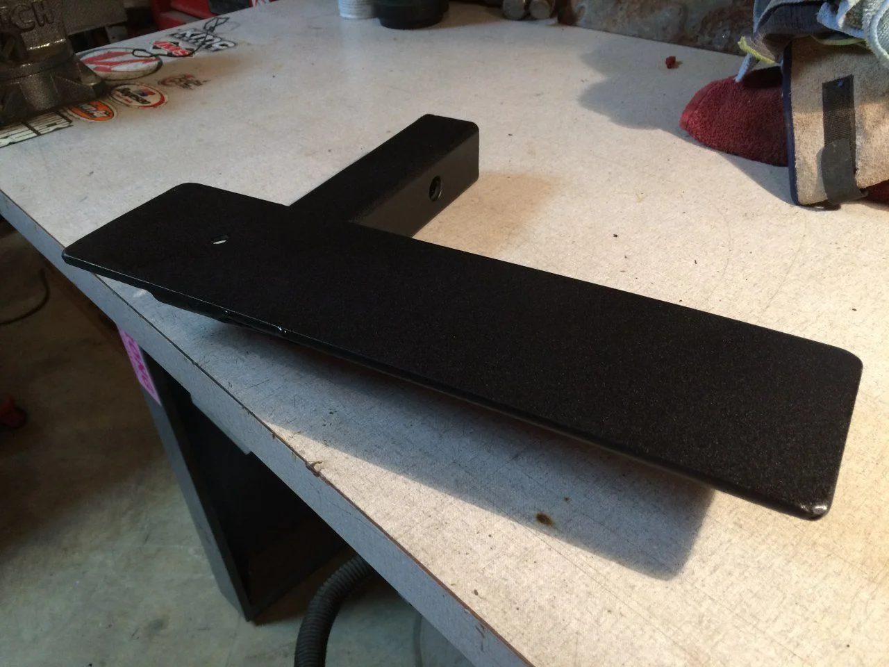

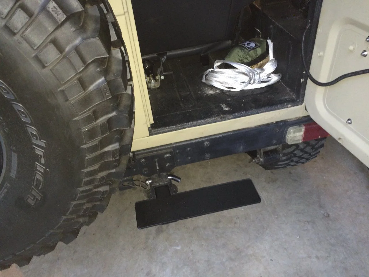

With the Hurricane Creek camping trip coming up soon, I decided I would fab up a rear step to make it easier to reach items stored up on the roof rack as well as to help with access / egress into and out of the rear of the Crockpot. Here's what I came up with using scrap stuff I had laying around the shop. It's basically 2" square tube and a piece of 4" x 16" x 3/8" flat stock. It got late on me and I hurried the paint so it's not perfect but, hey, it's a step. I primed it and painted it with rattle can bed liner. I plan to stick down a strip of grip tape on the top of the step for surefootedness. That is a word, right?

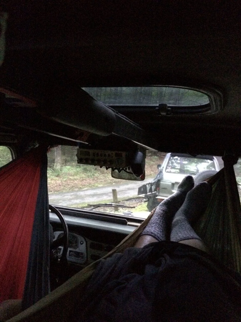

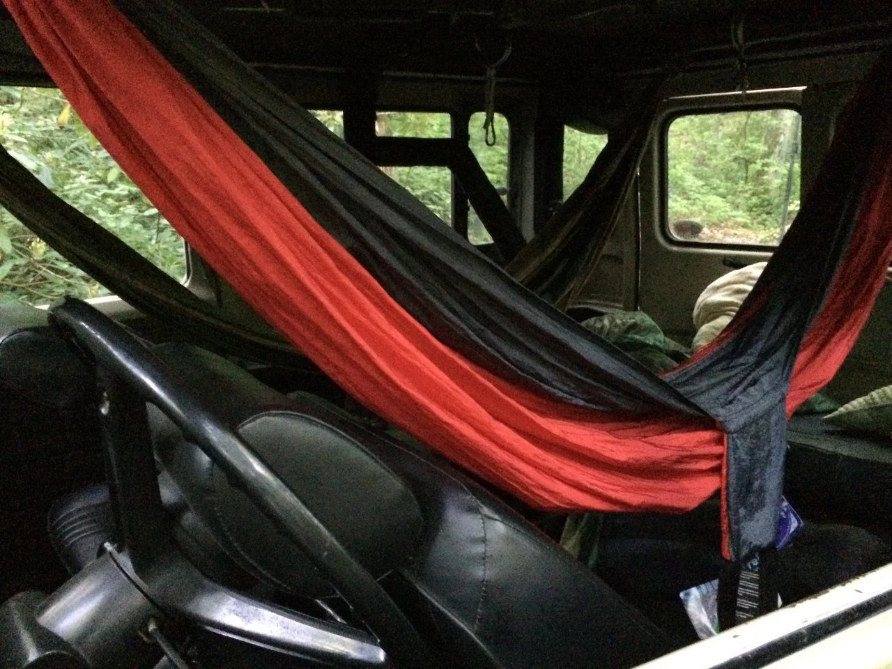

Nathan and I slept in the 'cruiser. Yes, it's true! Here is proof that two people can actually sleep comfortably in an FJ40. Here's how we did it. I suspended two ENO hammocks from the full cage. The hammocks were too long so I tied knots in either end to shorten the length and tighten up the sag to a comfortable level. I am 5'10" and was able to straighten out and sleep comfortably with this setup.
I bought a roll of cheap nylon screen and cut it to fit inside the window frames of the doors and vent windows and attached the screen to the inside of the windows with magnets. Tah dah! No bugs and we could still roll the windows up and down and open and close the vents to regulate the temperature inside the cab.
