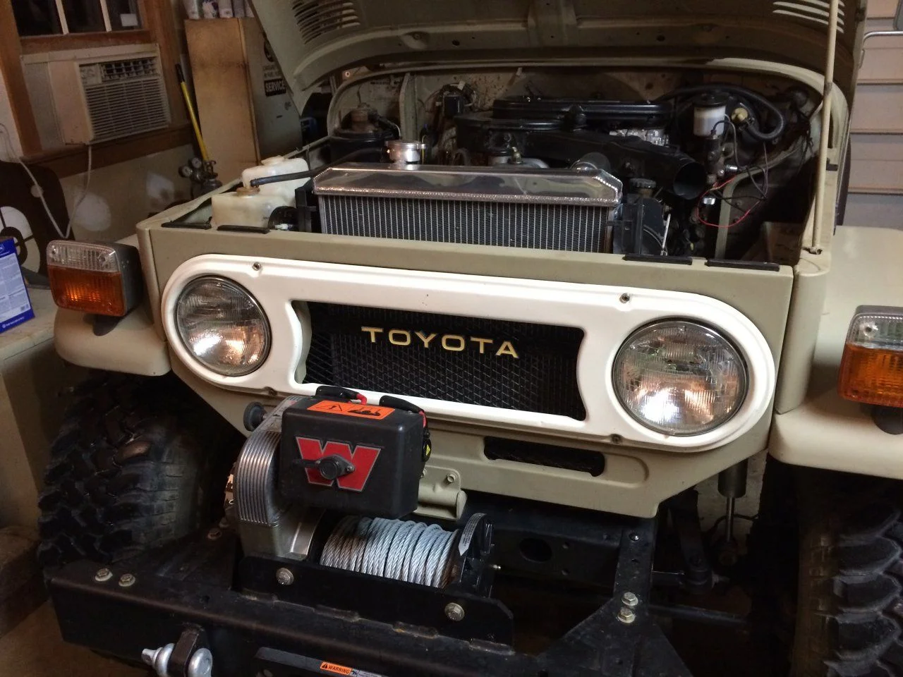

The Crockpot had trouble keeping its cool on the last mountain trip I took. I had to stop several times along the way to let it cool down after pulling long hills. I suspected that it was a flow issue. I decided to do a muriatic acid flush on the radiator to see if it helped. I did this "by the book" as far as the acid/water ratio and rinsing with fresh water and following with a mix of water and baking soda. I buttoned everything back up, refilled and all was good. I drove it for a couple of days and parked it for a week. The next time I fired up the Crockpot to go on a 'wheeling / camping trip I noticed a drip coming from the radiator. I pulled the radiator, pressure tested it and found the leak. Took it to the local radiator shop and he was not able to fix it. The copper was too thin and every time he put heat on it to solder it, the split kept growing. I toiled over whether to buy a new Toyota radiator but ended up with this:
Overall I am happy with it. It is a three core Champion. I have used this same brand and model number before in a 40 and had no trouble with it. I don't expect any trouble with this one. The CP is back on the road and running well.

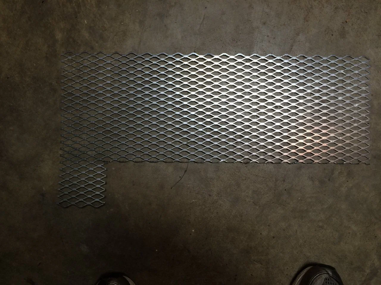

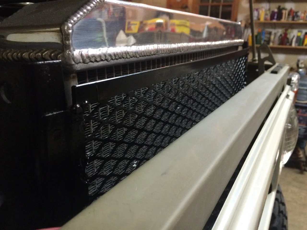

I like details. Details are important to me. This truck has had my OCD in full-on freak mode since day one. Today I took care of another little detail that has always bugged me. The top radiator grille was missing. It seems to happen on a lot of trucks. I don't know why. This is the second 40 I have had and both of them were this way. I decided to go to Lowes and pick up a small sheet of expanded metal and a piece of bar stock. Cut it out, tacked it in and ahhhhhhh....I feel so much better!
@roadstr6 - crockpot is looking great!

Dave, I feel you pain... here is the metal I just bought because of my OCD.

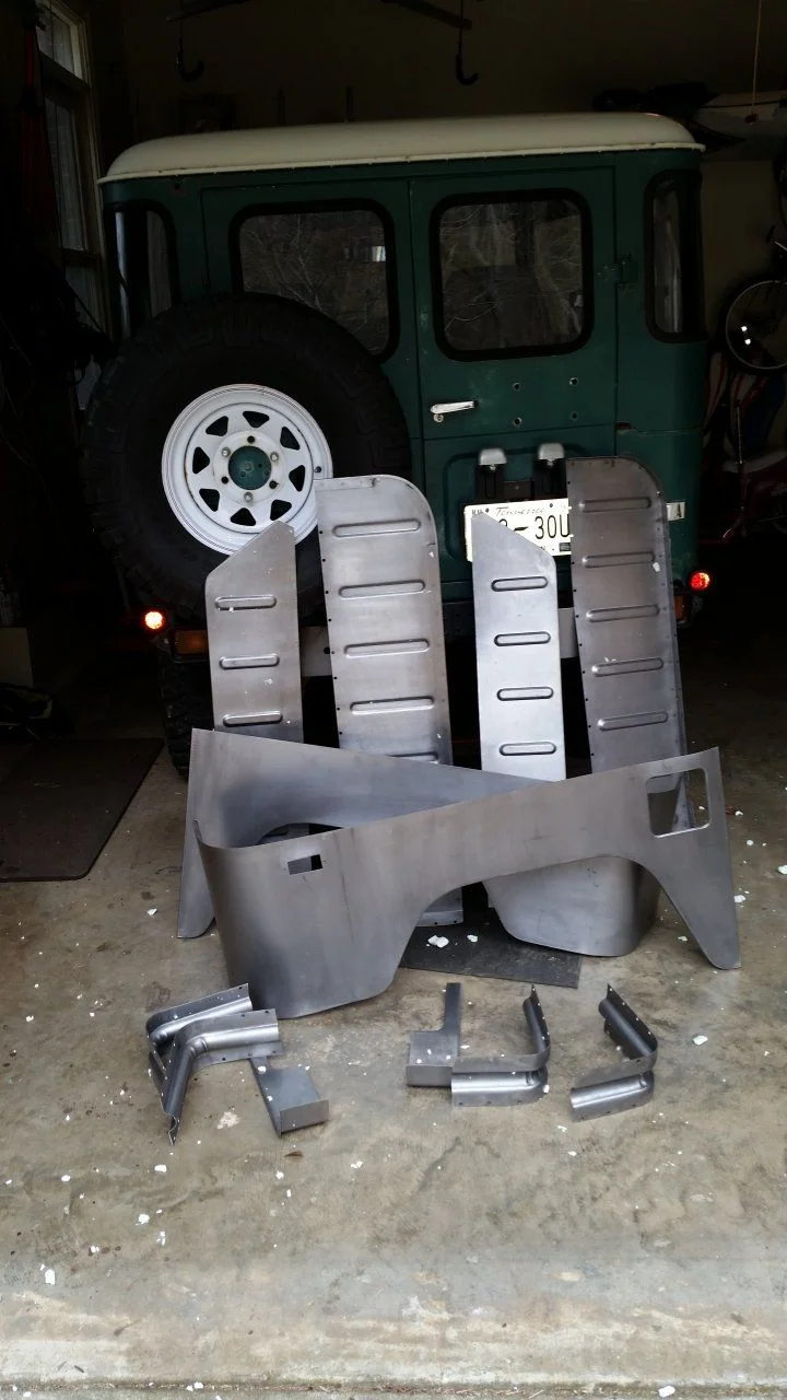

After extensive research, I found a local tech college that has a body shop. I hear they do great work and the kids are closely supervised. So the deal is I buy all the parts and they will install them at no cost. Their compensation is having a vehicle to work on. Im sure their quality of work would be better than mine!!
