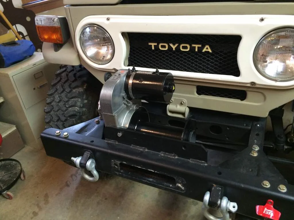

Warn finally sent the part I needed to finish up the 8274. I got the lower half buttoned up last night. Hopefully I'll have time to finish it up this weekend. While I was waiting on the part, a bud brought this by for me to tinker on. It's a '75 Kawasaki F7. It needed carb work. Runs like a champ now!

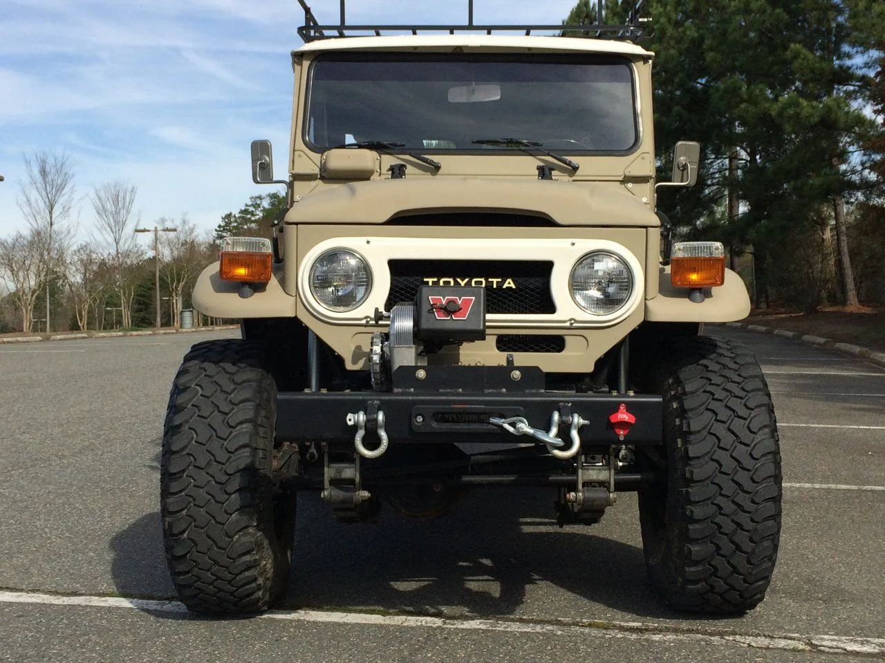

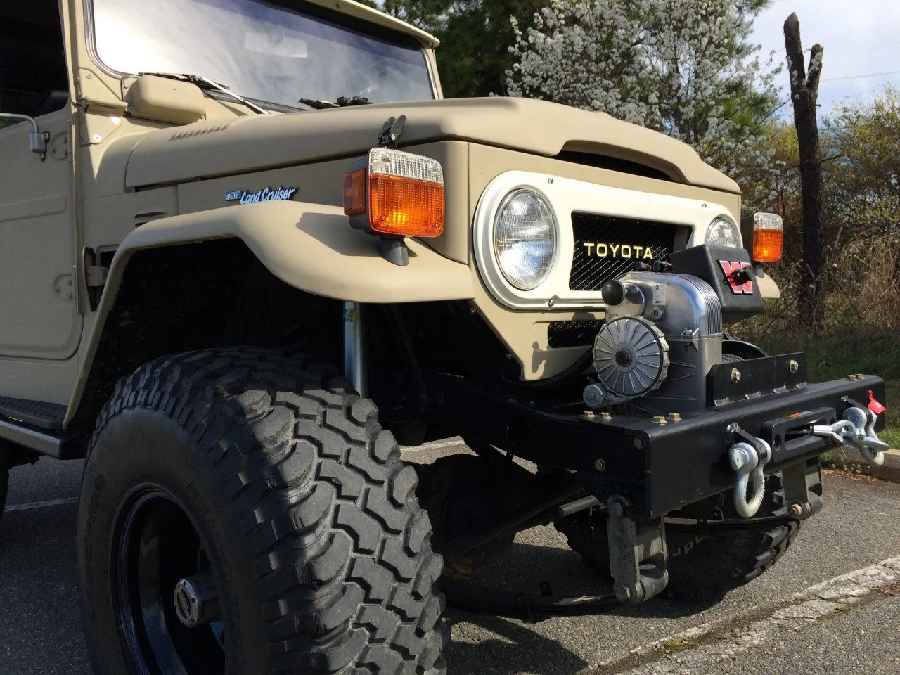

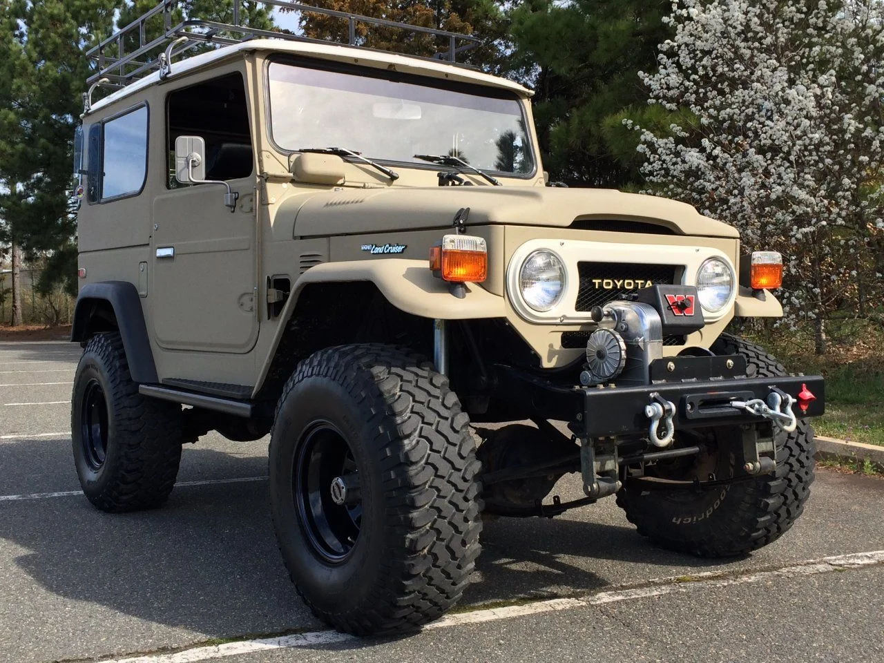

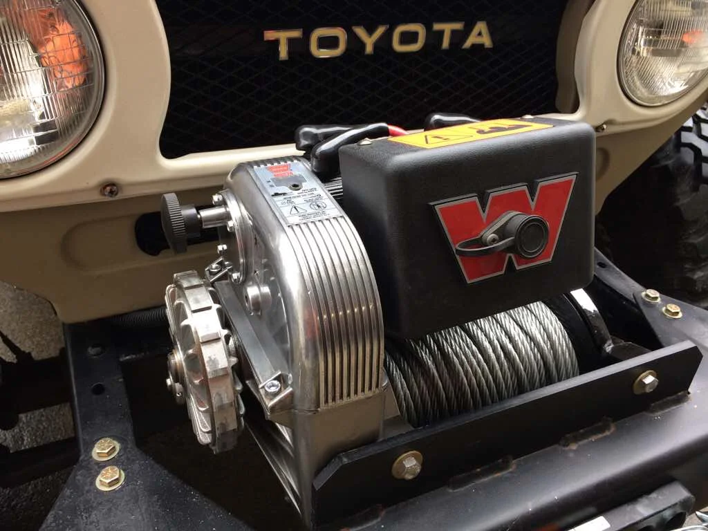

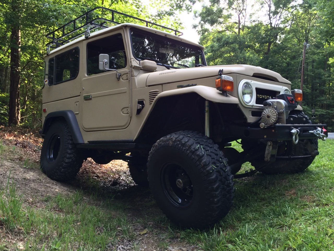

Winch is on and looking maahvelous, I must say! Works great too...

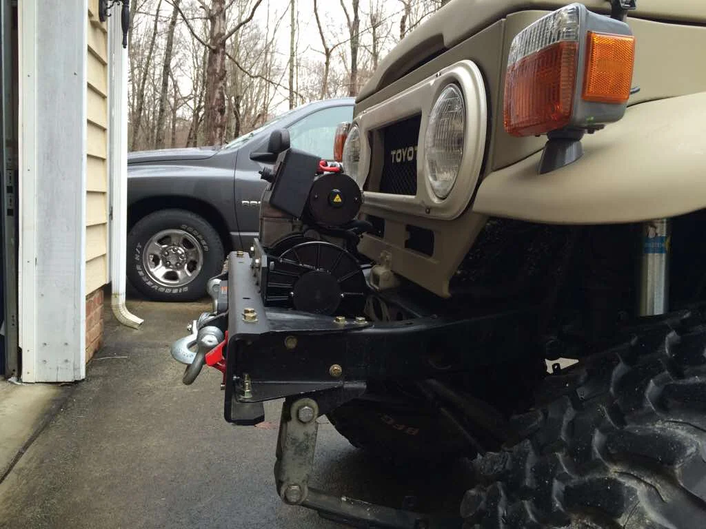

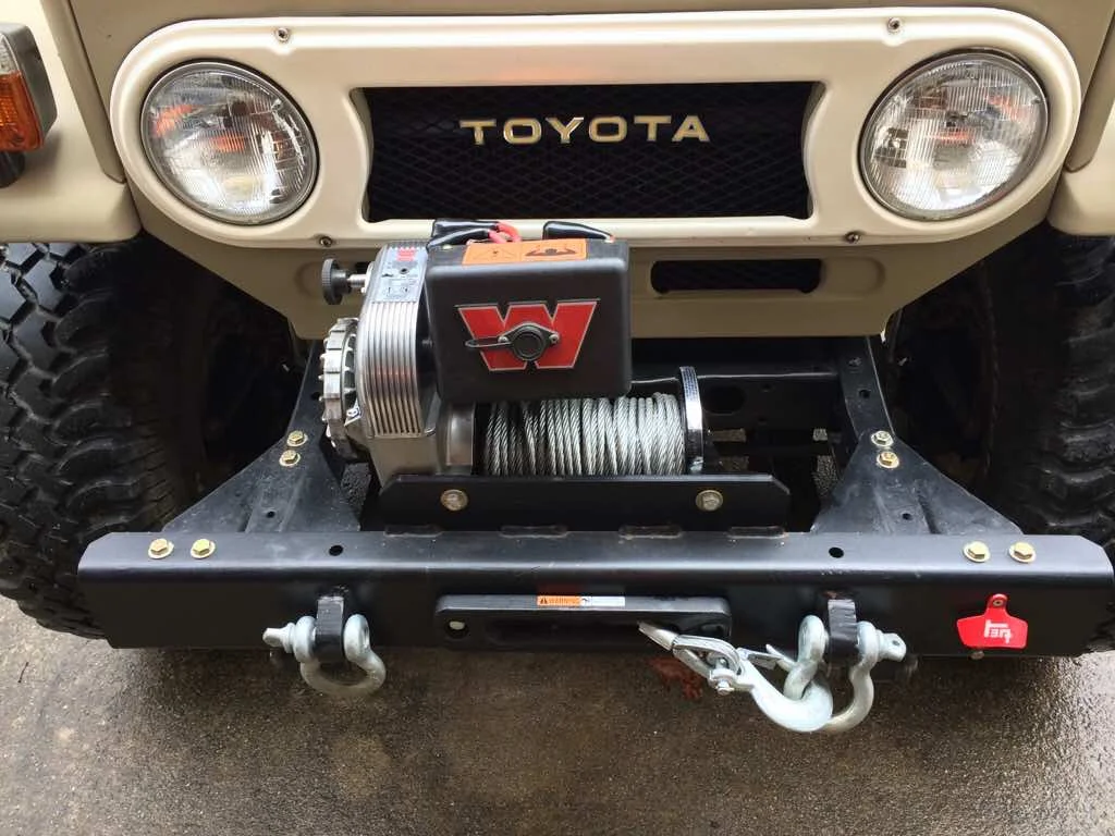

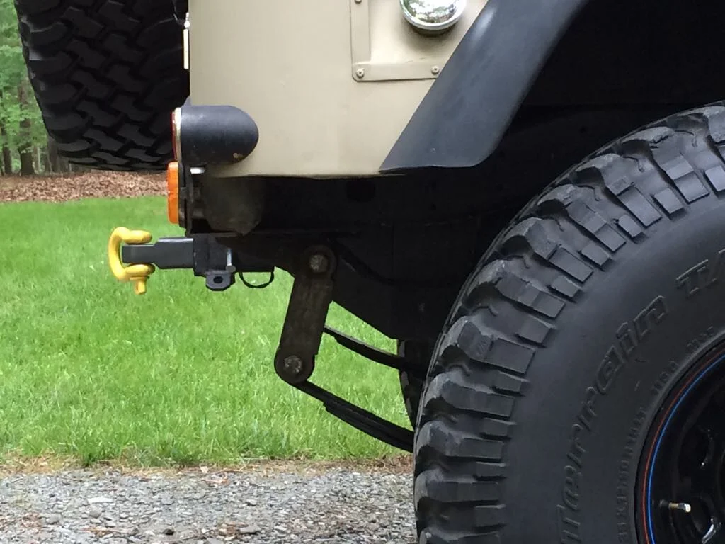

Any particular reason you went with wire rope and a hawse fairlead over synthetic?
Yes Johnny. $. I got the wire rope from Sam for a steal (thanks @elkaholic). When I ordered the bumper, I ordered it with the hawse with the intention of going synthetic. Shortly after that, Sam made me an offer on the wire rope that I couldn't refuse. It is a steel hawse, not aluminum, so it should work fine with wire rope. I'm sure it will be a little rougher on the cable than a roller would be but at the price I paid...who cares? If money had been no object, I would have gone to synthetic. I'm a big fan of synthetic and the external brake on the 8274 lends itself perfectly to its use. If I hit the lottery I'll change it out and swap to an aluminum hawse.

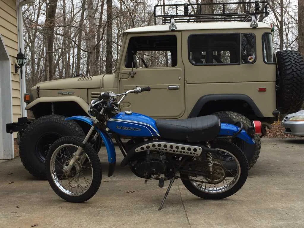

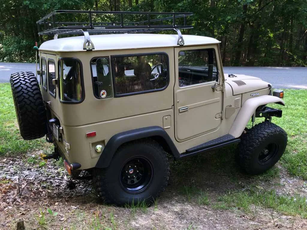

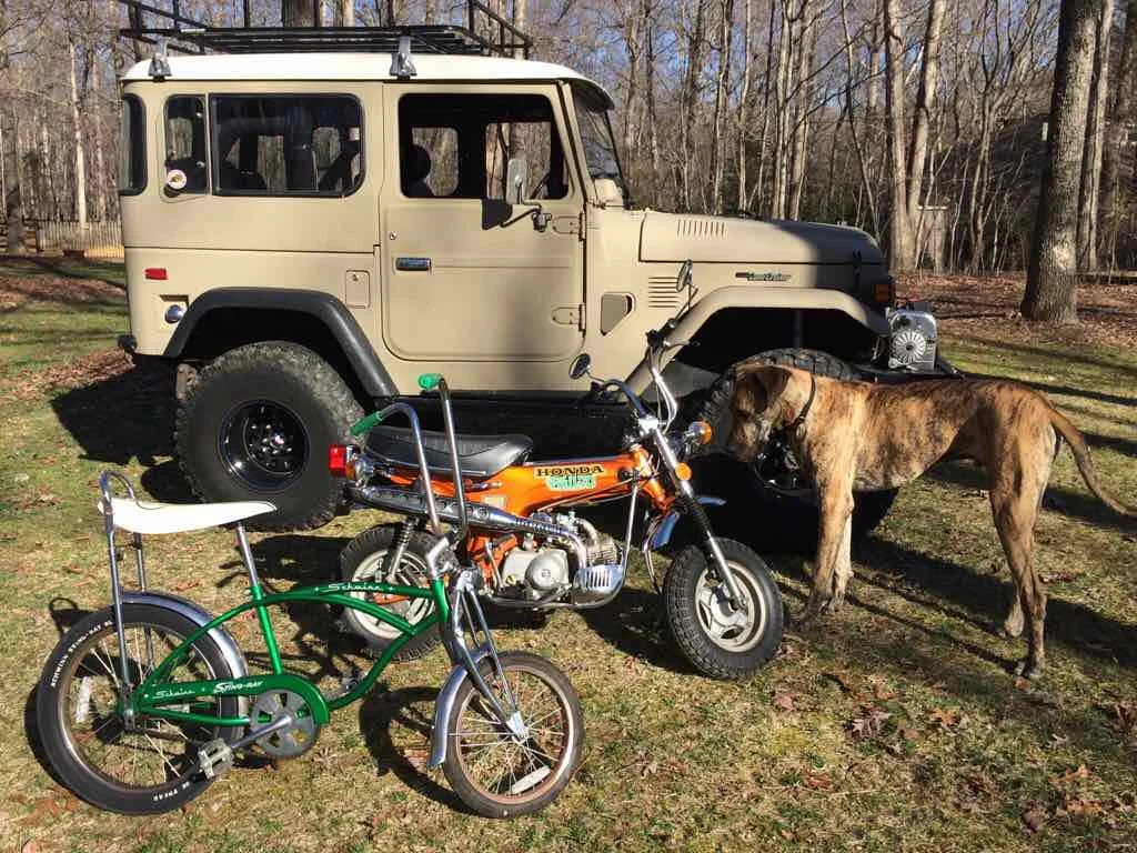

More shameless pic whoring...
The 40, my '73 Honda CT70, one of my Schwinn Krate repop bikes and my dog, Zeke.

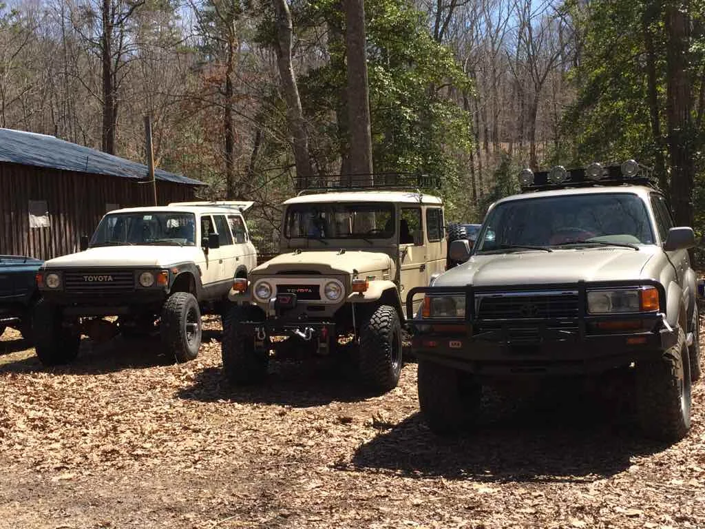

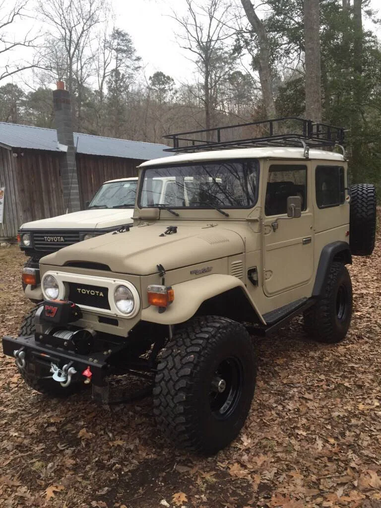

ONSC Meet and Greet. The CP in good company

Thanks for the props, CR! I've been dropping by your thread as well. Keep it up man!

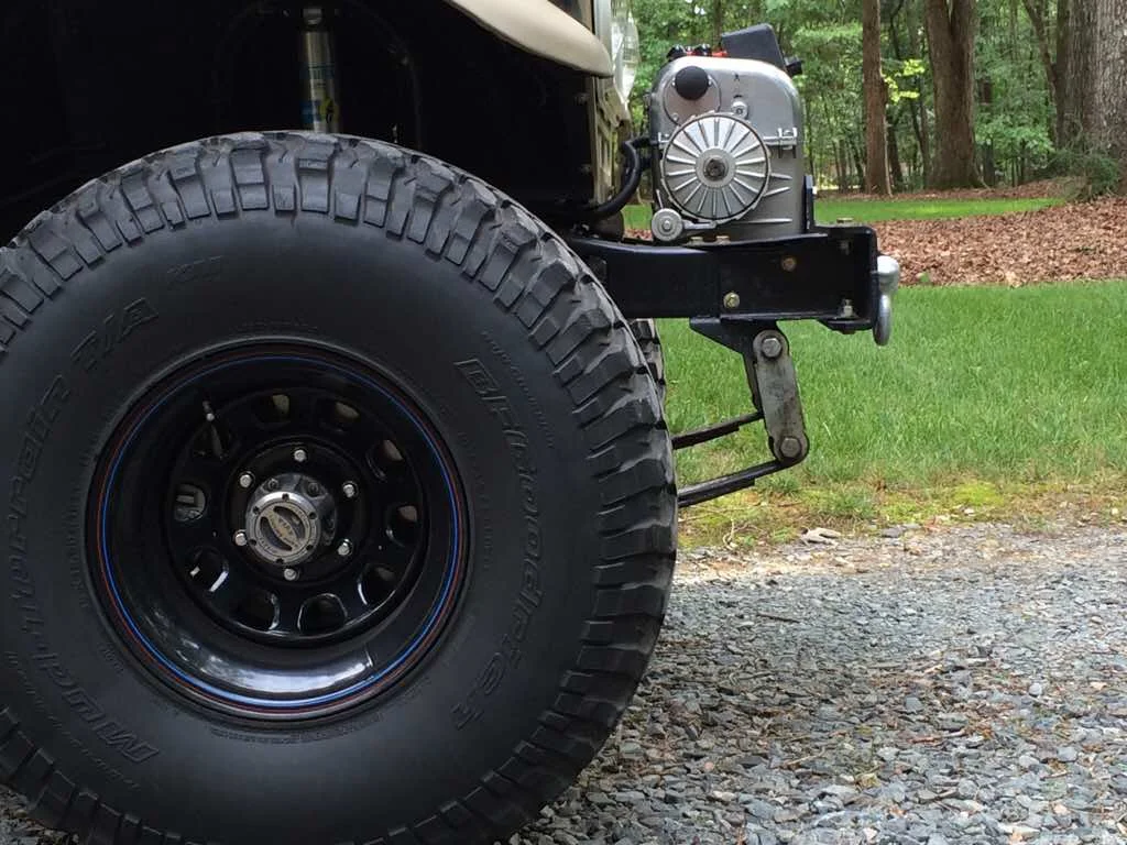

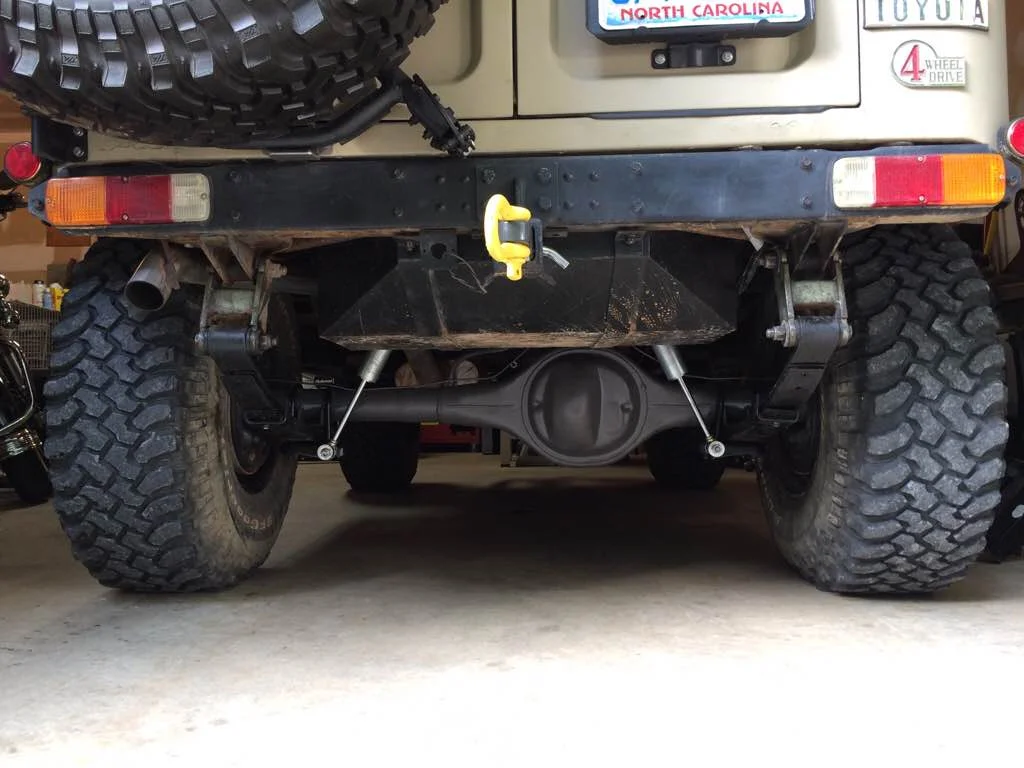

As I said in an earlier post, I have not been happy with the flexibility of the 4" lift springs under the CP. It's hard to move forward on the trail with one tire constantly up and hanging in the breeze. I would love to go SOA at some point but for now I am focusing on getting the spring under setup to flex a little more. This weekend I finished removing all four spring packs and yanked out one leaf from each pack. This has lowered the rig down about .75". The shackle angles have improved substantially. Ride feels about the same going in a straight line. I can feel a good bit more sway in the corners. I'll take the truck out to my neighborhood flex ditch and see how it does. Before with the stiffness of the springs, there was no need to extend the bump stops because the springs limited the flex to the point that rubbing wasn't much of an issue. I feel sure that now with the rig lowered a bit and with more flex in the springs, I will need to extend my bump stops down from the factory locations to keep tire/fender contact to a minimum. I'll post some poser flex pics as well as before/after shackle angle pics ASAP.

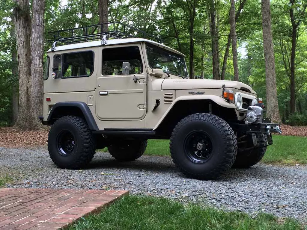

Sitting about 3/4" lower overall:

While I had everything apart to pull a leaf from each pack I took some time to tidy things up a bit underneath.

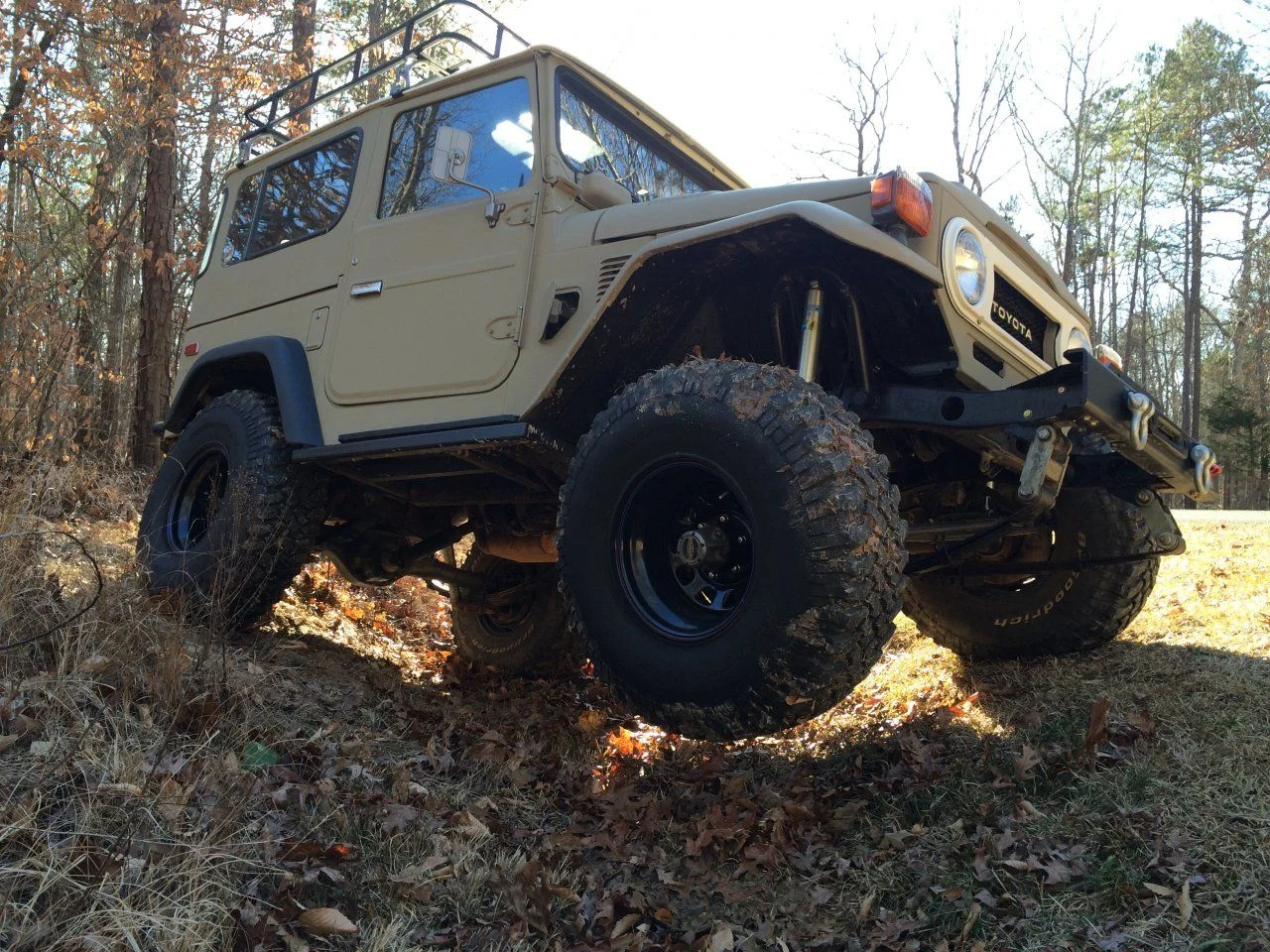

Here are the post leaf removal flex pics:

I believe the biggest difference in the overall flexibility of the suspension is due to the rear packs being less stiff. I could not lift a tire with this new setup.
