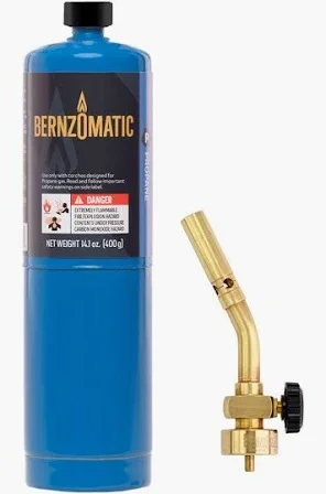

I got a flare nut wrench, but still no luck removing the hydraulic line from the master, or the hose from the slave. I don't have the kind of heat that is probably necessary to apply to get these off. I'm considering purchasing a new hard line from @cruisermatt and taking off the master with the hard line still in it, and the slave with the hose still attached. Is this possible? Would I have to cut the hard line in a couple of places? And when installing the new line, how hard of a job will it be to install the new hard line? Anything that will probably have to come off?
You just need one of these guys. Or better yet the yellow map gas version.

Actually if you are going to purchase a new soft line, just cut the one you have if you want to get this out and onto your workbench.
^the above suggestions, but Kroil is your friend. One of the best, if not the best penetrant. Apply it, and give it a day or two.
If you’re replacing the line, then no reason to remove the original intact.
I agree with Matt’s statement above… the line is heading to the scrap heap.
That said heat, penetrating oil, ice, and repeat. Just in case you want to practice or for the next part.
