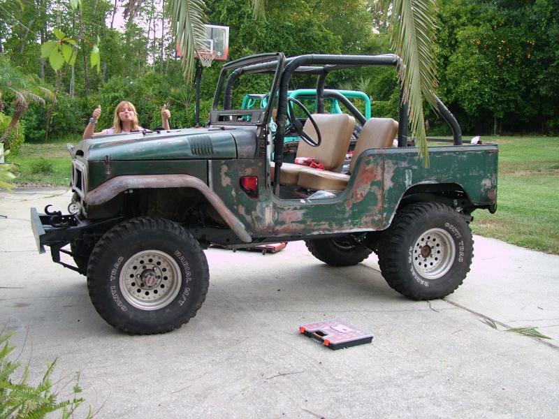

Well I had picked up a warn 8274 a few months ago for $200 clams, came with a mounting plate to mount it to a non 8274 winch plate. After much debate, I decided to use it, cut the top of the bumper off it is a big heavy piece of channel steel. I used the mounting plate that came with it to weld into the bumper. Not sure if I am going to pain the solenoid cover the same green as the fj40 will be, or black. Still need to refurbish the winch, it works just need blasting and some paint.
While this is not road worthy yet, it has been over 30 years since I bought my first car/fj40, and many many 4x4's since, I now actually have one with a real winch on the front. My hi school dreams are coming true just 30 years late.
Still working on the body work on the tub, will be getting up to the front soon, that is why I needed this winch mount done so I can clean and paint the bumper and front part of the frame.
