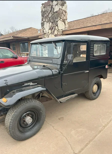

Two hours ago, I didn't even know what an FJ40 was. Now I own one. Bought it for almost nothing. I haven't looked at this in person, but my brother in law did and said it looks fine and runs. The interior needs some love'n.
So...I am going to spend this weekend reading up on the FJ40 - I won't have it for a week. But what is the consensus on these to get them fixed up? Is the goal to keep everything stock as it was as new, or are there a lot of popular modifications that everyone seems to like? I certainly don't want to bastardize a good vehicle, but I'd like to get this to a shop and have it treated properly and brought to snuff.
Thanks in advance everyone!
One thing I have quicly noticed is, BLACK isn't a color option for this car when new. So...if the paint is good, do I hold my nose and live with it, or should a proper color be a part of the resto project? Thoughts?

Something odd going on with the front hood. It doesn’t look right, maybe it’s an aftermarket fiberglass replacement.
All depends what you want out of it. If you want to go more purist look over in the 25 section. Since that is an early cruiser it’s going to have some different parts than most the 40s. Blinker are incorrect and stock ones are easily available and just look correct even if not going pure it will still look way better than trailer light bolted to the fender. From that one picture, the rear hatch door has been modified. Should only have glass in the top section of door, the mirror head is incorrect but who cares and the seats look to be replaced. If the doors are correct to the year then the door handles are a very hard and rare piece to find. Rear hub cap is correct for the year. Would love to see more pictures and see what’s under the hood. But looks like a decent rig. The hood looks like it’s been skim coated as it should have a seam straight down the middle with a chrome spear at the front. 62 is a early cruiser so when searching for parts if going to stay original it’s a bit more of a challenge but I love early cruisers. Here’s the key thing. It’s yours so enjoy it the way you want and take what everyone else thinks for what it is. My only 2cents would be if your just looking for something to beat up as a wheeler and don’t really care if it’s a landcruiser please don’t beat the s*** out of that one, atleast not from that one picture as it looks really decent. Welcome and enjoy

Yeah, I can’t imagine any full restoration on one of these (even with your low starting price and especially with the labor being outsourced) would ever be a wise financial decision. If it were me, i’d try and make it safe/reliable/driveable, then work on cosmetics. Cosmetics for me would be getting parts back to original (turn signals, seats, etc.) and seeing if that overspray could be removed (getting it back to the original paint, whatever that condition may be). Old, original patina rigs look the best, command the most respect, and seem to hold their own in the marketplace. That looks like it could be a great, rewarding project.
These old 40s deserve respect! Go original era correct or go home! Modify something that’s more available and already hacked up. So called up grades like the awful black hurts the value bad, so seek reliable info from people who know from experience. The vin will tell you a lot of info, are #s matching? More pictures please! What a score for you, if you are not in love with it, please find her a good home!

Its hard to determine its value with just 1 pic. I would guess 2 grand is a smok'n deal. Its value is considerably more than what you paid. Its condition will likely dictate the direction in how to build it. You can make it a solid safe driver with more contemporary driveline parts or build it back to a stk 40. Older 40's are not as refined and are a little more antiquated. It all depends what's missing and whats not. Its easy to break even or be upside down with a restoration to original condition and have a few years in it, if your not careful.
