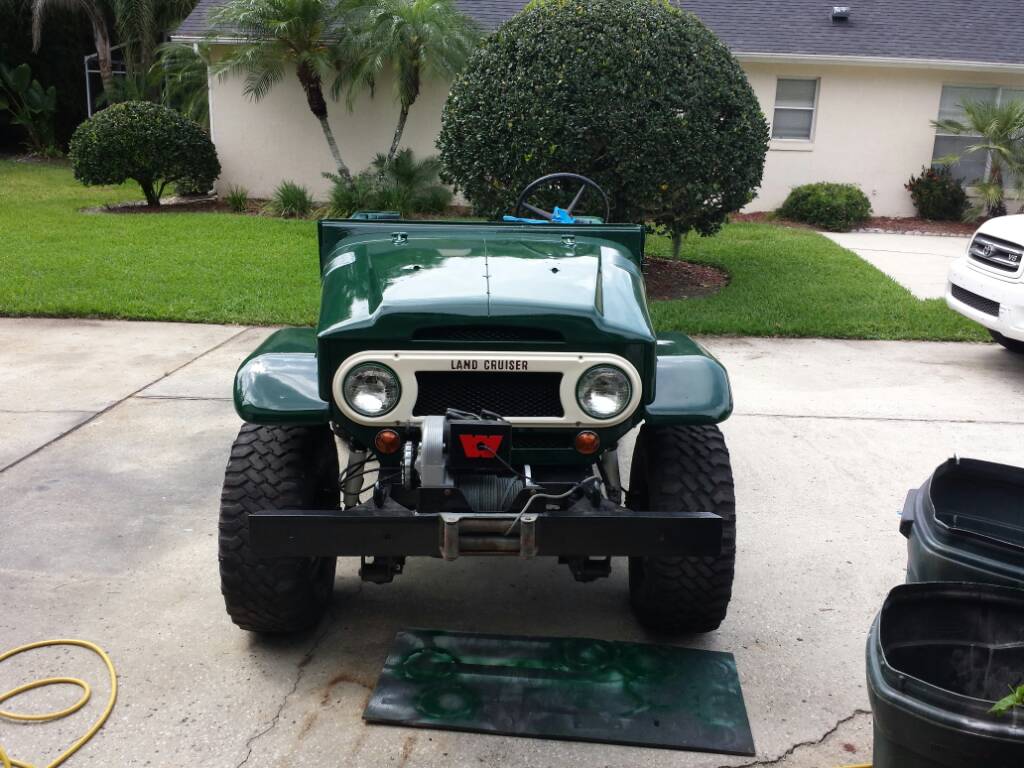

The color is green! I have no clue what real color, I took the kick plate and really polished and buffed the inside to get as clean and shiny section as I could then went to the Nason paint dealer. He looked at it grabbed a book of greens opened it to a page and picked one in one action. There must have had thousand shades of green and after 15 minutes I could not find a close match then then one he picked. While more shiny, it is as close to the original color as I could get. There are no color codes from 61/62 that I could find.

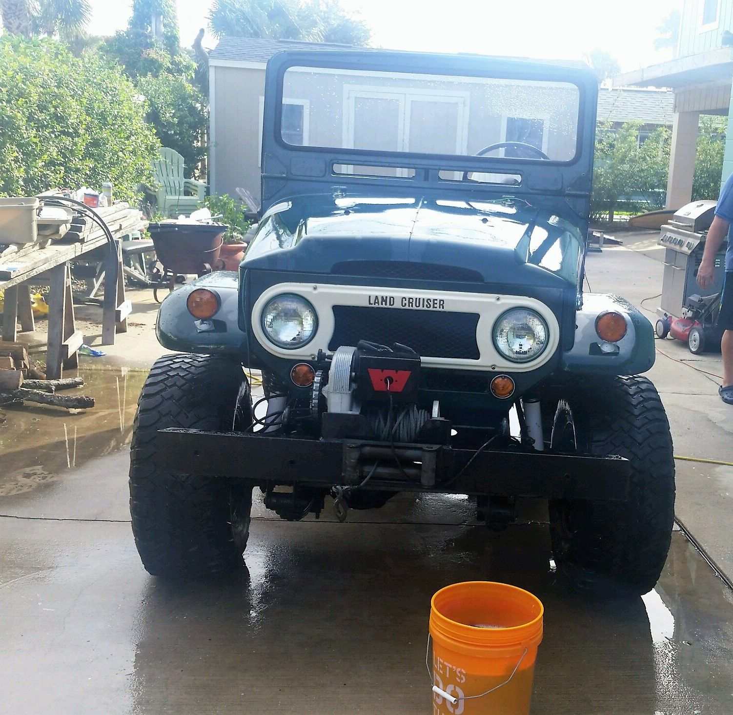

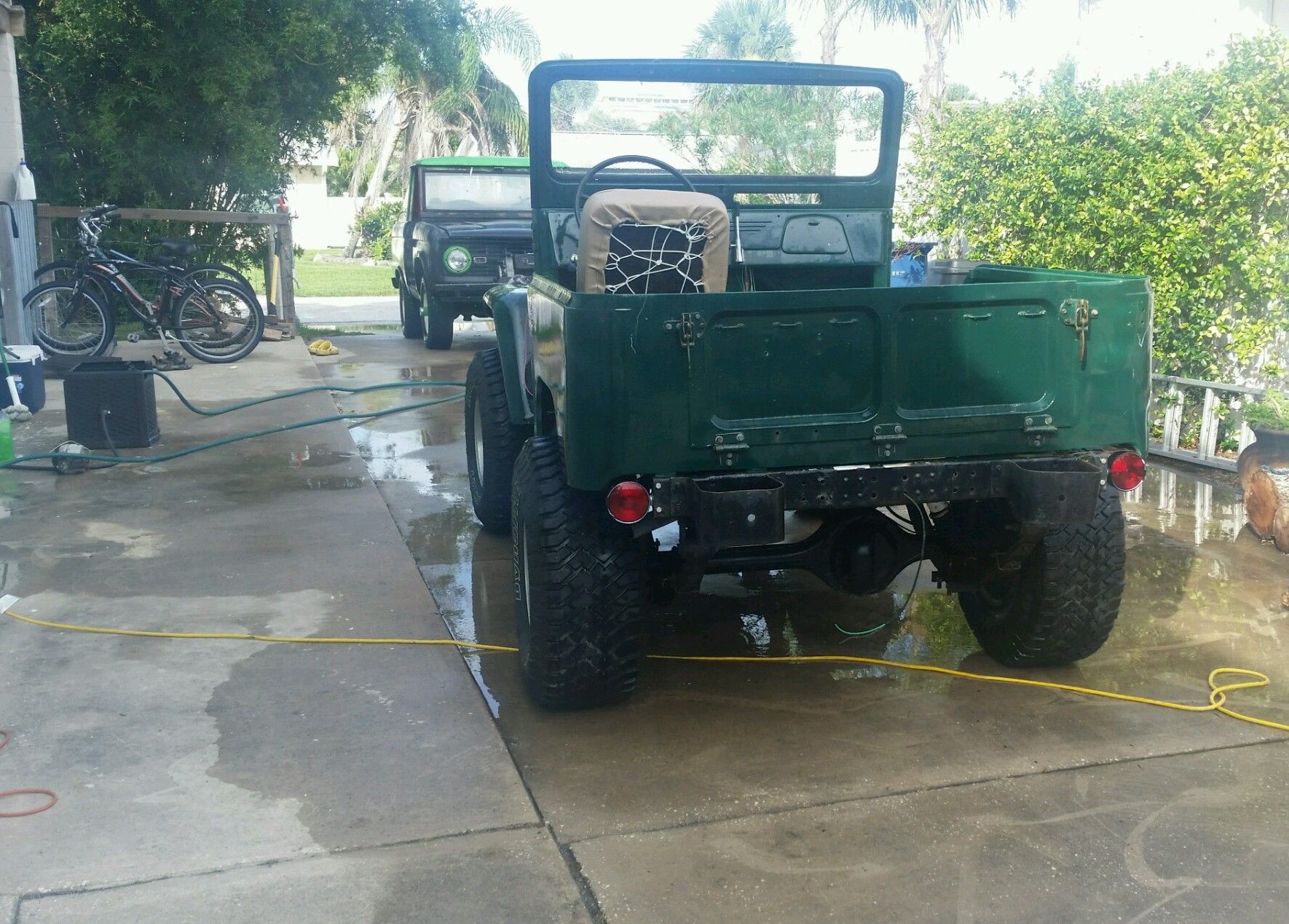

My son and I put in the EZ Wiring harness, went pretty smoothly so far. We have everything working including the gauge cluster except the charge idiot light, not sure how to wire it yet with this harness and internally regulated alternator. Still have to work on the windshield wipers and horn, everything else was simple. We used all terminals with the heat shrink that also glues itself to the wire, we have put all wires inside heat shrink wrap. We also installed the new windshield, $70 to have it cut at a glass shop. We picked up some round lights for $7 bucks just so we would have rear lights. Looks good, will eventually get real ones with the stock brackets. But this will do for now.

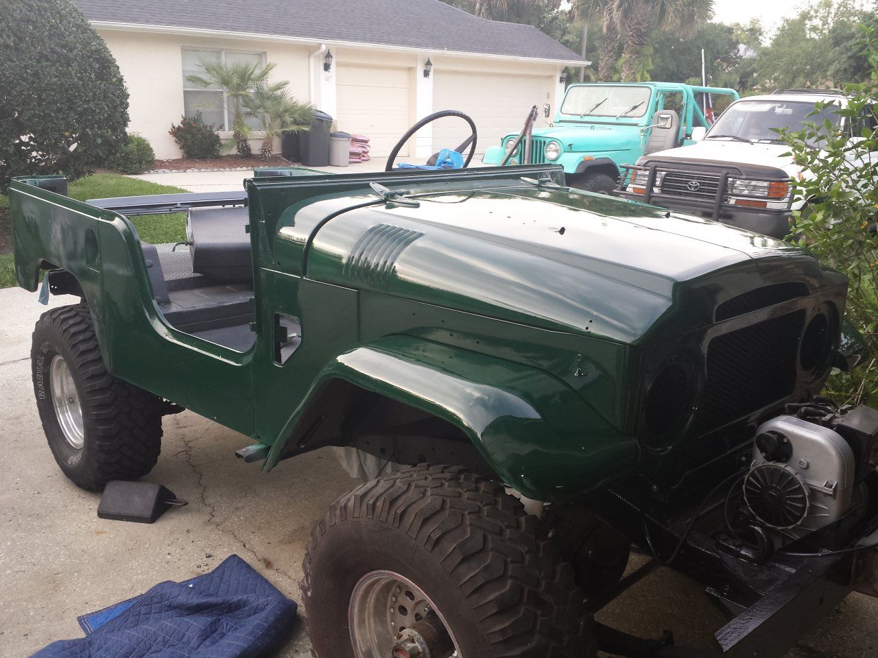

Finally got to painting it, turned out 50/50 very happy with front half, not so much with back. Planning another few coats post assembly, might have to and and do a little more body work on the tub, not that it is shiny small issues much more visible. Other then parts of the floor and rear sill, this is 100% original steel, spent a lot of time on the hood and fenders, clearly not as much on the body.
