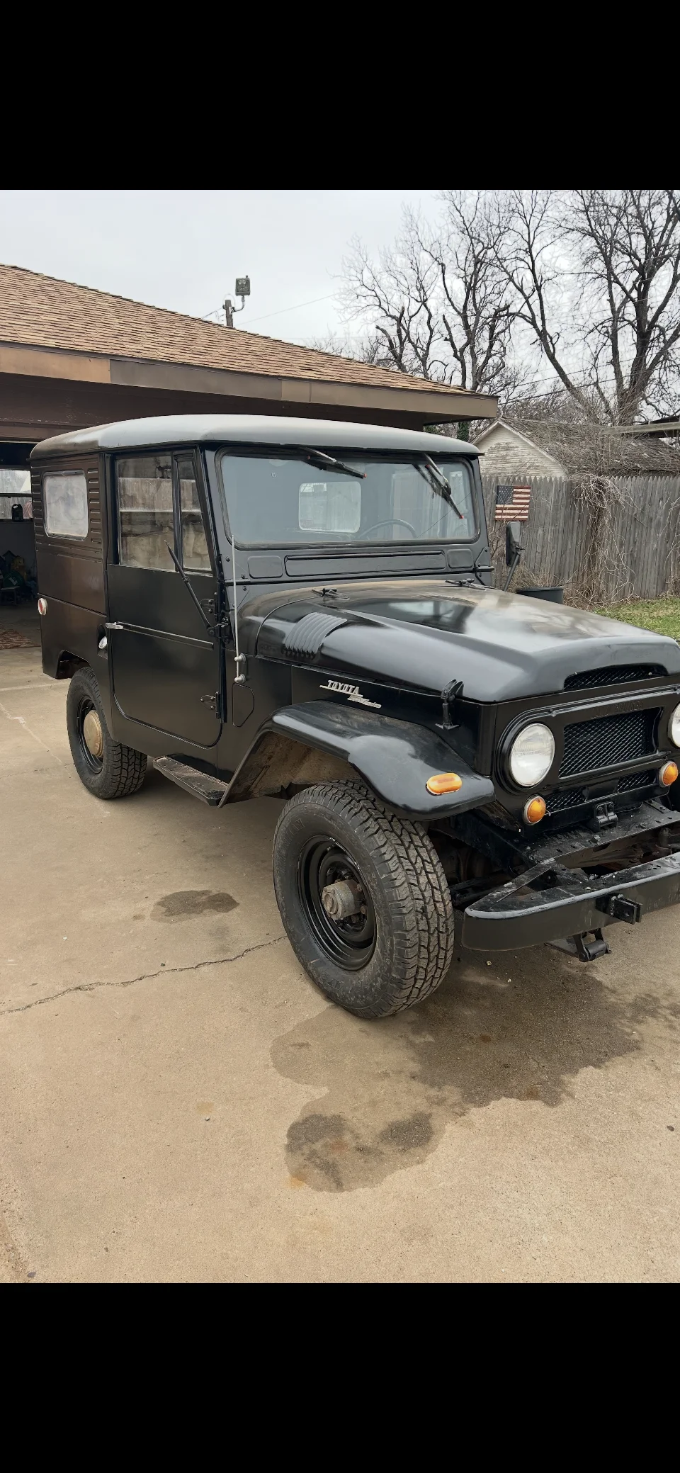

Beware of bondo filler and cancer hiding under that new paint.
I took another glance. The black paint and aftermarket turn signals threw me off. I would return this one to stock. It looks too good to modify. Is there any filler under that paint?

if you want full restoration to original condition to me there is only 3 shops out there I would even consider and your talking 150k and 5 years. Early cruisers are there own animal, the knowledge of them is hard to find and all the parts are hard to track down if you want it oem original. If you just wanted it restored to look original with some nice “modern”upgrades that list of shops goes up a few as parts are interchangeable and easier to get. I’m 60k into one of my rigs and if I could get 30 out I would walk away today. If you want the best bang for your buck you may consider just flipping it. Make a profit off it and do nothing to it but walking away before you start down the rabbit hole. On the early cruisers they look very close to the later cruisers at a glance but it’s all in the details. And what yours has and is missing. Does your bezel have the correct Land Cruiser imprinted wording in it or has someone swapped that out? If it has it and it’s in good clean shape that stupid piece of metal around your headlights is half of what you paid for the truck.

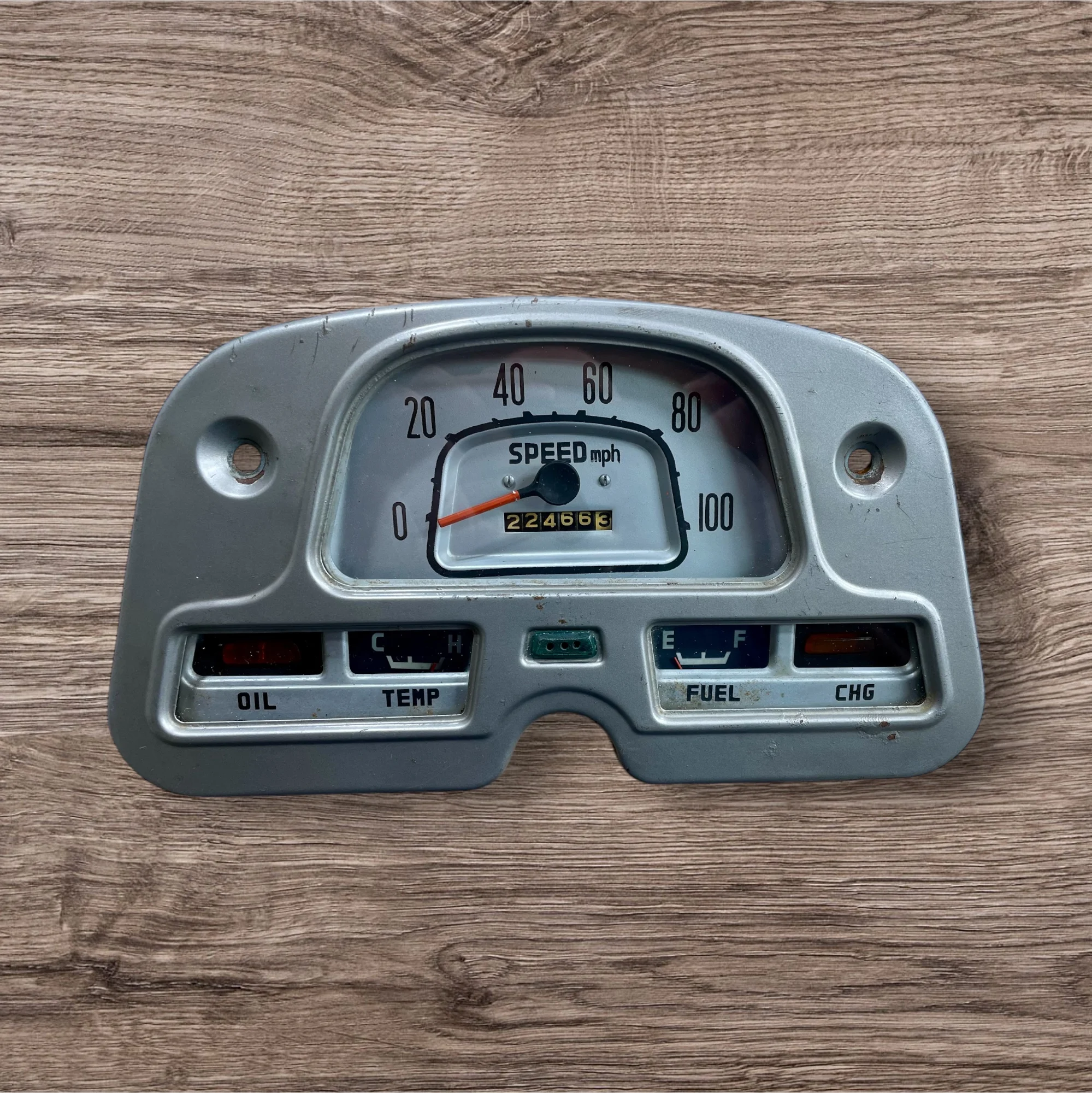

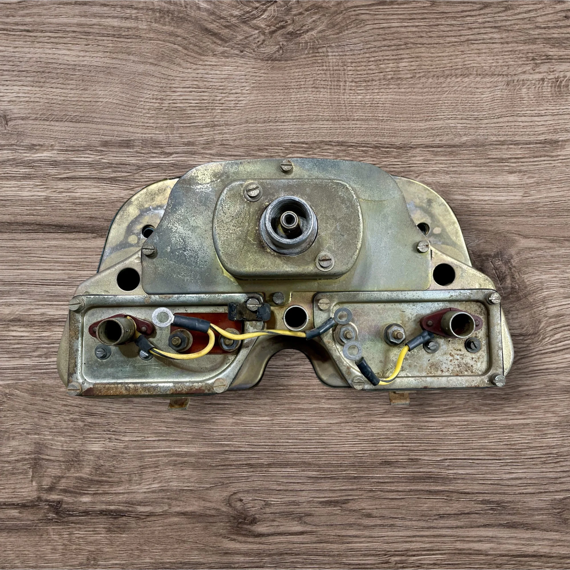

I have a silver screen cluster from 1962 if you are interested for your new 40

Its been repainted, so there's no telling what was done to it. It looks good and pretty straight. You can see the original color. Stk Toyota fenders are available but not inexpensive. Typically the rear 1/4's and the rear sill can be problem areas. When you get, we need more pics inside and out.

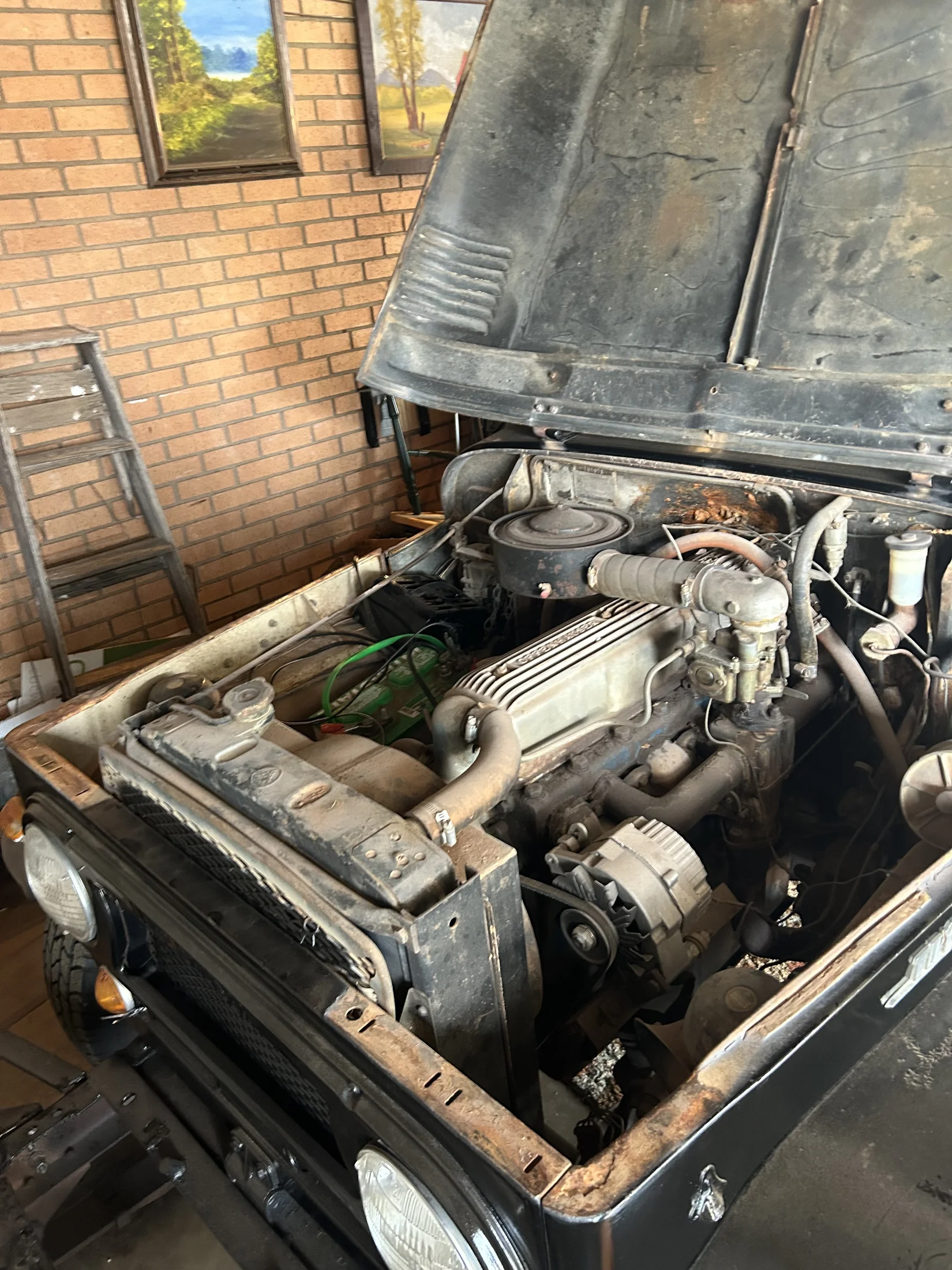

Cool! where are you seeing the original color?

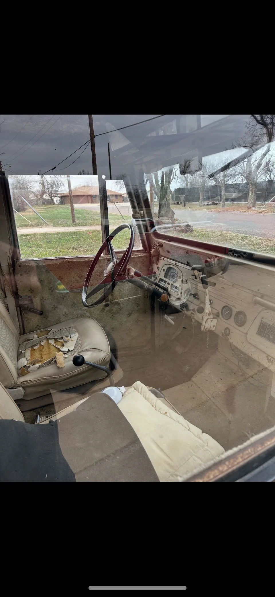

The inner fender apron on the passenger side, if it hasn't been replaced. The engine pic. When you get you'll be able to look under the dash.
Or at the dash
Has some original things and is missing some. The stamped bezel and early grille mesh without Toyota are original, horns. Wiper motors are correct
Lots going on under the hood that not original but has kept it alive so that’s a plus. See if the engine matches the plate number. Back passenger side bottom of the block will have the engine number, tag on the firewall will have the original number that was put in it. The offenhauser valve cover isn’t original but it’s been on there a long time.
It appears to be a 2 piece hood, but they filled the seam. Theres probably more bondo under that paint. Hopefully the repaired the metal 1st.
