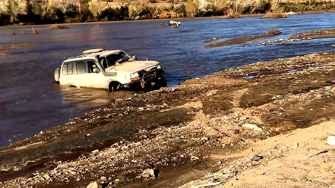

As to the cause of the engine failure, I’m thinking silt in the crank bearings.

And this chapter of my life has officially now ended.
hell of a build thread! Bravo! I seriously got so sad seeing this last picture...…… That took up 2 hours of this quarantine time. Your story is going to make really think hard about any deep water crossings in the future.

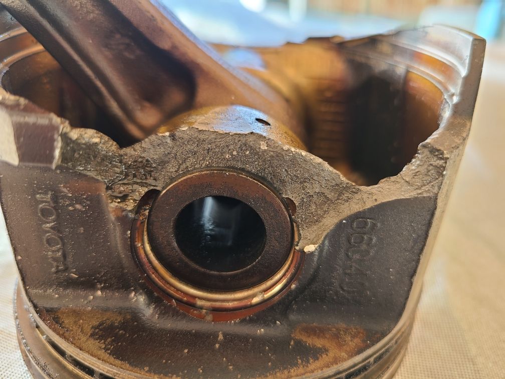

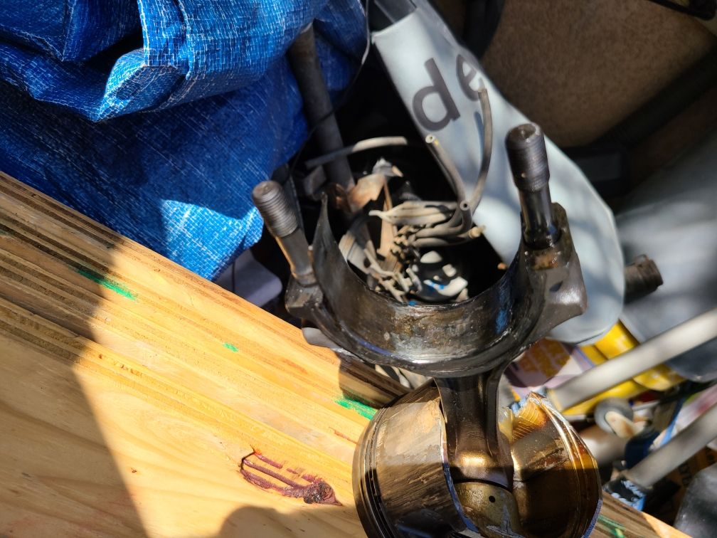

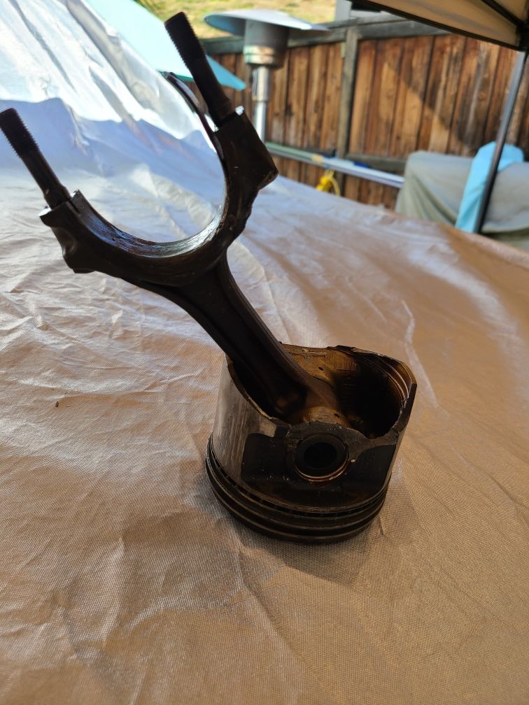

Received some pictures from the new owner. Rods seized on pistons 1 and 6. Chunk busted out is #1. My guess is oil starvation.
Can you guess what brand oil filter got used when we did the emergency oil flush and change after her swim?
Wix
Had to be the stinking silt in the water, had to be.
Ultimately at this point it doesn’t matter. There’s no blame to be made. It’s more of just analyzing why so that it doesn’t happen again in the future. But since only 1 and 6 have issues and all others look great and the cams were spotless a would lean towards being oil starved instead of silt.

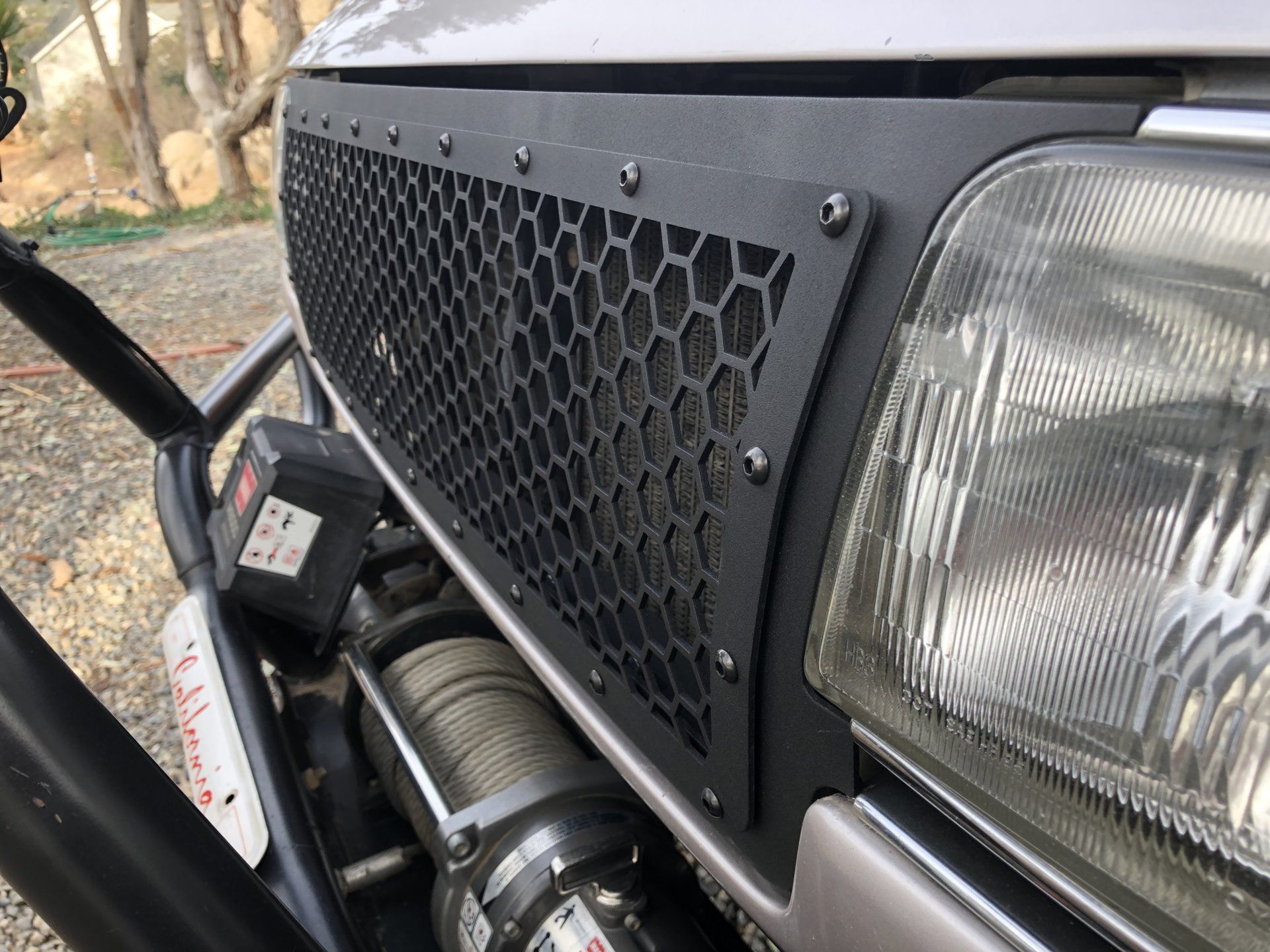

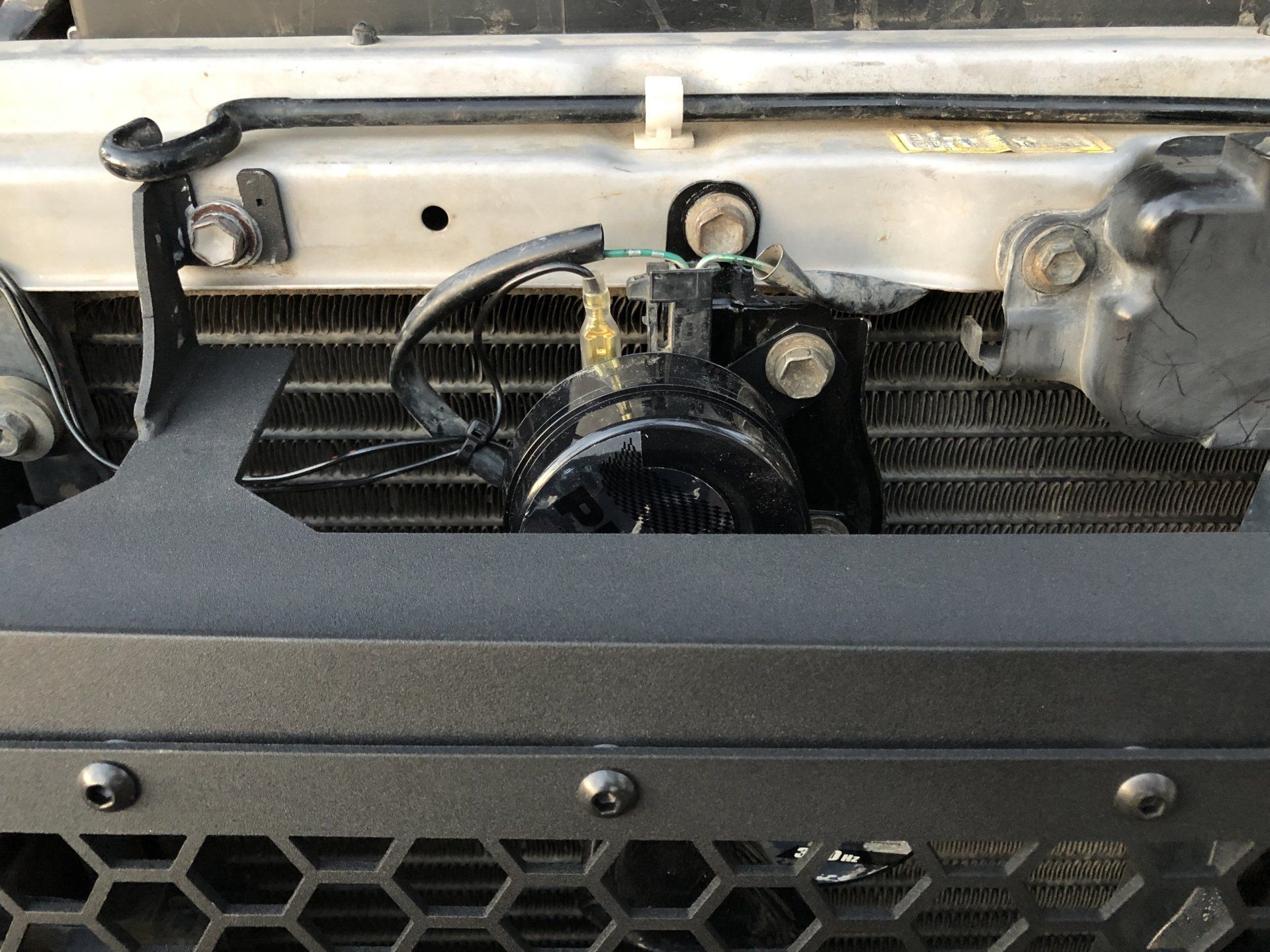

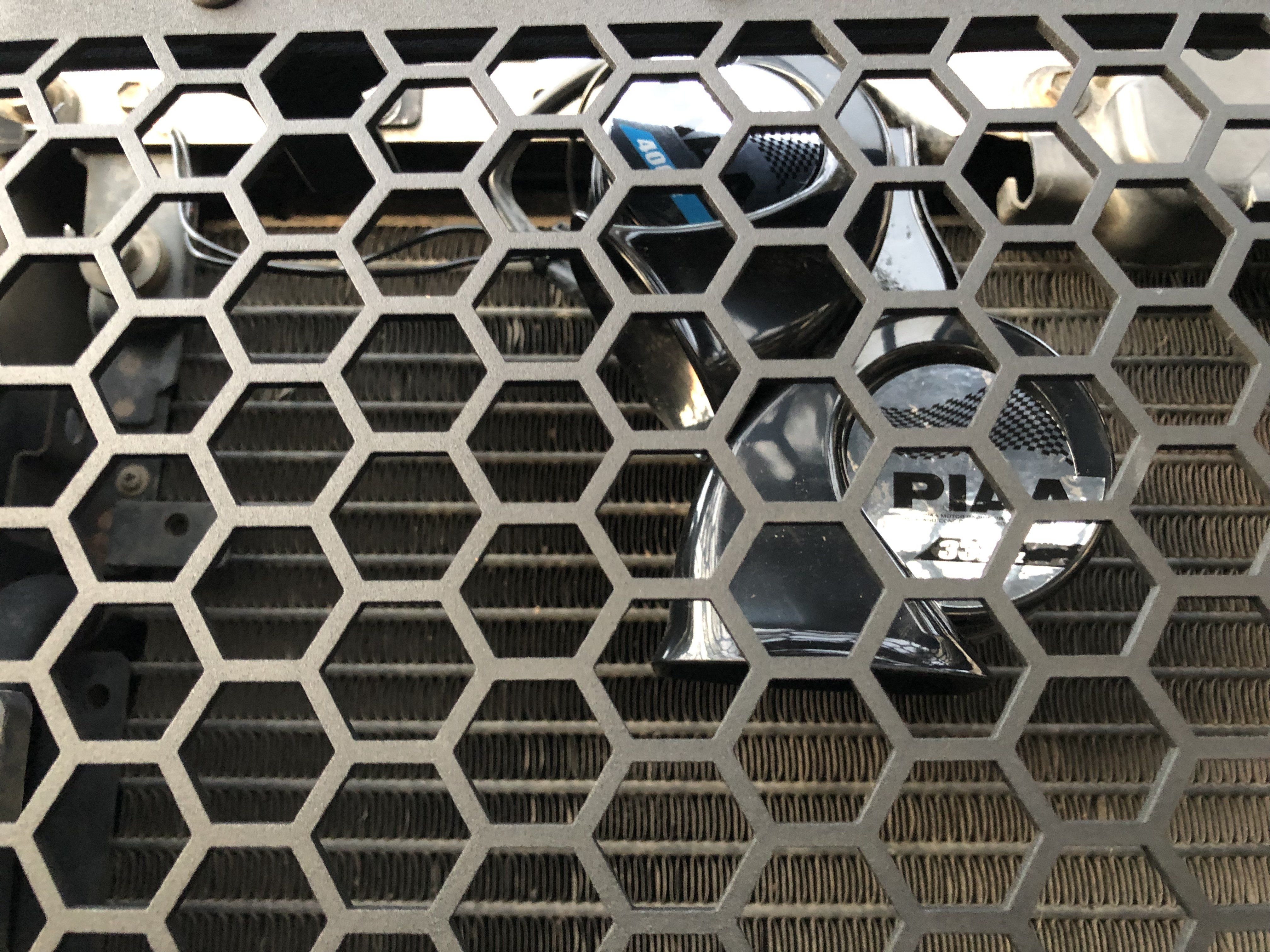

@kelly saad personally delivered this wonderful piece of art to me out in the middle of the desert. Waited till I got home for the install which was a non issue. Fits like a glove. I also replaced the factory horns with a set of PIAA Superior Bass Horns. Muy bueno!
Where did you get the grill? was it customer or did you purchase it somewhere?
